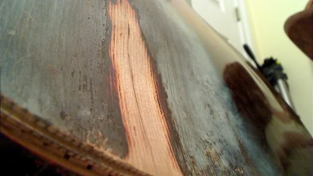

I will post a picture of the back and then we will see how you feel about " buffing it out " lol The bright side is you can see all the layers of dye and finish , so as it will be easier to recreate .

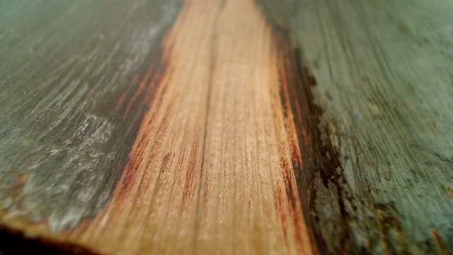

It has been sucking up moisture for a week now and already the top has taken back it's form , it has now become obvious that it was extremely dry. I am not rushing anything , it will sit for a few more weeks at least.
I wanted to post and keep everyone updated and show this picture. On the side where your arm would lay on the bass side lower bout of the side , the finish was just flaking away . So I picked at it a bit with my finger nail to check out the maple . I can't tell if the finish was dyed lacquor or paint with lacquor on top. The wood is dyed , obviously . The way it chipped up though it looks like dyed lacquor on top of the dyed wood . It is gorgeous old growth birds eye maple . It amazes me the old builders covered up the natural wood , today this guitar new would be a months wages at least , if you could even source wood this fine . It is making me rethink doing burst finish when it is refinished and go with a more transparent finish . I'm pretty sure I want a burst on the top but the back sides and neck I am not so sure yet . Anyway here is the picture of the old growth birds eye maple :-)

all structure issues have been addressed , here is the top crack repair. i used a steam iron and hide glue no cleat. it is tight and sealed now. i looked for cracks using a flashlight. no light shines through after the repair . i will now seperate the neck from the body and treat them as seperate projects until they are joined again in the future.

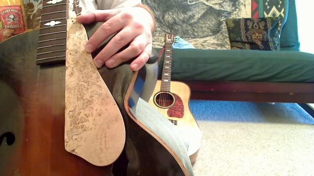

here is the shaped pickguard , it now needs to be bound , filled , and finished . i see some places charging over $200 for plastic . like i said I don't like plastic on acoustics! this is going to look boss d.j. , when it's done! now off to the goodwill to buy a cheap esspresso machine .. hope folks are still following along i will need help undoubtedly at some point ! :-)
