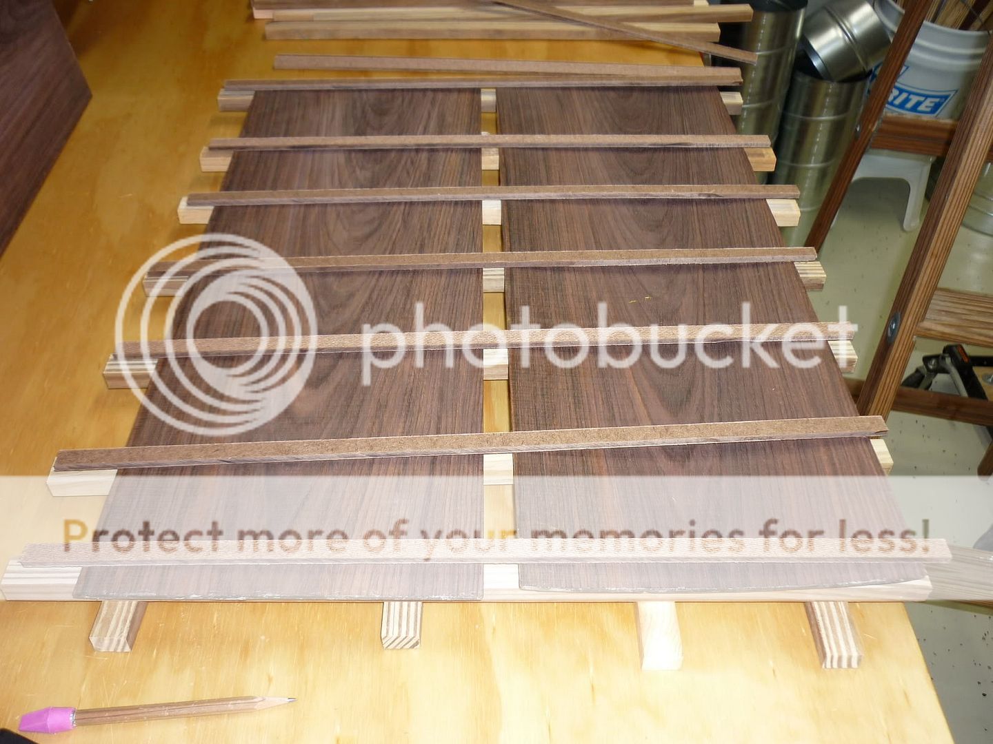

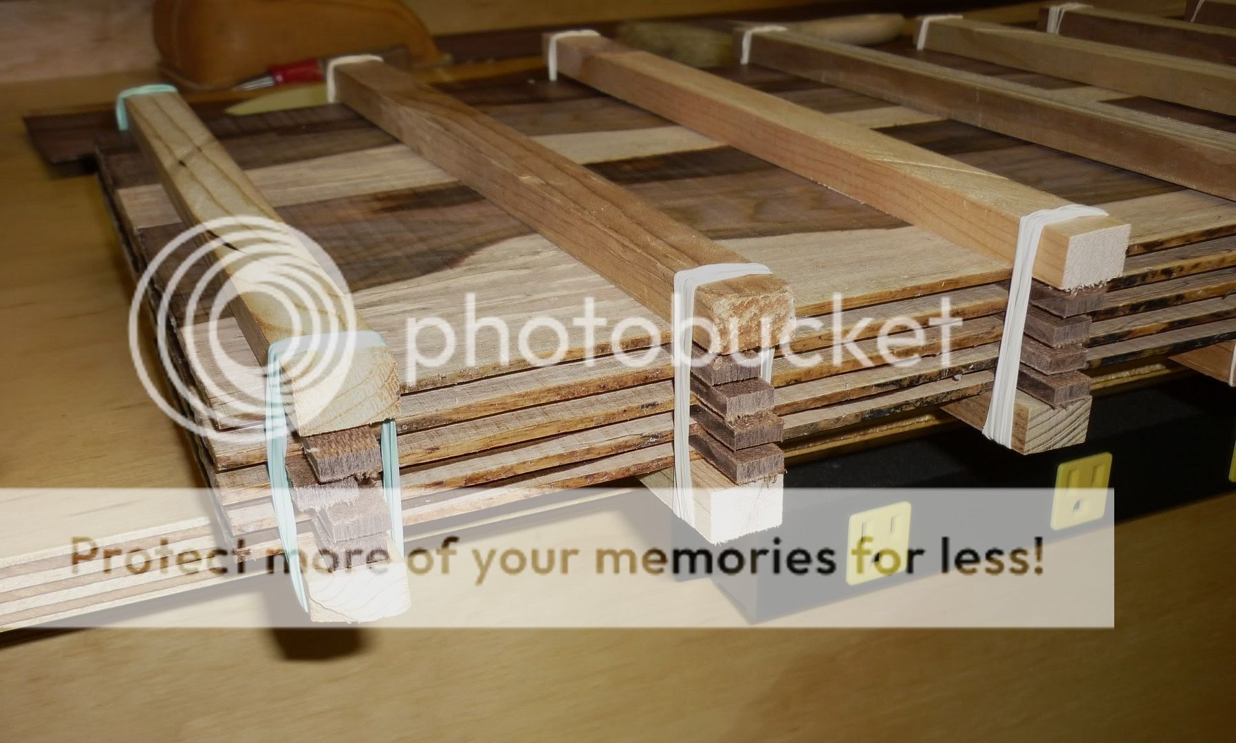

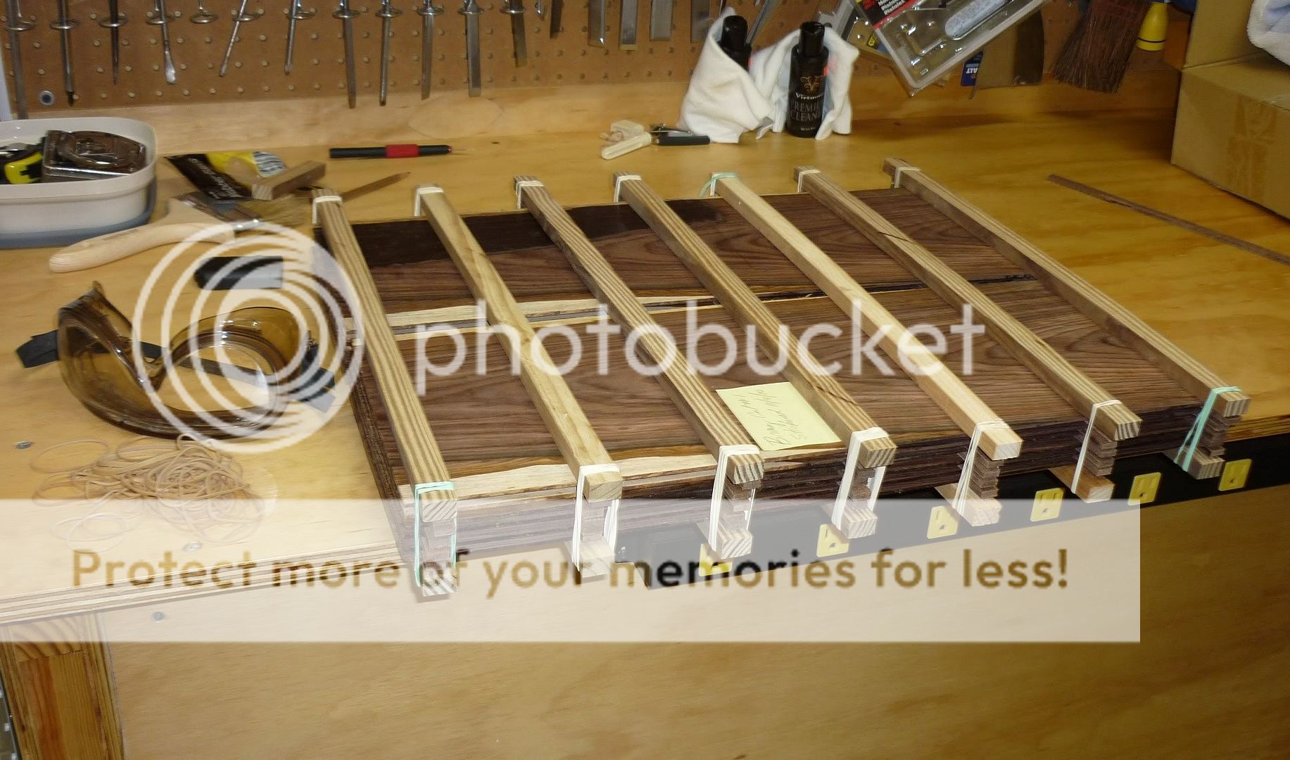

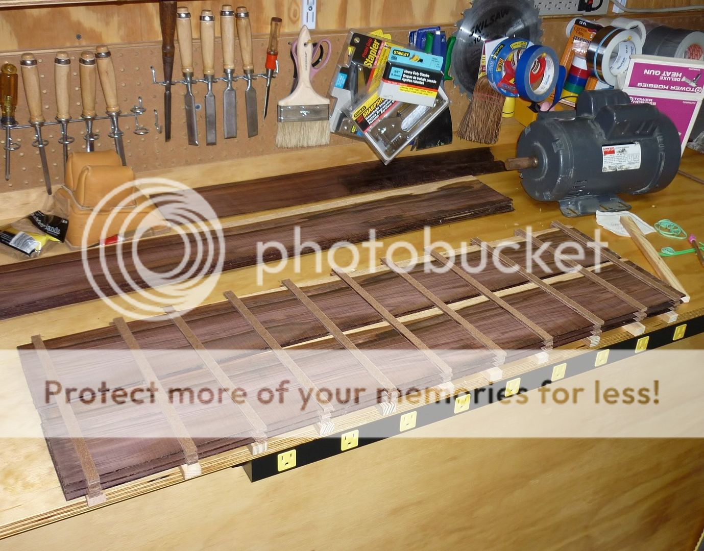

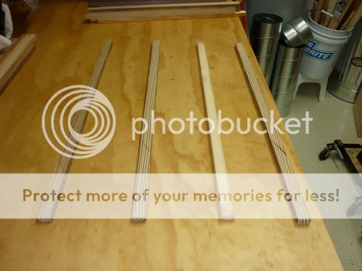

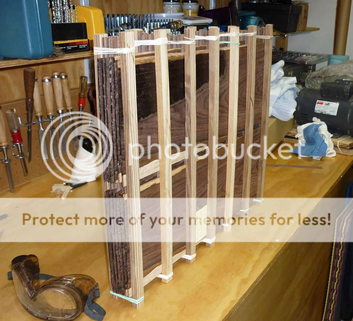

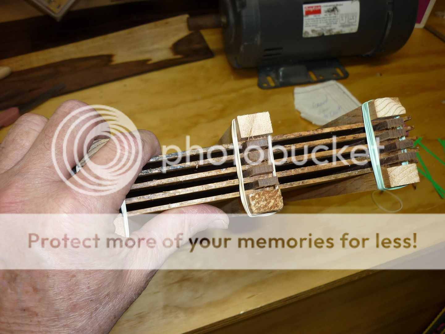

I was using 1x pine for stickers (ripped to final dimension of 1/2" x 3/4"). David Borson gave me a tip which I found very effective. Namely, use 1/4" or 3/16" thick brown fiber board and for sticks and clamp using rubber bands. My bottom and top sticks are the stout pine sticks (1/2 x 3/4) with the fiber board sticks in between. The rubber bands exert plenty of clamping force. Here's some shots:
This gives an option of storing a bundle of stickered wood on end which is very space efficient and allows easy retrieval from several different batches. No wasted space from bulky clamps or thick sticks.
