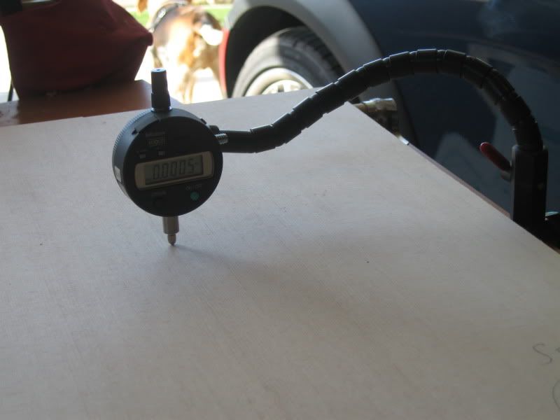

Hi Paul, here's how we do it.
The top is suspended between two points, two fixed points.
The arm holds a dial gauge, and right beside it we set our weight.
In this case, a #4 plane--something I grabbed to use years ago, and now I've got to stick with it.
By that I mean all our tops are tested at the same dimensions, tested under the same weight, and the resulting number tells us at a glance how any top compares with all the others.
Perhaps not the best system, but it is yielding us some useful info.
