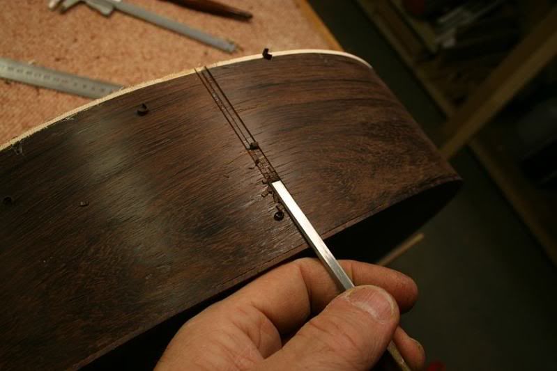

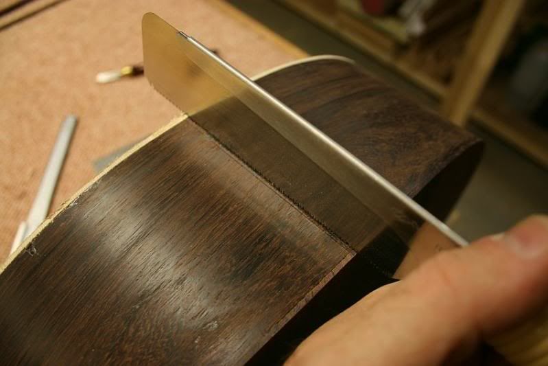

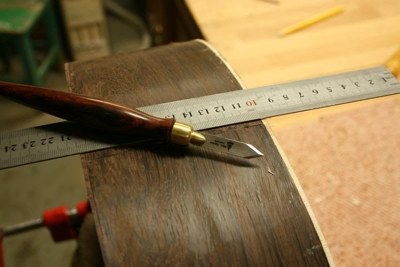

I use a mini douzouki from Dick GMBH in Germany. Its an inexpensive but very functional saw, I think its the one in this link
http://213.131.232.114/product/712816/Dozuki-Mini-150---crosscut/detail.jsf
Here's my method: First, I mark the cut...
...then I saw. It is actually done along the steel ruler too (Not visible, behind the saw blade, attached to the guitar with double stick tape)
Finally, I chisel out the waste. Its faster to do it than to write about it!
