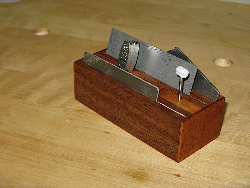

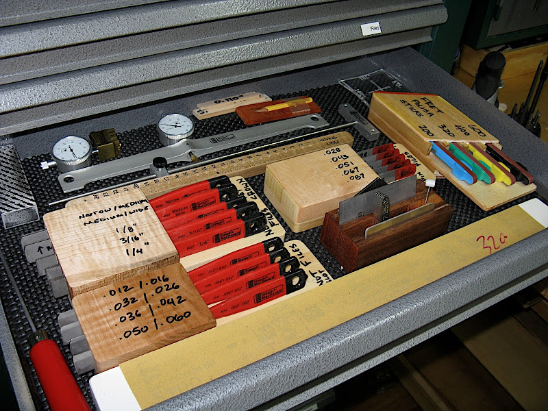

I got sick of having all my setup tools sprawled everywhere. Good use of scrap wood. Slice a few slots in a mahogany block with the table saw, smack some walnut scraps on the end and away you go.
This may look all fancy, but frankly it was all of 30-45 minutes of work with whatever scrap I had laying around. What I really like is that I can quickly take sets of tools to a station and work. No more, "grab this. grab that."
Filippo
Filippo,
Nice!! I'm going to steal shamelessly...
