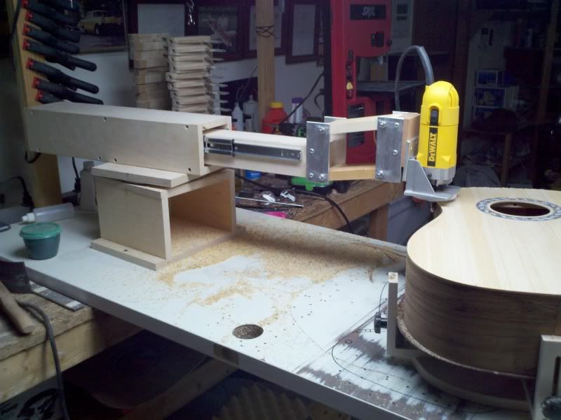

I built one just based on the pictures on the LMI website. You can build one if you are so inclined. Mine works very will and wasn't all that hard to build. Cost me about $50 for the hardware. edit: that way I had money for the bit/bearings set.
Hey Steve,
That turned out nice!
What did you use for the doughnut?

Tarhead wrote:
Hey Steve,
Thanks, I am pretty happy with it.
The donut is delrin. I had some laying around and I have a small lathe so it was easy for me to make. I think John Hall might sell them if you don't have the equipment to make one.
