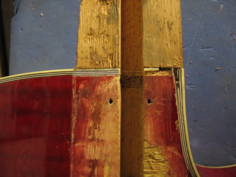

Hi
Does anybody know what kind of neckjoint is this Image
Juss
 Post subject: Re: Acoustic repair help
PostPosted: Sun Oct 31, 2010 1:29 pm
Posts: 4915
Location: Central PA
First name: john
Last Name: hall
City: Hegins
State: pa
Zip/Postal Code: 17938
Country: usa
This is most likely a doweled joint . It is butted to the sides of the guitar and help with some dowels.

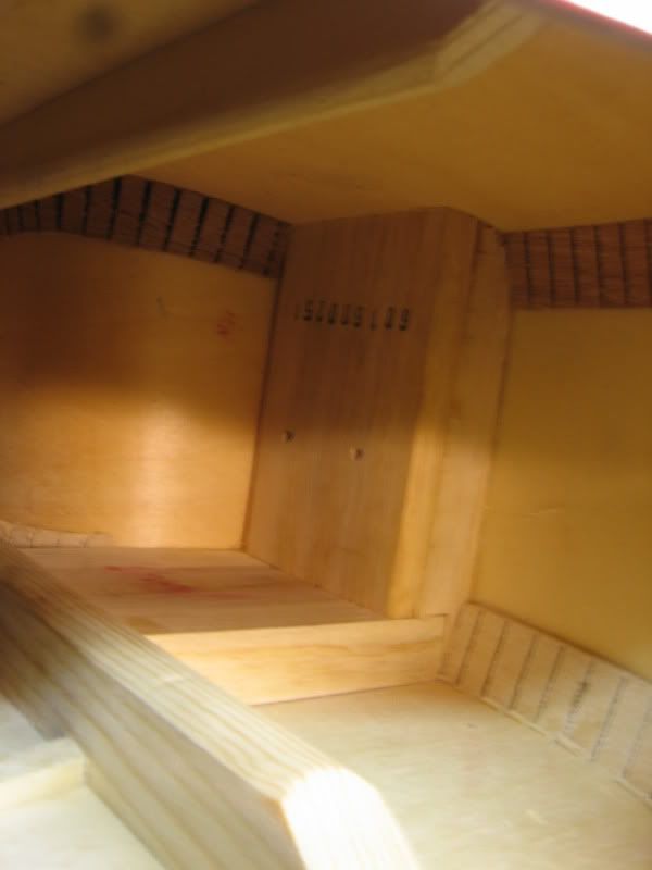

Thanks for your replay. This is how it looks like from inside
PostPosted: Sun Oct 31, 2010 4:22 pm
Joined: Fri Feb 01, 2008 8:47 am
Posts: 1244
Location: Montreal, Canada
Indeed it looks like a doweled joint.

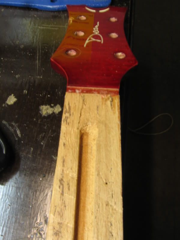

There is another problem
trussrod channel is off the centerline.
Question is should I fill the channel and make a new one.
