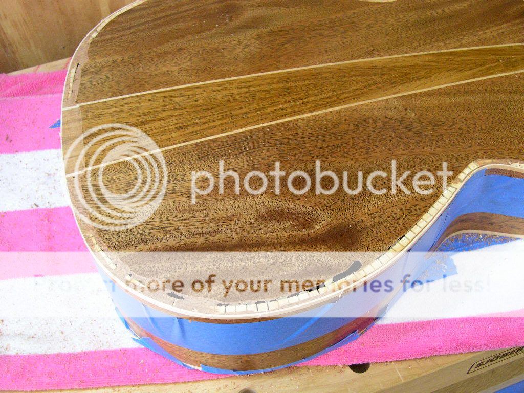

Last night I attempted to glue the back onto my sides. I wasn't happy with my go bar deck and rods as I was either getting too much pressure and denting the back or not enough pressure and not getting a good seal all the way around the body. This AFTER I had already put the glue in place. So I was trying to hurry (not a good idea) and just used 10 F clamps and cauls I had laying around instead. Checking it this morning I noticed that one or two of the clamps had slipped and there is a gap between the body and the sides about 1 1/2" long in one area and about 1/2 long in another.
After spitting out a few choice expletives I figure I've really only got one option and that is to remove the back and glue lines and start over. I don't have steaming equipment, needles etc. Suggestions as to how I can accomplish this are welcomed.
Oh btw, I immediately got online at work this morning after getting my first cup o' joe and ordered 25 luthier spool clamps as a way to prevent this from happening again. Hopefully they'll get here b4 the weekend.

By the sounds of it you shouldn't need to remove the whole back. I'd use an iron directly over the gaps, warm it enough to get a knife in to remove the old glue, rub in some new glue and clamp. If the gap is at the back seem I'd do the same but with a warm knife only so as not to open the back seem. Remember that after you bind those areas will be reinforced.

Unless you used hide glue, I would remove the back and reglue. This is the only way you will get the best result.
Just use an iron and a thin knife and work you way around the top. It's not a big challenge.

I would try ironing the gap areas if you have used titebond. It will melt fairly readily and enable you to clamp it together till it cools and hardens.

Thanks everyone for the tips! Used the wife's iron set on 3 (just below the steam setting) and held it for 3-4 minutes per area as I worked my thinnest scraper blade between the sides and the back. One note for next time is that if I have to do this again (probably) I'll mark where the braces are so as to not push the blade so far into the body. The ends of my top brace now have a 2" gap or so underneath them and will need to be reglued or shaved off and replaced. It took me about an hour to remove the top and hand sand off the glue lines on the back. I'll be putting the sides back in the radius dish to clean up the remaining glue and retruing it for attachment.
