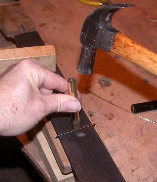

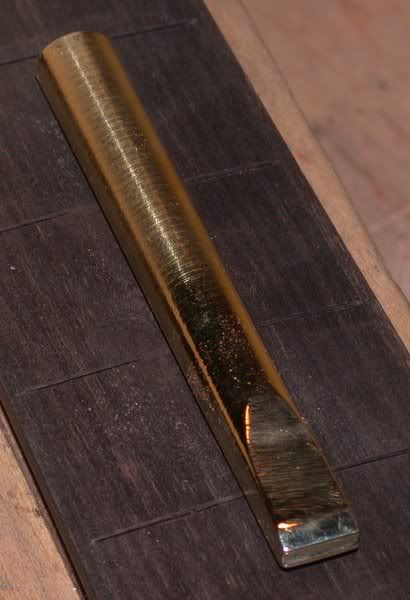

Here's a tool I made that helps with stuborn frets and fret ends. Stewmac sells something similiar.

John, that hammer looks alot like my fretting hammer eek eek eek
You have an old Maydole too? I just switched to it, I had been using a fret press. I was thinking that I need a new fret hammer and then I spotted the Maydole sitting in a pile of tools with years and years of paint and tape on it. I took a closer look and decided to give it a sprucing up and a promotion.
