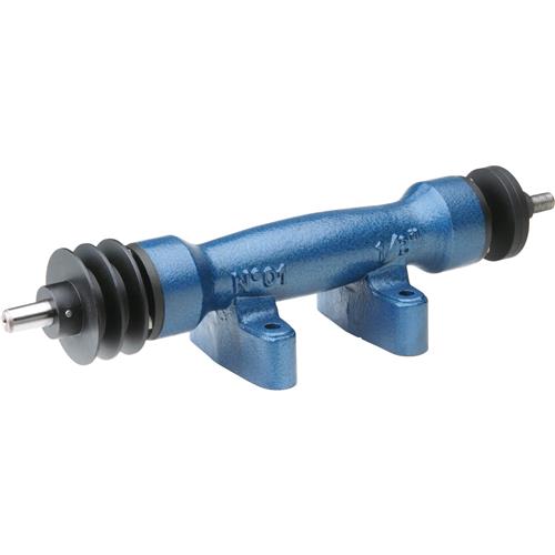

Can a good buffing machine be built from one of What are your thoughts on using one of these units from Grizzly to build a buffing machine?
What size shaft do most of you use? (I could get 1/2", 5/8". or 3/4")
I have a small motor I could use that pulls 3 or 4 amps. Think that is enough for a loose belt setup? Where is a good source with a good selection of pulley sizes to control the rotational speed?
Thanks!

You need much longer shafts, particularly to buff the sides.

you can use this uniit , it isn't that expensive .
http://www.grizzly.com/products/Buffing-Assembly/H3559

That's a great suggestion John, thanks. Thanks Laurent for pointing out the flaw with the width.
Any suggestions on a source of pulleys of various diameter to control the rotational speed of the shaft? I will check out the thread suggested by Woody, thanks.

The Shop Fox buffer suggested by John is what I use with an old Delco 1/4HP 1725rpm motor and 12" wheels. The buffer already has 3 pulleys.

I did similar but have a 16 and 12inch wheel on mine. The 1/4 hp is plenty and it won't throw the guitar out of your hands like more powerful buffers. It isn't hard to set up.

Looking at older posts, it seems most folks are running from 500in/sec - 700in/sec at the edge of the buffing wheel. Seems slower for lacquer/varnish and a little faster for polyester. So does the surface speed depend on the hardness of the finish? I will be using KTM-SV (a water based, cross linked urethane) which supposedly is a little harder than lacquer. So I'm wondering what speed would work well. If I err on the slow side, what will it hurt? Just take longer to buff or will it not do as good a job?
