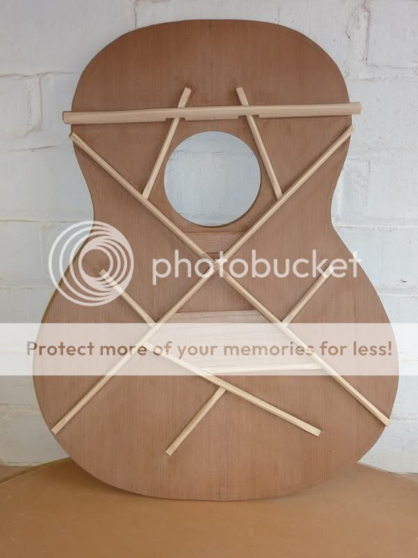

Here's how I do mine.
I put the peak of this "Don Musser" brace right behind where the treble e string will be. It tapers off to the legs of the "X" on either side. It is 1/4" wide, roughly 3/8"+ tall at the peak.
I've found a balance across the range, with an increased sweetness in the trebles. I always use it.
That's the brace from the article I saw. Do you use the asymetrical X that Don mentions in the article too?
Hi John, no, the assymetrical X is one thing I haven't tried.
In a way it makes sense, leaving the treble leg unscalloped--to bring out more trebles--but I feel that the tone bar/Musser brace/finger brace intersection gives ample localized stiffness.
Having both lower legs scalloped is our effort at getting the entire top to work at those low frequencies.
