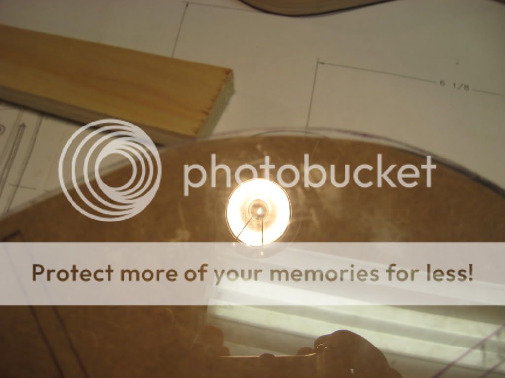

PostPosted: Sun Sep 19, 2010 12:21 am
Joined: Sat Jul 31, 2010 4:03 pm
Posts: 180
First name: Neil
Last Name: Kwak
State: PA
OK, I found my camera. It was hiding in with the kid's toy travel bag...
Anyhoo, here are some snap shots of the variation on some of the forms:
FWIW here's how my second attempt at a mold is going. I'm currently working on the master and trying to get it as close to perfect to the plans as possible. I'm really close but have to figure out a way in my budget to replicate it 3 more times for a semi-solid mold.
