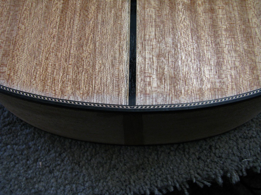

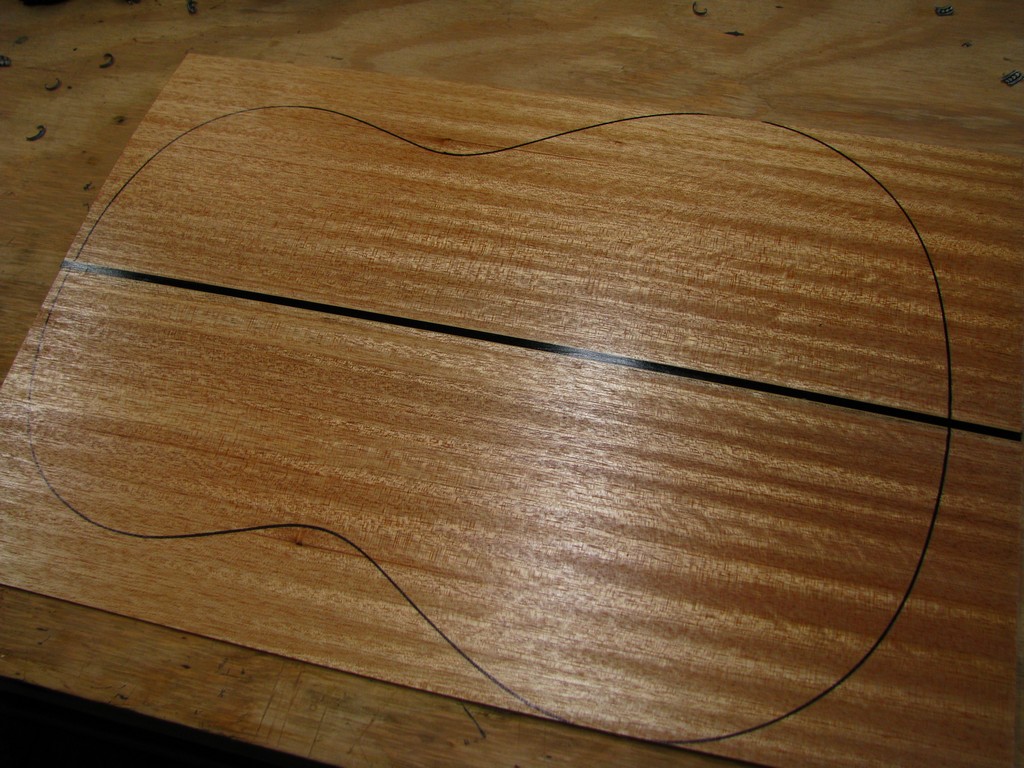

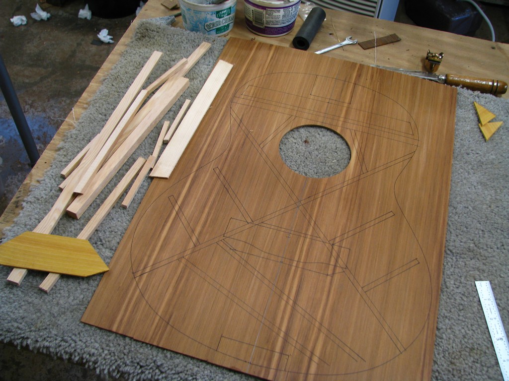

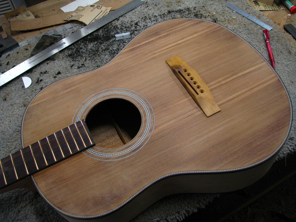

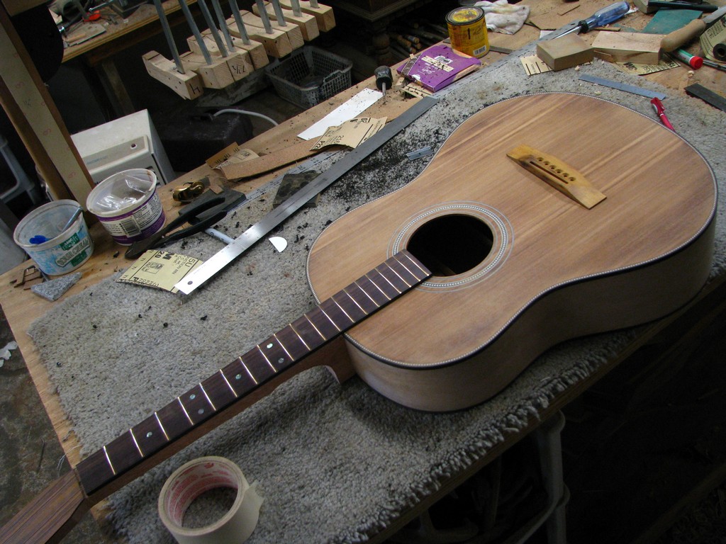

Hey all!
Right now I'm making a steel string guitar for myself, and I'm trying to keep costs down as much as possible. I find it to be a fun challenge to try to make as good sounding a guitar as possible for as little money as possible. Or I'm just cheap. idunno :mrgreen:
Anyway, I'm using western red cedar from Menards for the top, and quartersawn mahogany (from Menards) for the back and sides. The neck will be Menards mahogany also. I'll probably use osage orange for the bridge. The only parts I'm getting from out of town are the soundboard braces (spruce), and the fingerboard (rosewood). Also the purfling, tuners, truss rod, rosette, etc. I'll probably use walnut for the binding, and osage burl for the headstock veneer.
Some pics of what I have so far:

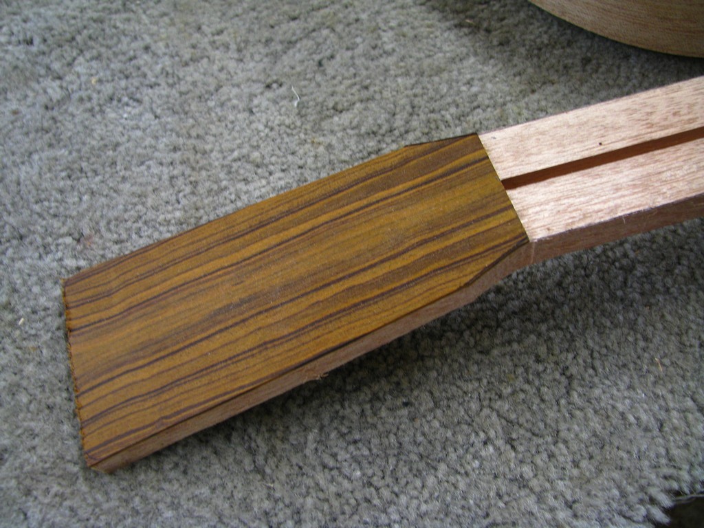

I started making a desert ironwood radial rosette, but then decided I wanted something that would contrast more with the cedar.
Stay tuned.
Phillip

PostPosted: Tue Aug 03, 2010 5:02 pm
Posts: 3081
And a very nice start you have, Phillip. From my point of view, I like your rosette better than the radials...
Keep up the good work, and take your time. You will be rewarded with a very nice guitar!
PostPosted: Tue Aug 03, 2010 5:40 pm
Posts: 2186
Location: Newark, DE
First name: Jim
Last Name: Kirby
That's beautiful stuff! Plan sounds good.
Jim Kirby
kirby@udel.edu
PostPosted: Tue Aug 03, 2010 6:13 pm
Posts: 2351
Last Name: Garrish
State: Ontario
Interesting choice not bookmatching the top. It does give it a pretty neat look having the offset streaks, though.
Bob Garrish
PostPosted: Tue Aug 03, 2010 6:31 pm
Posts: 13661
Location: Ann Arbor, Michigan
First name: Hesh
Last Name: Breakstone
City: Ann Arbor
Great looking progress Phillip and my hats off to ya too for the frugality!!! [:Y:]
I've never been to a Menards but there is one in Toledo near where I live now so now I have another reason to check it out.
PostPosted: Tue Aug 03, 2010 7:07 pm
Posts: 1505
First name: Douglas
Last Name: Ingram
City: Lorette
State: Manitoba
I'm heavy into frugal lutherie, and I must say I like how yours is looking so far!
http://redrivercanoe.ca/
PostPosted: Tue Aug 03, 2010 7:11 pm
Joined: Mon Oct 08, 2007 2:31 am
Posts: 936
Location: Ottawa, Canada
OK, I gotta ask.
Did you mean to not bookmatch the top? Not that I think it looks bad - as Bob pointed out, it's interesting. But I am curious to know if it was one of those things we all do at some point like bending two upper sides.
I applaud your frugal approach - I get a kick out of that as well. Something about turning low value material into a high value finished product.

Yer my kinda guy buying at Menards and all but hmmm...why didn't you get your spruce there as well? Like they have 2x6 which are usually spruce.
Just wondering.
That hog looks rice nice. Me often wondered why everything has to be book faced. Good for you.

I like it,I sort of feel you might have done it on purpose, makes a four piece top look two piece board matched as a nod to its budget heritage.
Easy to be wrong though ain't it...

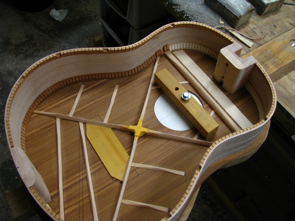

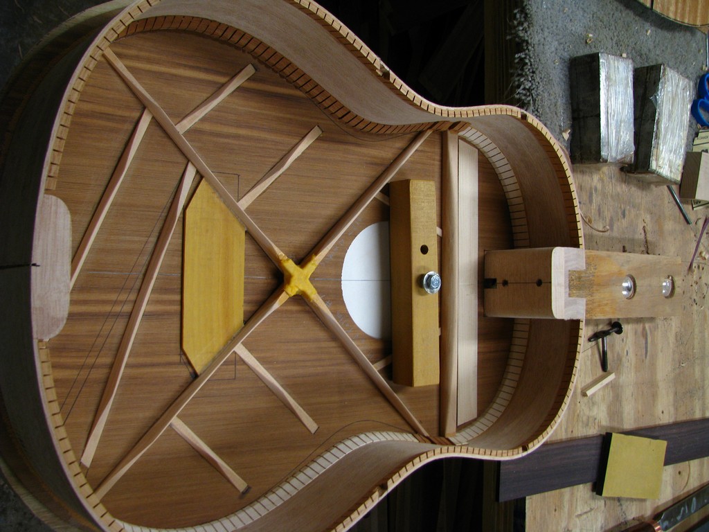

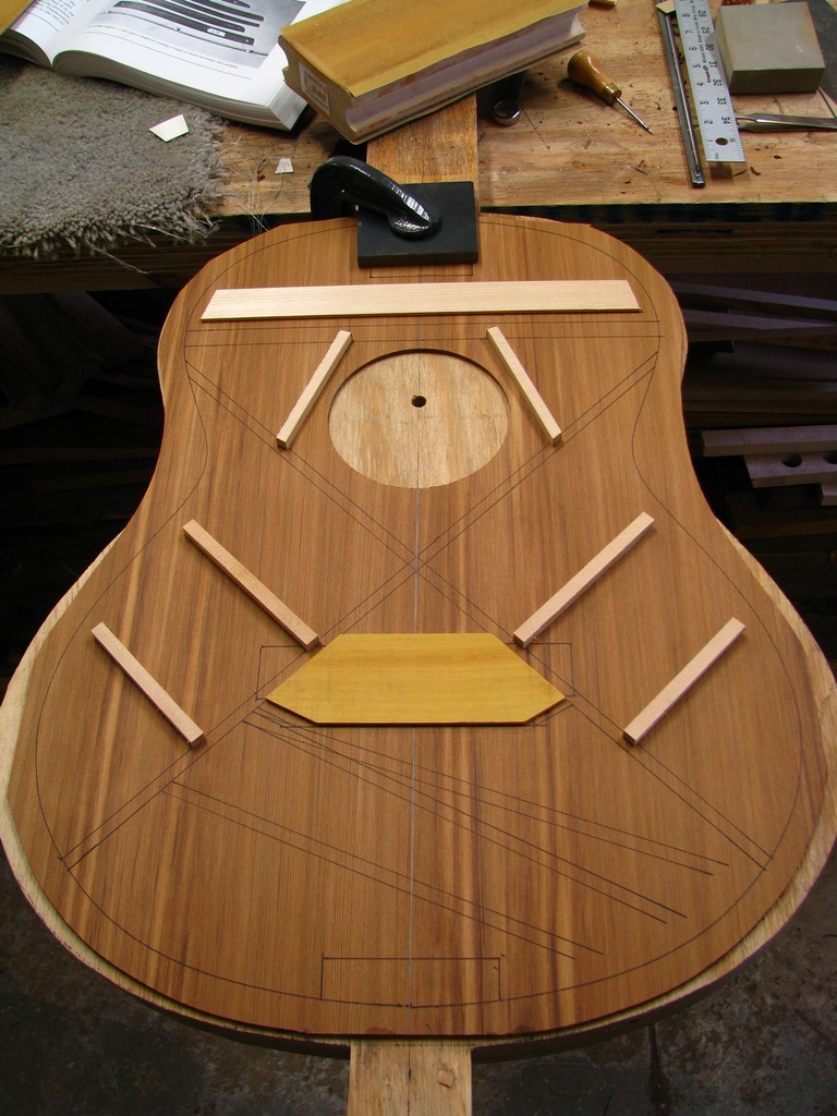

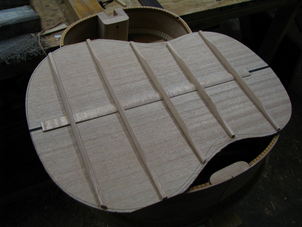

I'm guessing I have about $10 of materials in it so far. [:Y:] The greatest expense will be the tuners.
The cedar is from a 4X4 fence post, so the top is made from 5 pieces. I could have made it look book matched, but I would have had to have another seam, and I just decided to take the easy way out.... As I said, this one is for me, and I don't care if the top is book matched.
Here's another one I made with the same cedar:
viewtopic.php?f=10101&t=27979&hilit=all+cedar+guitar
Today I'm bracing the soundboard. The bracing is scrounged also, though it didn't come from Menards. It came from Grizzly. It's the scrap wood they use to protect kerfing when they ship it. Really nice stuff. bliss
Any input you all want to make as I work on the bracing would be appreciated. :)

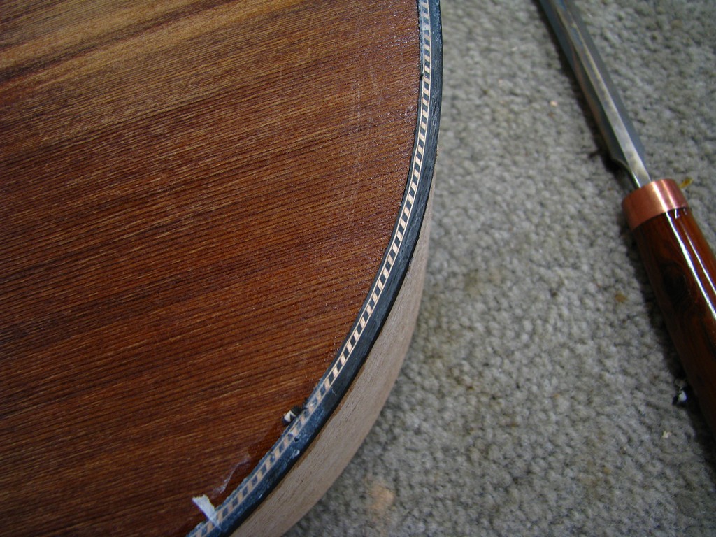

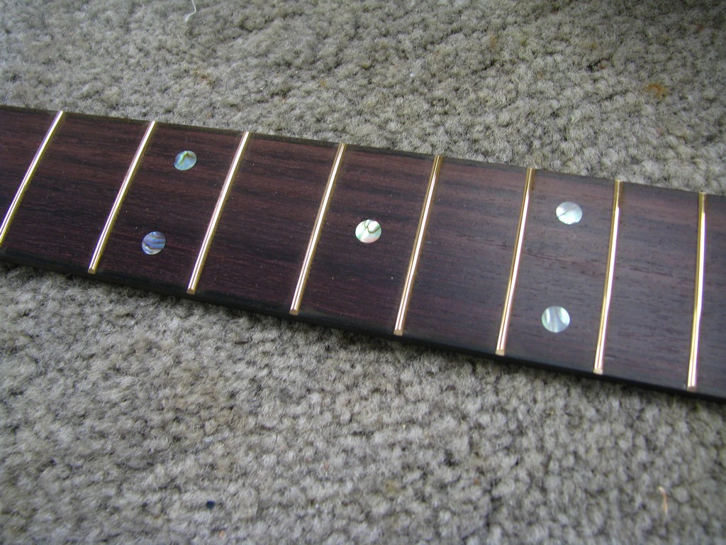

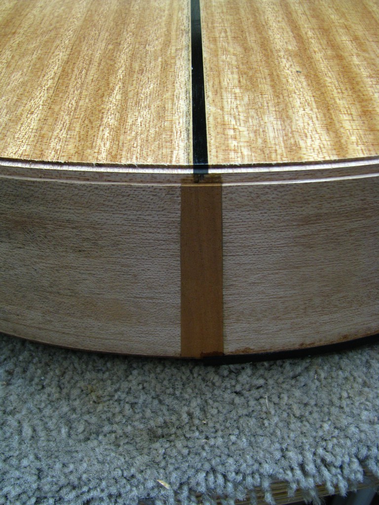

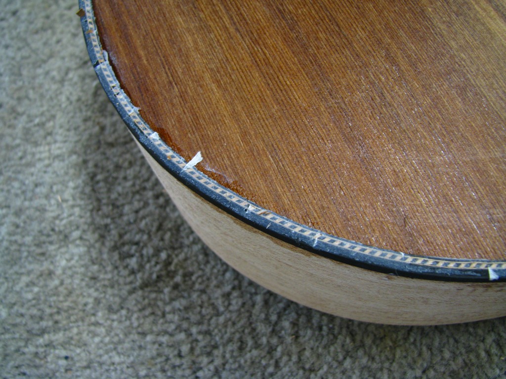

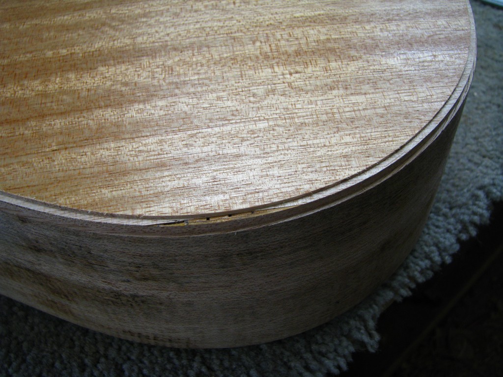

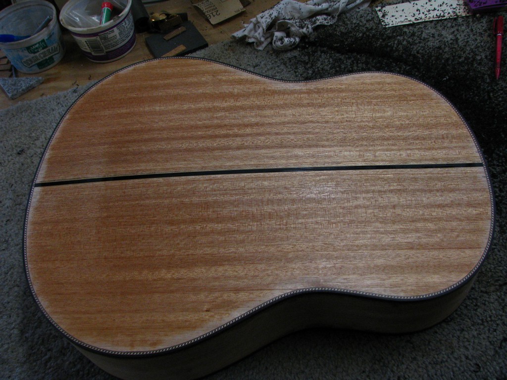

Well, I've made lot's of progress, but messed up the purfling when I tried to bend it, so kind of stuck until more arrives... But here's some more pics:

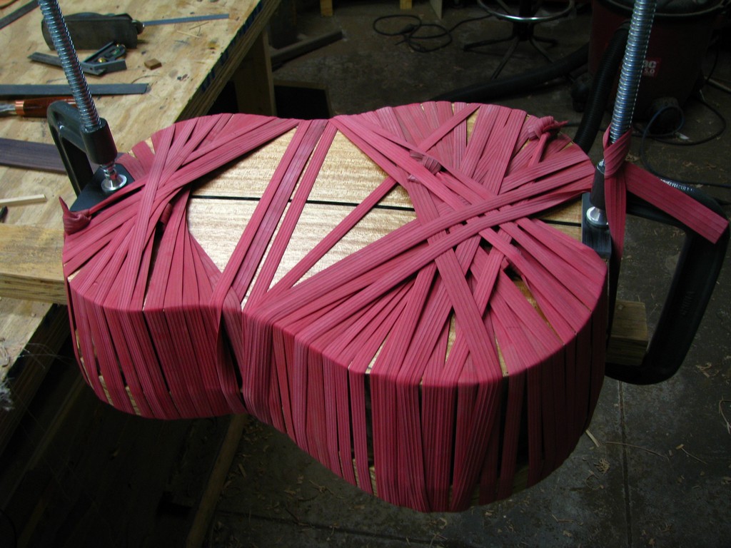

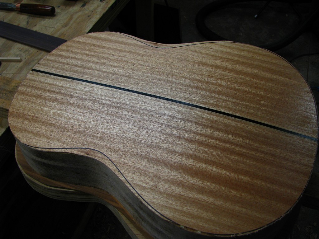

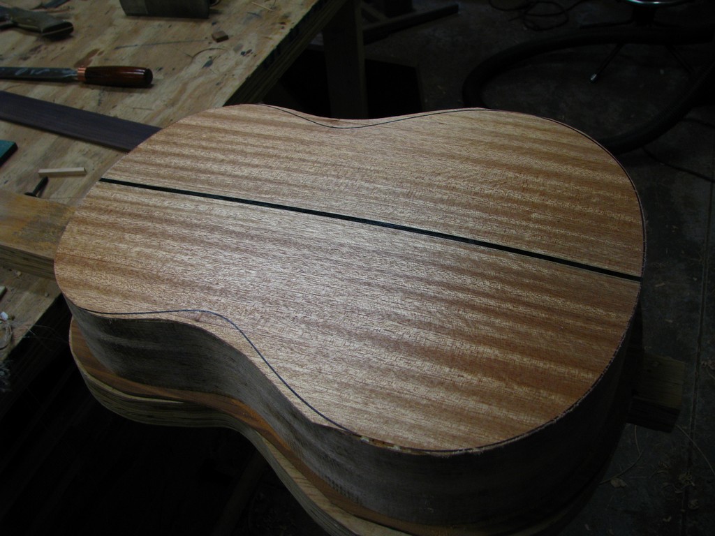

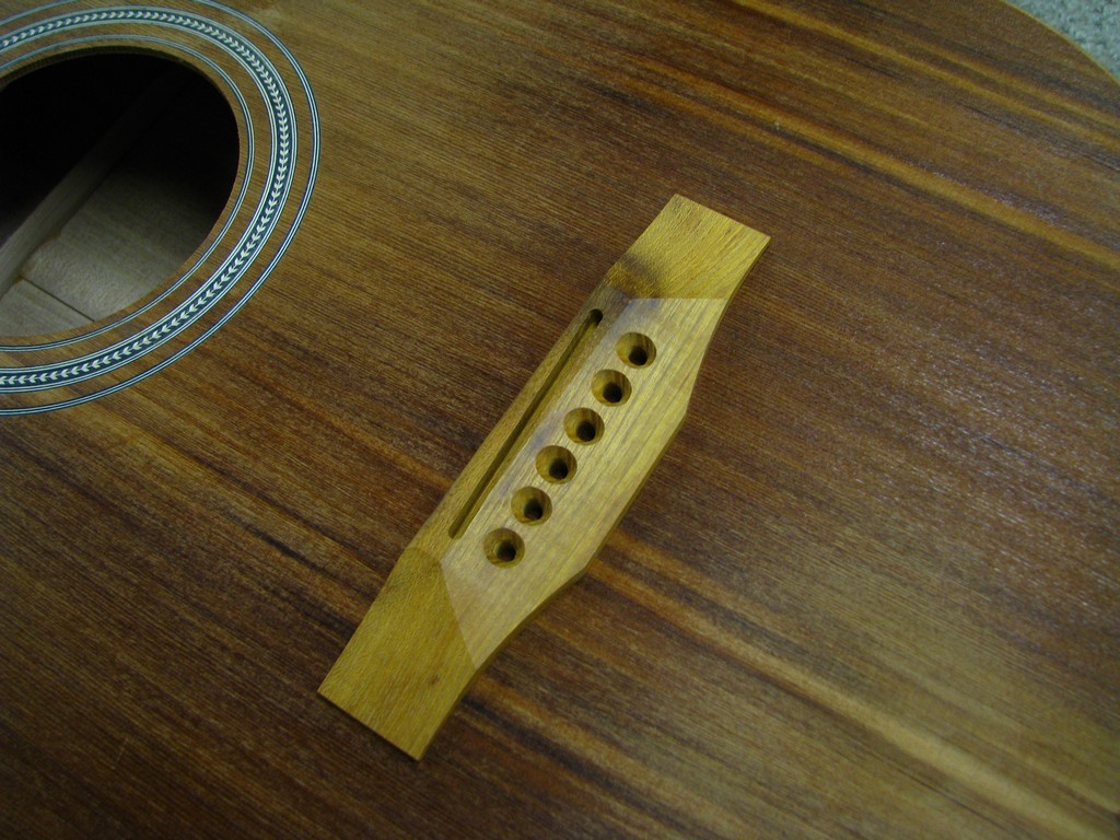

More pics:

I am not alone!
Bob :ugeek:
PostPosted: Sun Aug 15, 2010 8:52 am
Posts: 1075
First name: Coe
Last Name: Franklin
City: Decatur
Whoa!
It looks as though you have it going on, dude!
Very fine work!
And I thought I was one frugal SOB.
Now, what`s this about Menard`s having mahogany? That`s a new one on me and I mean to tell you that I`ve talked to every retail center and lumber yard around 3 counties and I get the look like I`m from Mars or something! The best I can get is dunnage.
Must have info. PM please!

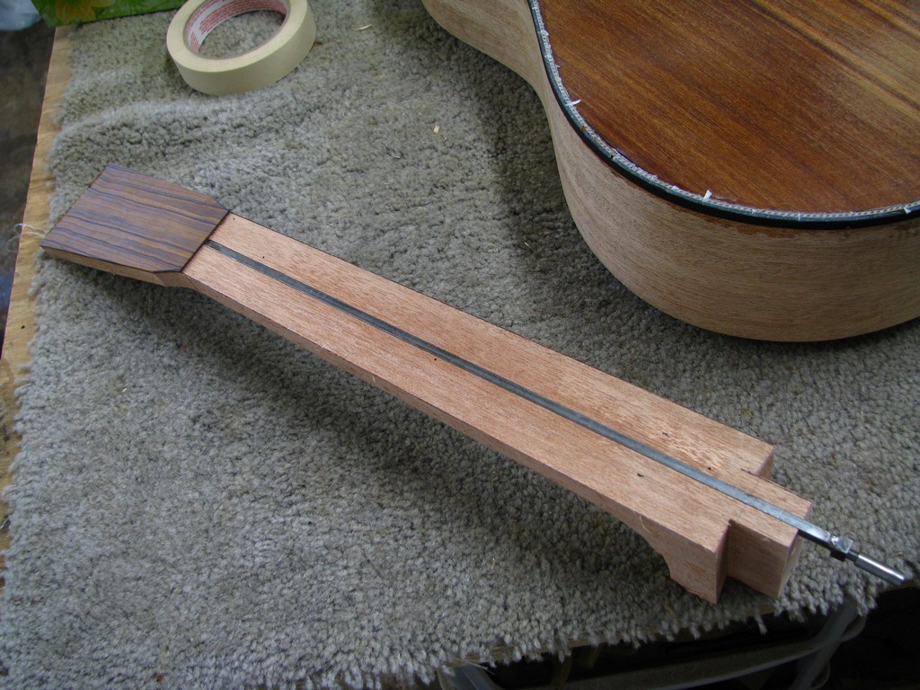

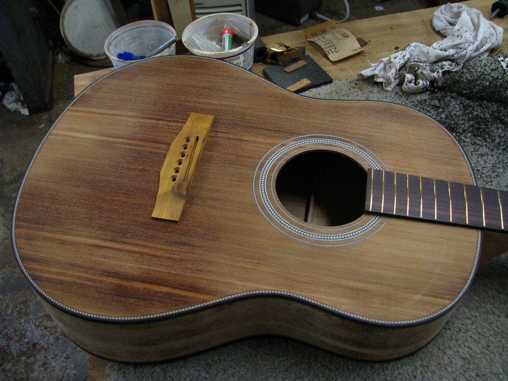

Some progress:
Just have to shape the neck, and sand the body a little more, and I'll be ready to start spraying!

Looks awesome !

Awesome, for sure!!!
You inspired me to look for a Menards. I found one near home and scored some of the same cedar and mahogany.
Thanks!!!
