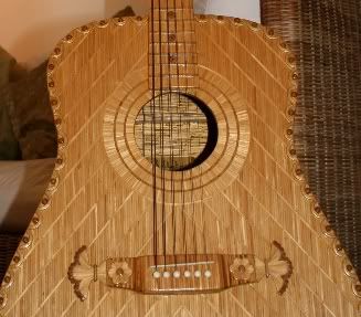

Go for the matchstick look.
then there is this one
Of course you go do the fuzzie wuzzie furry thing...
