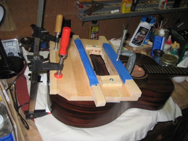

You need to make some kind of jib to open the slot. If you have a 3/32 saddle going to .125 may help you. I set my saddle .100 on light strings and .125 on mediums to the center of a .100 saddle following the actual string line. I allow another 1/8 " to the bass string. This gets me very good intonation . I have used .125 as requested by customers and this allows a good flexibility for setting intonation.

the saddle slot is 3/32. I have a couple of weeks before I give the guitar to the friend I built it for. I can build a jig to widen the slot, and make a new saddle, or I can let it go.

Finally fixed the problem once and for all last night. I built a saddle slot jig and used a Whiteside 1/8" spiral downcut bit. My intention was to add 1/32" to the back of the saddle, but it was hard to get the bit to be exactly right up against the front of the slot. My line was even, but I added a touch more than 1/32". Oh well, it sounds good now.
