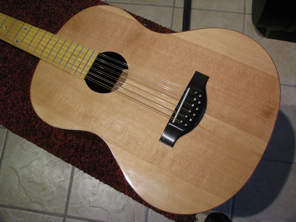

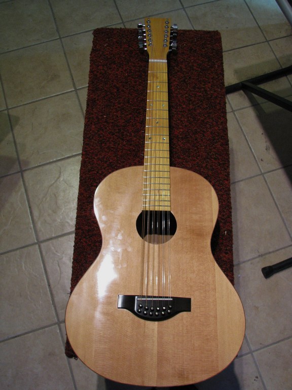

Well, not ALL have come to that conclusion. :D My first two guitars had the entire top and the bracing made using a recycled piano soundboard.
I will say that it's probably not worth the effort, unless you're doing it for sentimental reasons (My grandfather who passed away a few years a ago received a baby grand piano for his 12th birthday. My aunt owns the piano now, but if it ever has to be scrapped, I'm getting the soundboard. :) ) or for the satisfaction of giving new life to an old instrument. Or you have a lot more time than money. :mrgreen:
Number 1:
Number 2:

Philip, is that osage? Looks nice! Oak neck?

Yep, osage back and sides on both, oak neck on number one, and curly maple neck on number two.
Nowadays I usually use mahogany for necks. Lot's lighter, and so much easier to work with.
