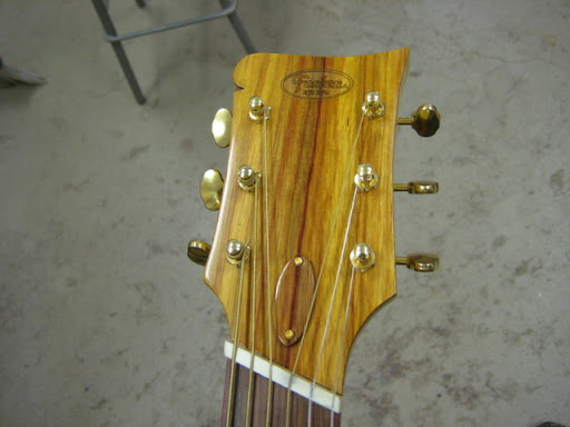

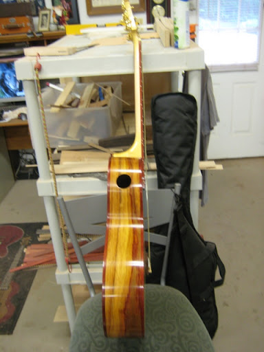

The best sounding guitar I've built has Canary wood for the back and sides.
It was easy to bend and smelled wondeful when sanding.

Bert,
WOW!!!! What a beautiful instrument. Thanks for the positive feedback!!
