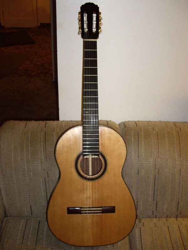

Ok I know its supposed to be #5 Alive (80's movie reference alert!), but I couldn't think of anything snappy with #1.....
Anyway, 10 months ago I owned a pipe wrench, a screwdriver, and some sockets, as far as tools go.... I had only done a few rather basic things with wood, like sawing some 2x4s heh.. so to call me a newbie would have been an insult to newbies everywhere.
Further, I live in a smallish apartment without access to things like band saws, table saws, and drill presses, so everything had to be done with hand tools.
I made tons of mistakes along the way, the end result has many cosmetic errors, the rosette is kinda fugly, and in fact it doesn't even sound very good... but its done. Its a classical patterned after the 1961 Bouchet.
Thanks to everyone here for the occasional advice you gave. It was very helpful. My main build thread is over the luthiercom.org here if anyone feels like looking through it. I probably posted over 50 images of the process.

Here are some pictures of the insert. The mahogany I used seemed to have larger pores, and some dust from the fingerboard got into them making little black specks. Couldn't figure out how to get em out heh. Not too terrible looking though I guess. Ill try to post a sound clip later. When I play it side by side with my 'good' guitar, the good guitar is like listening to a nice two speaker stereo output, while mine sounds more like a mono output on a little radio. The effect isn't that pronounced, but that's the best analogy I can think of. It almost sounds like it's making very nice sound, but that its trapped in the box and can't get out.
The insert at the 19th fret is 3.5mm, and my saddle is 3.5mm above the slot, so it was maybe a tad higher than I needed, but a pretty good estimation overall.

I noticed another issue today as I was playing. On the bass strings, if I fret in between frets, rather that getting right up on them, I get a buzz. I wonder if my frets aren't high enough so that the string doesn't come down tightly on them when I am sort of in between frets.... I really should not have filed them down at all I think. I did it because both my books said to do it, but im thinking now it was unnecessary.

I don't know how to attach mp3s in a way to allow you to play them right from this post, so here are two links. The first is to me playing a song on my newly built guitar, the second is me playing the same song on my 'good' guitar, a Hiroshi Tamura P50 1972.
I am not a great player, so forgive the mistakes. :oops:
http://sutros.com/songs/6760
http://sutros.com/songs/6761
The good guitar has quite a bit more volume and projection. Mine sounds a bit, well, wooden.

Nice work at the neck.
An elevtated neck at your #1 that's really some achievement there.
I think the sound is quite typical of a Bouchet bracing due the cross Bouchet bar.
Try a few months of playing in, the bass will get better.
If not can consider reaching in and shave off some height of at the bass side of the Bouchet bar.

Ahh thats good to know. You are referring to the bar across the lower bout rather than a bridge patch???
