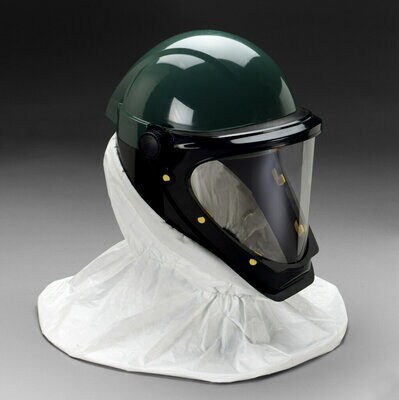

Edward, this link will show you the SAR that I use in my cabinet shop
http://www.sperian.com/Products/Sperian ... ir_(CF-SAR)_AABA_Pumps_and_Systems_(NIOSH).aspx?site=/americas
I purchased one about 10 years ago for about $800....best money I ever spent. At the time I was refinishing furniture and replacing cartridges every 6-8 hours (recomended) in a regular mask. At $25 for cartridges the cost of this system quickly paid for itself. The SAR unit has one dust filter which is replaced every 100 hours at $4. If all you're doing is a few hours here and there it probably wouldn't be worth it.

Hey Mike, I don't mean to be contentious and maybe there's something I don't get, but I don't feel one type of spray setup demands a forced air breathing system whereas another doesn't. It's all about how much air is moving through whether it's forced in or sucked out. Either way, I'd call a good filter respirator the mandatory minimum and a forced air setup the wise option. At my old cabinet shop job where I was the spray guy for about a year, we had a commercial automotive type booth and just used a filter respirator, as I think is common practice. It seemed fine, but looking back I think forced air should be used even in that setup. One can't help a little daily exposure, and one gets slowly, cumulatively sensitized.
Like PaulK my forced air helmet is probably the best shop investment I've made. I never even thought about recouping the cost against the stream of cartridge filters (probably because I never changed them often enough anyway...) I went with the 3M L-901 full helmet style and fed from my compressor which needs a special filter to produce "grade D" breathing air. This setup cost around $1100 total, a mere blip against potential long term health expenses due to spray exposure.
Unlike a filter mask, this thing is truly absolute in its rejection of outside air. I got the helmet thinking it would be nicer than a mask stuck to my face and this has borne out true. It is actually very comfortable to wear and the visibility is perfect. I forget it is even on. It's great at the lathe too, or anytime you're making lots of hard to capture dust, and doubles as eye protection. The face shield flips up to drink water or even talk on the phone, though you can wear a bluetooth thingy inside and talk hands free.
Well somehow this turned into a commercial for a forced air helmet. I guess I like mine... idunno
