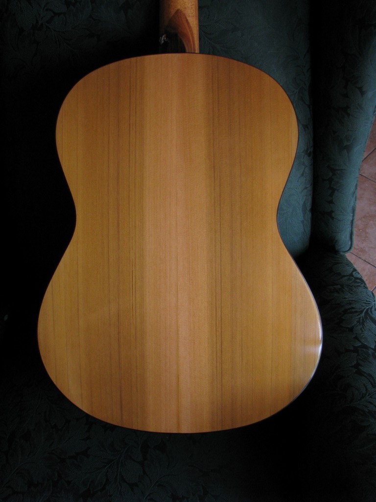

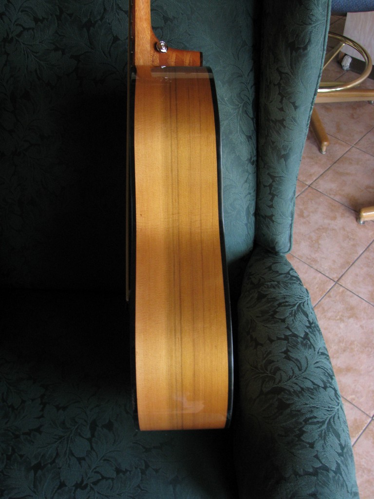

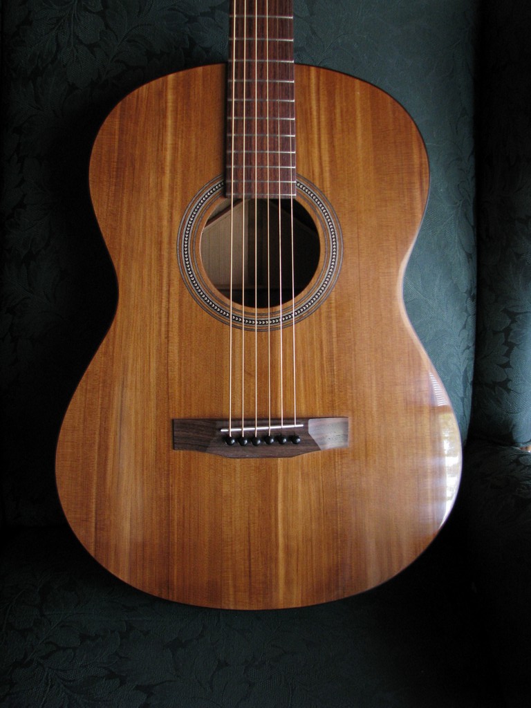

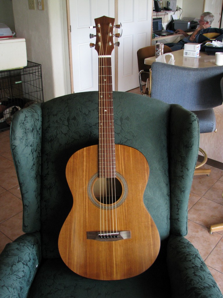

Howdy,
Some of you might remember a couple months ago I asked about the feasibility of making an all cedar (western red cedar) guitar. After getting some input I decided to give it a try, knowing that the finished product would be somewhat fragile.
I just strung it up for the first time, and wanted to share some pics and my impressions.
This was a very "cheap" guitar. The "Frugal Luthier" strikes again. laughing6-hehe
Back and sides were cut from a 6X6X8 fence post I got at Menards. The post was quartersawn, and pretty clear. [:Y:]
Had to use multiple pieces to get the width I needed for the back.
The top is also multi-piece from a quartersawn 4x4 post, also from Menards. Very pretty, and some areas have 70 lines per inch.
The top bracing is a mixture of Douglas fir (also from Menards), WRC, and spruce. The X braces are the DF. It worked out fine, but it was not as easy to carve as spruce or cedar, so I don't think I'll be using it again, unless I can find some finer grained stuff....
The back braces are WRC, in a double X configuration.

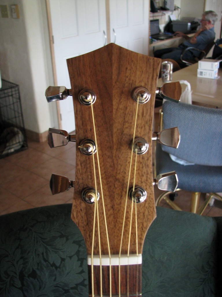

Binding is ebony, bridge and fingerboard are Indian rosewood. Headstock veneer is black walnut.
Nut is corian, saddle is aluminum. :D

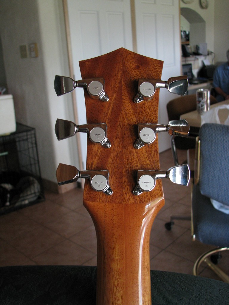

The head stock and heel block are made from some old mahogany I salvaged from the legs of an upright piano. The neck shaft was left over from another project.
I would guess I have about $75 in materials in this guitar, most of that being the tuners.
It sounds good. Probably my best so far. I shaped the braces based on how my previous one turned out (it was over-braced) and I think I hit the nail on the head with this one. I also made the soundhole bigger.
The action at the saddle is a little high yet.
Thanks for looking,
Phillip

I was using a heating blanket and bending press, so it was a piece of cake. :D There was some springback, so I cooked them twice. The only real issue is that the inside of the waist crinkled some, which you can see in one of the pictures.
