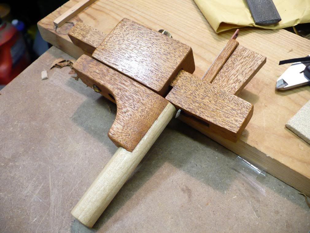

It's not a marking gauge but a cutting gauge. It's used for the cut on the sides, much easier and quicker than using a purfling cutter.

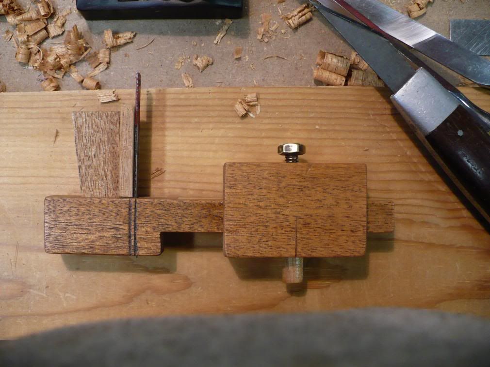

Here's another. I just stick in a scalpel blade. It has been modified recently by adding a small brass block at the bottom to give it more weight. I think the low centre of gravity helps. Don't forget the candle wax - old time trick.
I'm a bit dense, I guess...how does it work? It looks to me like a chunk of 1/4" thick mortising chisel , next to a round metal boss.....
Nice homebuilt tools!
I can't imagine cutting a ledge deep enough for binding by hand, using a scalpel blade, but it must work .

The cutting gauge is exactly that. a cutting gauge. I haven't modified it in any way. The round metal boss is there so that the knurled locking screw has a metal thread in which it engages. What you are thinking is some type of cutter or scraper is in fact a brass wedge that secures the blade. Both that and the blade came with the gauge. This gauge is used to cut the binding channel on the sides only. in other words it defines the binding depth. It's a bit of a fancy cutting gauge, being in Rosewood and Brass. You can get perfectly adequate ones made of Beech - although the modern plastic locking screws are prone to breaking. If you remove the head of such a gauge and round or contour the second face (so that it can negotiate the waist of a Guitar) you have a complete purfling cutter. The flat face (as it is intended to be used) will cut the purfling line for the Sounfboard and the Back - apart from the waist area of course. Unscrew the head and flip it to the contoured side and it will then negotiate the waist area. I no longer use a cutting gauge for the purfling because I have the alternatives. They are a little easier to use for that procedure but for the cut on the sides I still use the cutting gauge.
The scalpel blade is used in one of the purfling cutters, largely because I'm too lazy to sharpen thicker blades. To the thickness of a soundboard or a Back the scalpel blade works fine, although you will have to score to a limited depth and pare away the waste with a chisel before making a deeper cut with the scalpel blade. Once it's through the Back/Soundboard I switch to a Violin makers knife used freehand - that goes very quickly because I only have to meet the scribed line made by the cutting gauge.
I also make my binding the same thickness (or a touch more) as my sides. Make them any thinner and your channel will start to look a little messy.
