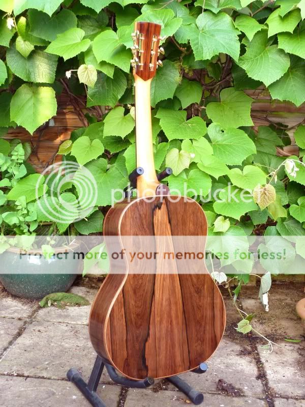

The new one is in Euro/Madagascan rosewood with the following components.
Top, European Spruce (Timberline)
B&S, Madagascan rosewood (Madinter)
Neck, Mahogany
Headplates, Madagascan rosewood
FB and bridge, Old Rio rosewood (Regency table legs!)
Binding, Curly Koa (Bob C)
Purfling/Rosette, Madagascan rosewood, ebony/pear/ebony
I'm very pleased with the voice of this one it has a very full sound with great sustain and separation which can only improve with time, it's certainly one of my best, with the sound I'm after from a guitar. It's certainly far too good a guitar for its future owner! ;)
This Madagascan rosewood is the third set I've used from a batch of six sets I bought a few years ago from Madinter for $70 a set, but is the first I've used on a steel string, it's certainly every bit as good as BRW but unfortunately is becoming as hard to find, though I do have few more sets on the way, but at $150 this time round. :(

Utterly sweet, all of them.
I even like the assymetry in the back's grain in the Madagascan.
Only you, Obi Wan...
Thanks Steve, the assymetry in the grain, was unavaoidable, you have to work with what you've got, I wanted the very point of the chevron to be on the centre line, no other configuration looked 'right'.
