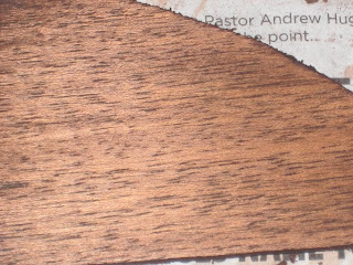

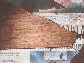

When I visited Wayne Henderson I told him I was planning to use natural colored Behlen's Pore O Pac pore filler, but tint it with dye, and he told me that he uses Pore O Pac, too, but he always uses the pre-tinted kind.
Well, my Pore O Pac filler was unopened so I took it back to Woodcraft and swapped for the mahogany colored stuff.
Now I'm wondering if it's too dark on my new test piece.
Hm, I didn't look closely, but were Wayne's pores little dark streaks too? Does it matter that much?
Why didn't anybody warn me about how messy this stuff is? :)

Martin: Think your test piece looks super. Having the pores of Mahogany very dark is one of its nicer looks IMO. Have fun and take care.

Filippo Morelli wrote:
Why do you want to use a filler? Just curious.
I don't understand your question. You used a pore filler, and it looks great. so why do I want to use a pore filler? because I want it to look good, too.
I started the thread because I was wondering about what others thoughts were, about having little dark pores. I hadn't been paying close attention to these details in the past because I'm new to finishing. I was just wondering if there was a woodworker 'thing' about having pore fill be the same color.

Martin,
For what it's worth, I think the samples you show look great.
You might try putting some finish on them and see how it looks that way, but I think it's fine.

Filling is part of the finish process. If you are doing a martin style finish you want the color dark. Martin uses a 2 step staining process with red mahogany first ,then brown Mahogany. The pore filler they use a a dark brown , almost the color of hershey's syrup. The also use a spirit based filler and it is applied and buffed into the pores. You cannot get a good gloss finish without this step. Using lacquer and filling that way will over time show some sinks at the pores.
Filling is one of the base steps to finishing and one of the hardest to master.

I like the medium brown walnut tinted version. Gibson use this color as do a few others.

Martin, one thing that makes a big difference in using paste pore filler is applying a seal coat before the filler. This makes cleaning the residue off much easier, but the best thing is it results in a cleaner fill job.
It also help to prevent bleeding of the tint from the filler to else ware other then the pores.
