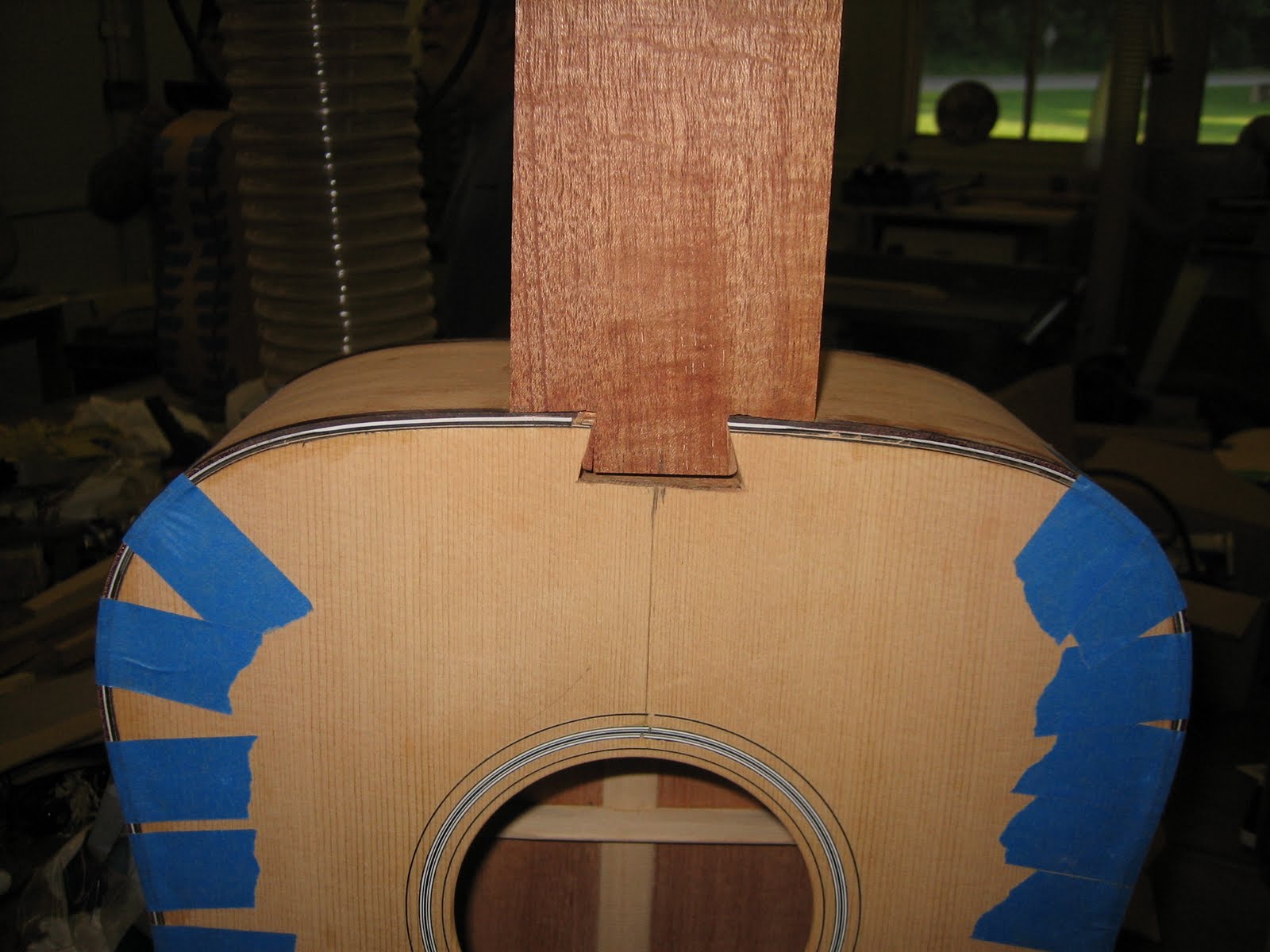

So I read in Allen St John's book about how Wayne Henderson does this. I've seen the finished result, but I'm just not grasping how to do it accurately and consistently.
You can see the saw blade marks on this neck, where the tenon was cut.
And in the following image you can see where both passes on the table saw left a little criss cross shape at the bottom of the neck block.
Do any of you do it, or know how? Post a picture, pretty please?

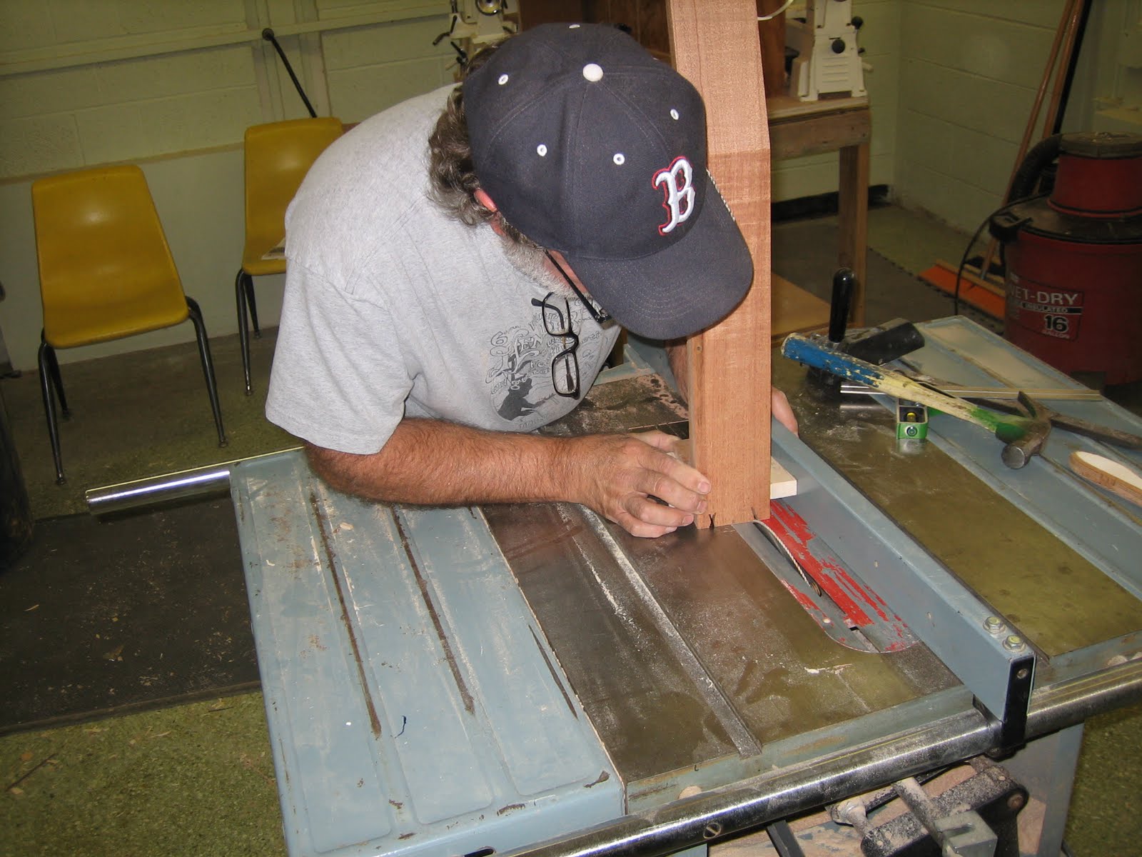

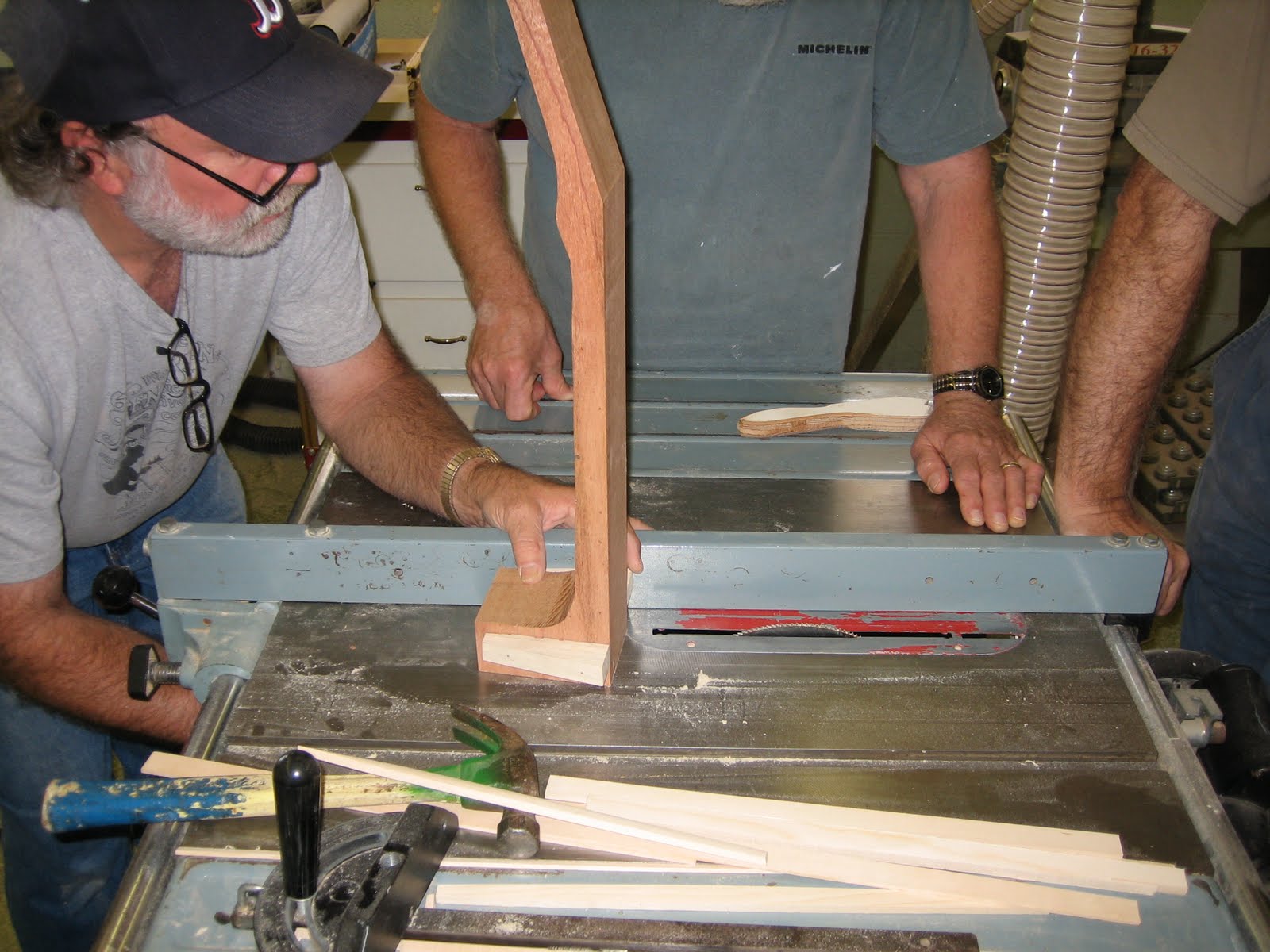

I got the full scoop on Wayne's method via email just a bit ago.
"The trick is to use a finish saw blade. The blade on that saw is a
7-1/4" plywood cutting blade with very little curf. You surely would not
want to try this with a big tooth 10" blade. That would be dangerous."
"We nailed some small nails, 3 penny or smaller into the blocks and then
snipped them off leaving about a heavy 16th of an inch sticking out...then
sharpened that with a file. The blocks are then pressed by hand into the
neck blank."
"the first cut is a 15 degree cut. You can see the jig in the photo. Wayne
made that on the spot. There are two identical pieces one for each side."
http://4.bp.blogspot.com/_En-9Zy8jJW8/S ... G_1957.JPG
http://1.bp.blogspot.com/_En-9Zy8jJW8/S ... G_1959.JPG
http://4.bp.blogspot.com/_En-9Zy8jJW8/S ... G_1960.JPG
"For this cut the saw is set on 2.5 degrees."
http://1.bp.blogspot.com/_En-9Zy8jJW8/S ... G_1964.JPG
http://3.bp.blogspot.com/_En-9Zy8jJW8/S ... G_1963.JPG
http://4.bp.blogspot.com/_En-9Zy8jJW8/S ... G_1965.JPG
