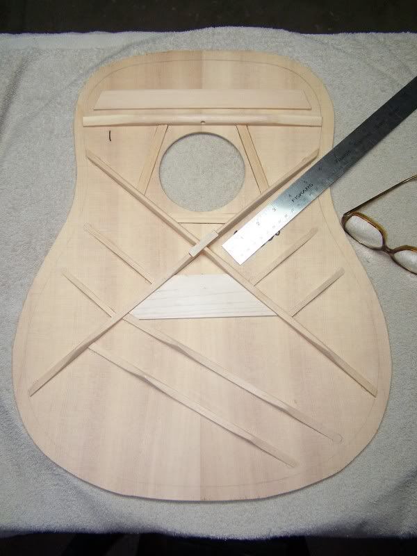

Hi guys,
I recently had an issue with the top radius reducing after removing from the dish.
So, I rebraced, removed it from the dish and a week later the radius in the lower bout is once again gone !!
This time I watched the humidity carefully, for a week before the rebrace the RH was 15%, I rebraced and it has never
fluctuated more that 2-3 pecent, its been very dry here.
Whats the deal ??
Why is the top back bending to a negitive radius ??
Very frustrating...starting to piss me off !!
Gregg

Gregg-
I know how frustrating this stuff can be! gaah Take a deep breath...
As long as the RH is reasonably constant, I can't see a problem with building and using the guitar in low humidity.
Sorry if some of these questions sound 'dumb'...
Have you measured the RH in your shop, or somewhere else in the house?
Has your wood been stored at 15%RH for a while before building? (How long?)
What sort of wood are you using for top & braces?
What bracing style are you using?
Were the braces shaped to the radius or 'pressed' into the dish?
Have you shaped the braces to final profile?
Do you have a pic of the braced top which has flattened?
BTW, don't feel too bad- I am not the only person who has had a braced back 'turn inside out' (go from convex to concave) [uncle] with poor wood and poor RH control.
There are some 'quick and dirty' ways to get wood to curve, but best to try to figure out what's going on there...

Make sure you search for 'hygrometer', not 'hydrometer'- different things. Some of the 'Science stores' probably have wet/dry hygrometers- also called psychrometers , but they are easy to make if you get yourself a couple of (glass) thermometers.
My guess is that dampening the 'outside' of the top would curve it enough to get back the original shape-temporarily.
Looking at your picture, I'm less sure that RH is the real issue here.
I know that 'scalloping' is quite popular - and that the straight-on picture may be deceptive - but it doesn't look like you have much 'meat' in the lower bout braces to keep the radius. I'd expect that once you string it up, you'll find that the top 'domes up' a fair bit in the lower bout as well. (Remember that the 'stiffness' of the brace varies with the cube of its height- so if you carve away 2/3 of the height, the stiffness is 1/27 of what it was...)
You've got the flat top (and probably the flat bridge plate?) working against the curved braces in the lower bout.

Sounds like a good plan on the wet bulb testing Gregg.
I don't think that you introduced too much moisture during glue-up either. So long as you didn't introduce a lot of additional water during clean-up the moisture in the glue itself should not be a problem. I am struggling with what I just said because I have no experience at the RH levels that you live with. So maybe it's not a problem, maybe it is - don't know... idunno
I build at around 45% and since it snows here and folks have forced air heating it can dry out down to 25% in extreme cases.... The RH can also swing to near 100% too. As you can see 45% is in the low middle of the range that I live in. As such if you have to pick a number you might want to consider building at a middle number not the low end. Just a thought.
You know we can't really know reliably what the RH was when you braced this top. If you did all the braces for the top in the same RH theoretically the top should return to the radius that was built into it when and if the RH returns to what it was when it was braced if that RH remained stable long enough to let this happen.
In the instance above that I related to you when I went inside and returned the top to the RH that it was built at and weighted it down it returned to it's shape in an hour and held it's shape with no assistance for another month or so until I closed up the box.
Sounds like you have a good plan going forward. If not you could always move.... :D laughing6-hehe

Hey Hesh,
Thanks for the encouragement,
My plan has got to work,
With correct RH readings and bracing towards the low end
The only place to go is higher RH, I'm sure higher RH has its issues also,
However higher RH here in ABQ doesn't get close to you guys.
I'll let you guys know how it goes in a couple of months.

Hey Hesh,
I read you wet bulb rest, very interesting,
I have two questions,
#1...Is it necessary to have air moving accross the two bulbs ??
#2...Is the Abbeon Hydrometer one of the best dial meters ??
Gregg
PostPosted: Tue Mar 30, 2010 8:34 am
Joined: Sun Oct 28, 2007 4:40 pm
Posts: 763
So here's a thought. I don't know how the RH scale works, but when your humidity is swinging from 15% to 20% in a day, that's a change of only 5%. No big deal right? BUT that's not a 5% change. If the scale works this way, that's a 33% increase in the amount of moisture in the air. That's equivalent of someone building at 45% swinging up to 60%.
I don't know if that's a valid comparison, but it seems to me that building in a dry climate (which should be fine if the instrument will always live there), should be more sensitive to minor variations in RH.
As for getting the radius back into your top, have you tried humidifying it? Throw it in a tupperware tote with a wet towel. Put in some spacers so it isn't actually getting wet. If it collapsed on you due to humidity, it should go back the other way just as easily.
If you decide to rebrace, getting the old braces out with a block plane is fast and easy. Did it myself last summer. If you didn't use hide glue or fish glue, make sure you get the surface scraped clean. I got mine close and then ran it through the sander.
Good luck.
Mike Lindstrom
PostPosted: Tue Mar 30, 2010 11:11 am
Joined: Mon Jan 28, 2008 12:43 am
Posts: 13
Hi Gregg, I had the same problem with my first guitar and no amount of re-humidifying would bring back the radius. Ultimately I had to remove and rebrace. I realized that I had waited too long before I was ready to glue the top to the rim (about a month) which allowed the top to go through different humidity cycles causing the warping. I now finish the rim first and as soon as the braces are glued and dry I carve, shape and glue the top immediately to the rim which will stabilize the radius. If for some reason I can't glue the top down right away and especially if I see a humidity change coming I will take note of the current humidity level then seal the top in a plastic bag, weight it down in the radius dish and not remove it until the humidity returns to the original level then glue it up asap. Sealing it in a plastic bag will hold in the moisture at the level when it was sealed. I think in your wheather conditions you will have to be extra vigilant in watching the humidity levels.
Good Luck,
PostPosted: Tue Mar 30, 2010 11:12 am
Posts: 13
Good Luck,
PostPosted: Tue Mar 30, 2010 11:25 am
Posts: 2711
Location: Victoria, BC
Last Name: Abercrombie
Mike-
Minor clarification: the 'relative' in RH refers to the idea that the RH% describes how much water is present in the air, compared to the maximum that the air could 'hold' at that temperature.
The idea of air 'holding' water is not actually correct (water vapor is a common component of air ), but is a convenient simplification.
So, if you have a room at 20 deg C and 50% RH, and seal the room (so the amount of water in the room is fixed), and let the temperature drop, the RH will increase (since cool water forms a vapor less easily). Of course, if you get the room cold enough the water will condense into visible droplets.
So just changing the temperature in the room will affect the RH reading.
One way to reduce the swings in humidity is to make sure that there are a lot of 'sinks' in the room- keep a big stock of wood in the room, for instance. (That's my excuse for the wood collection, anyhow! laughing6-hehe )
