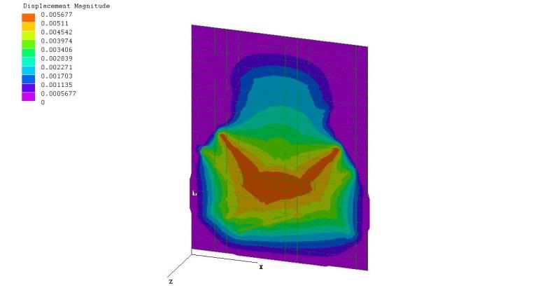

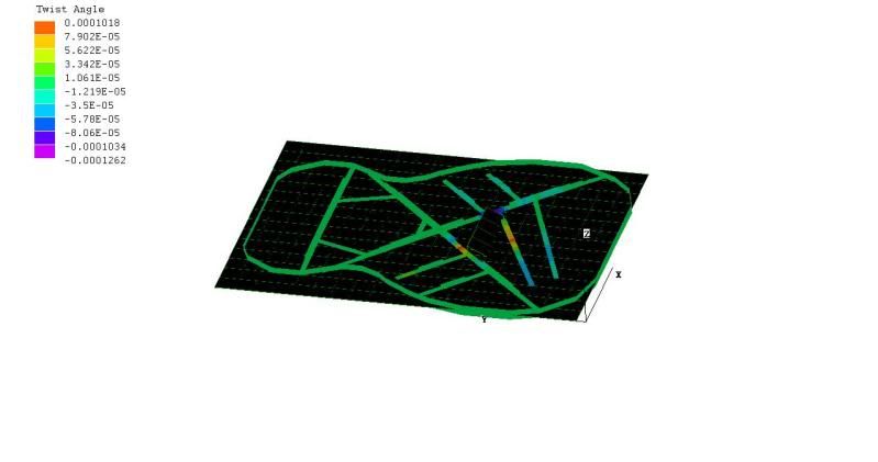

I got similiar results with my model, which has less refined elements than Jim's model. It wouldnt' take much tweaking of geometry and materials to get extremely close to the same results.
One difference with my results is that it shows a pull at upper fingerbraces. I could see the same pull on a guitar that I had handy at the moment. (although perhaps a bit less than the model shows.)
Displacement data.
What the model looks like.
Thanks for posting your results, Jim. It saved me a lot of time trying to figure out if I should believe what my model was showing.

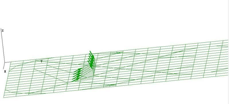

I'm using 180lbs for total string tension.
The way I see it:
The string tension applies forces at two places on the top. The string anchor point and the saddle.
1) At the anchor point there's an upward force and also a force parallel to the top towards the neck. I've been using something like a 27 degree break angle (angle of string to top) to resolve the forces.
2) At the top of the saddle there's a force parallel to the top and towards the neck (the obvious string pull force) but much of that is balanced by the string tension from the anchor point to the saddle.
The string tension from the anchor point to the saddle also puts a downward force on the bridge.
I haven't dialed in neck angle as I don't think that I have things precise enough for that to matter much.
Here's a picture of how these forces resolve when they are applied to my model.
I've played around with my model some more and it doesn't take much tweaking to get under .004 max displacement and when I did that I got rid of a lot of the rise in the forward finger braces.
