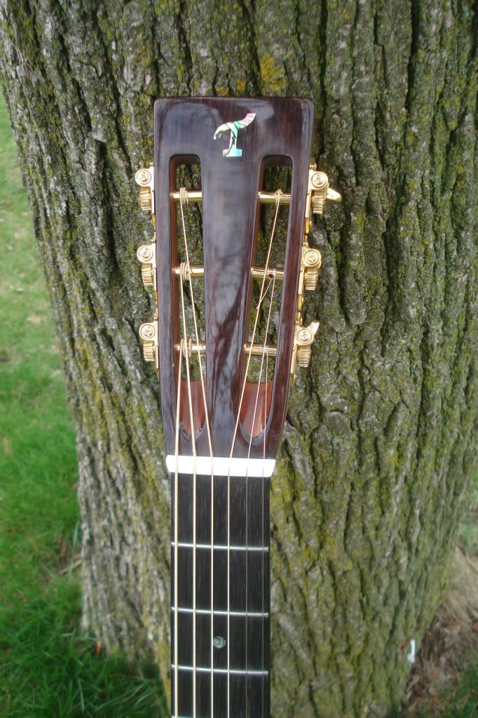

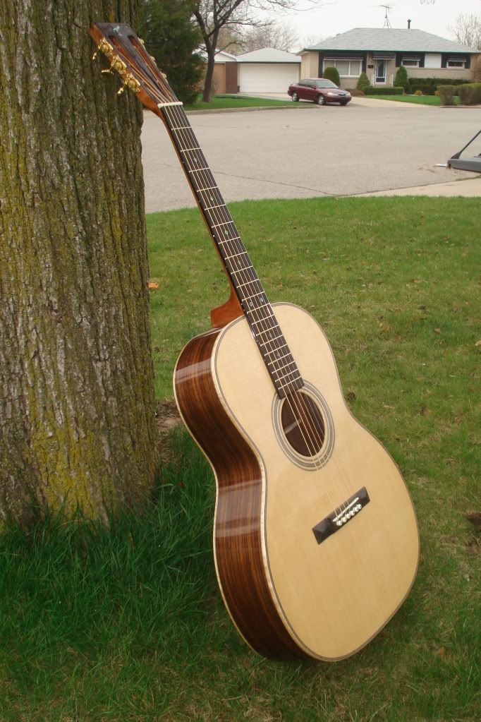

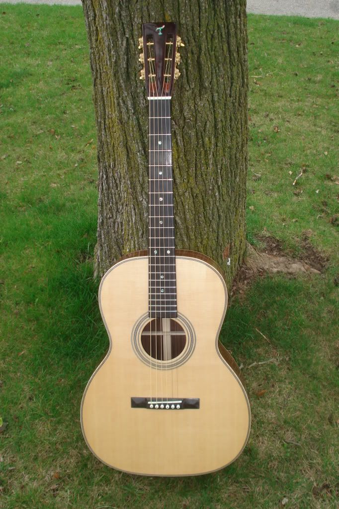

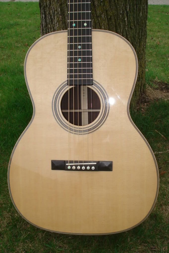

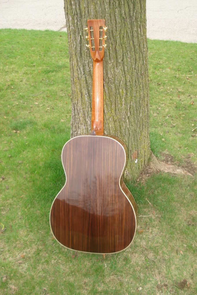

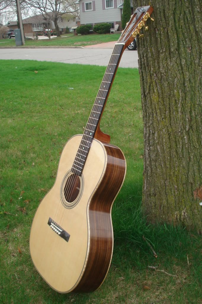

I strung up #7 the 12 fret 000 Indian Rosewood back and sides, Sitka Top, Herringbone and Curly Maple trim la week ago and finally got around to taking some pictures. It plays and sounds real good and everyone who has picked it has been impressed. Number 6 is getting the dovetail neck glued on tomorrow and the bridge Thursday, I should be picking a tune by the weekend.

Fred....that is a very nice looking guitar!! What finish did you use?

The finish is Nitro Lacquer with shellac sealer over Z-poxy grain filler.
#7 passed 6 while the lacquer was curing they were built together and sprayed at the same time and both buffed together. I just decided I wanted the 12 fret 1st so the Bubinga wedge had to wait.

Great looking guitar Fred; 12 fretters with slot pegheads are my favorites!

But, illusion, or something wrong with the soundhole?

There is nothing wrong, though the camera angle makes it look like the back center seam look of center through the sound hole if that is what you are seeing.

That is a beauty, Fred. The bridge is a nice touch, too. I spent a couple of months trying to come up with a way to make nice, crisp lines on the pyramid parts, and never got to where you are. Nicely done.

I love the slot head and the volute. What technique did you use for that volute. I haven't managed to figure that one out yet.

I can't take credit for the bridge it is a CNC cut one I purchased.

That's beautiful rosewood with gorgeous earth tones Fred. Love what you’ve done with it.
