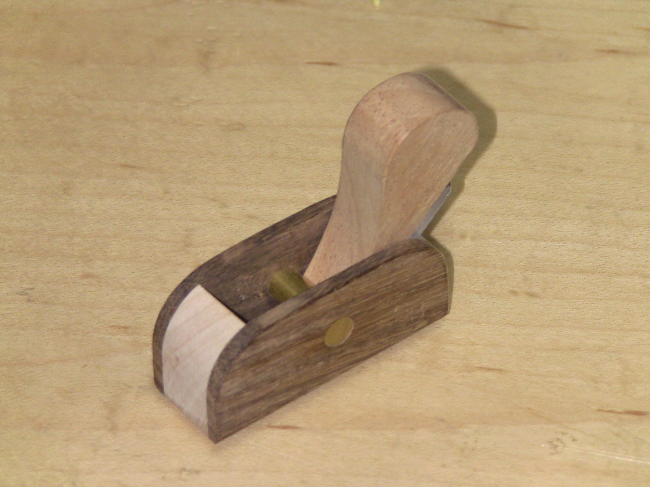

Last week I decided to try out one of Stephen Boone's small planes after hearing about them here on the OLF. The planes are available through Tracy at Luthier Suppliers and here is a link for your purchasing convenience: http://www.luthiersuppliers.com/products/p13.html
First this is a totally unsolicited testiclemonial in that Stephen and Tracy have no idea that I am doing this. Nor did I receive anything for my posted opinion here - I paid full price for my plane.
My plane arrived today which was pretty amazing in and of itself because I ordered it late last week and it came from Montana along with the Pygmy Pony and the dental floss (sorry I digressed.... again....).
My first impression is that the plane is superbly crafted with a tight fitting mouth and excellent craftsmanship. These planes come fully hair-popping sharp right out of the package and are ready for immediate use.
My style of building has me doing most of the carving of my braces with a finger plane. To date the Ibex 12 mm has served me well but I do find these things rather uncomfortable if using it for an extended period of time. I have also been less than thrilled with the hard edges on the sides of the soles which require me to use protection... for my tops.... :?
My new plane is super sharp, VERY comfortable AND has a big bonus that I did not expect or notice prior to ordering. If you are a cube rule fanatic or a fan of Somogyi and you toil endlessly.... to remove excess material and mass from the sides of your braces these planes are your answer. I am not sure that the angle is but Stephen has incorporated angled sides for using the plane on an angle to shave the braces into triangular shapes!!!! I just tried mine out on a top that I had previously thought that I had removed all of the excess side material from the braces and low and behold this plane easily removed more material that the Ibex could not reach.
Needless to say I am very impressed and this is now my primary brace shaving plane - HIGHLY RECOMMENDED!!!!!

Thanks for the pics and 'review'.
Does that plane have a toothed blade? (Looks like it in the 'rear-view' pic..)
Also, how easy is it to adjust the depth of cut? I've found this a problem with all my small planes, so much so that I have several I just keep 'pre-set' for given depths of cut.

I agree they are great little planes!
John, you can just put a piece of paper under the front and push the blade down and this seems to work well for setting the blade.

John buddy it's a standard blade and the black lines that you see appear to be ink.
I just used Edward's method for adjusting the blade and it works great - thanks Edward.

Yep, I really like mine. It's also great for fine tuning small pieces of wood. I don't even use a piece of paper, I just sit mine on the bench, seat the wedge and it's ready to go. It's real easy after you use it for a while.

Those are great planes, Hesh. I've got two of them. One square and flat. One he did for me with a curved bottom for scalloping braces and tapering the ends. Love them both! Really sharp. Well set up. Don't clog up like the ibex do. Much easier to hold.
I've been meaning to order one of those with the angled sides, but haven't gotten around to it yet.

If you want a curved bottom plane just send a note with your order to Tracy and I can make it up. Note however that I do not curve the blade edge itself because I find that it is just not needed on such a small scale. I actually used my flat bottomed one to scoop out my solera so it is small enough to do some work like that. The curve I put on the bottoms of the planes is pretty shallow but it is effective. If you want to curve it more after you get the plane it is pretty simple to round it a bit more, you just want to avoid the area just in front of and behind the mouth.

I love mine. I bought one several months ago, when they were first announced. Great little plane. I actually ended up easing the front and back a bit, but leaving a flat in the center, which allowed me to use it on my scooped braces, and didn't change the way it worked on straight fans. Very nice little plane.
