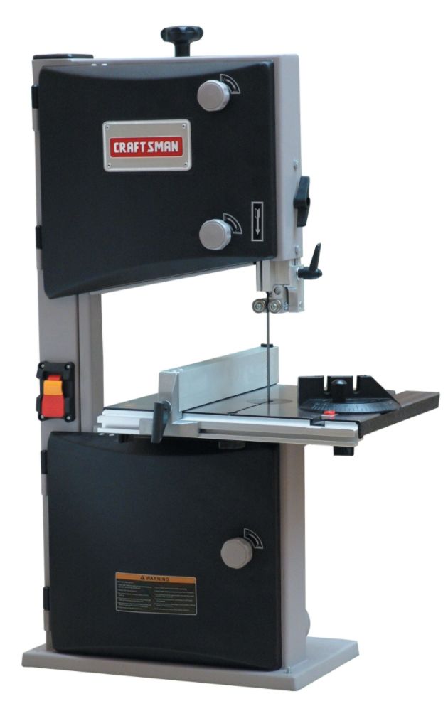

Does anyone have recommendations for 10" band saws ? Preferably in the $200 range.
I am considering a 14" Delta - but I am not sure I want to go that large in my garage, just yet... may be after a few guitars. I like the idea of resawing wood.
On a 10" I maybe able to resaw 5" an under stock, and make 3 piece or 4 piece backs - which is fine with me. I also want to be able to make and cut my own bind and purflings. And my table saw is a contractor model and sucks, and frankly I dislike that machine more and more due to the potential danger factor, of course realizing each machine has a danger factor - just the table saw seems like more.
Any recommendations ?
I was thinking along the lines of the Craftsman (which I think is the same as the Rikon) -- good reviews on it -
or the Hitachi - but I have been reading bad reviews about it -
thx !

I love my little Craftsman/Rikon, it does great if you use good quality blades (Timberwolf from Suffolk Machinery). The only thing I've had go bad is the thrust bearings, and those are available cheaply since they are just regular skateboard wheel sized bearings. I've cut through 3" thick mahogany with mine.
That said, it doesn't take up any less floor space than a 14" saw. I'd definitely prefer a 14", but my shop is an upstairs spare bedroom on a 100+ year old house so I have to watch the weight and power requirements.

Quality blades of any custom size can be easily ordered online for a reasonable price, and will be better than what you could buy off the shelf from Sears anyway. I didn't even bother with the stock blade. http://www.suffolkmachinery.com
The Sears/Rikon really is a step above most other small saws and is a pretty good deal for the price (at least if you get it on sale). It's got a nice sized cast iron table and that makes a big difference in how solid it feels when you're using it. I picked up mine as an open-box item for $105.
I had a Ryobi 9" and it did OK but wasn't near as sturdy. I bought the Grizzly 9" and never really even used it and it is to date the most disappointing tool I've ever bought. The saw itself was sturdy but the table was complete garbage. It was impossible to get the table to stay tight.

I have the 10" Craftsman and love it. It is a nice little saw. You'll have to replace the guide bearings, with sealed bearings pretty fast, but you can get bearings from MSC for pretty cheap, that work fine. Buy your blades from a place that sells custom lengths. I buy mine locally from a place called Carlotte Saw & Knife, and they will weld 1/4" blades to the required 70 1/2". The Sears blades aren't bad, but not as good as the Lenox blades. I looked at this saw and the Rikon, and went for the Craftsman. I didn't like the grooved aluminum table on the Rikon, and this saw has a nice cast iron table, which gives it a little bit of weight. Consider blades as a supply item. They will break, but in my case if they break at the weld, my guy will re-weld for free, and they always do.
Check out this place. They even have a carbide tipped 1/2" blade .025 band, 3 tpi for $93.00. I didn't even know you could get them. They have all the other Lenox blades too. http://www.toolcenter.com/070_5_Band_saw_Blades.html

I have the Craftsman (Rikon) and it's a nice little saw. I use it a lot for cutting out backs and tops, plus other smaller parts. I also have a 14" saw and an 18" saw in my garage, but I use the 10" that is in my "inside shop" (converted bedroom) a lot.
As mentioned earlier, you can get Timberwolf blades from suffolkmachinery.com.

I've got one of those Sears saws. It's definitely way better than other small saws I've used. It also is clearly a small saw. I like mine and use it a lot, but I am frequently reminded that it is not a big saw.
Don't waste your time with the Sears blades. Suffolks are good and they make whatever size you want for cheap.
One other thing about the sears stuff. It's not just the blades that are special sizes. I have a bigger craftsman saw that needs a motor. The ONLY motor I can find that will fit is the Sears motor. Unfortunately, they're back-ordered indefinitely.

Just for fun, I was cutting a piece of Sp Cedar today on my Sears 10", and it was 4" thick. Worked fine. 1/4" 4 tpi blade. A bigger blade would have been better, but takes twice as much set up. I can swap out 1/4" blades with minimum adjustments. I use 10 tooth, 6 tooth, and 4 tooth wood blades and 10 - 14 and 14 - 18 bimetal, metal cutting blades, and swap them around a good bit, depending on what I'm doing. The bimetal blades are great for purfling and binding, and fine trimming.

Looks like it will be the Craftsmen for me. Not sure how the Delta 14" would go over "politically" at my house just yet... :oops:

I also recommend the Craftsman 10". I have a really small shop and a 14" is out of the question. Although it is heavy, I can move it from one table to another lifting very carefully to prevent back issues. Yeah, it has limitations, but it is much better than not having any band saw and trying to cut things by hand. I have found I can cut lumber for neck blanks, cut neck scarf joints, head blocks, tail blocks, and endless small bracing parts. And the dust is very easy to control. I don't know how I lived without it before.
