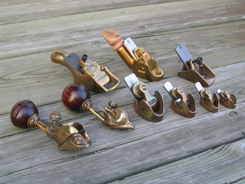

Why don't you try to make your own planes? It's really not that hard, good practice for instrument work, and best of all, cheap! I don't like the steel in those Ibex planes much, I believe they are chrome vanadium. My favourite finger planes have irons cut from old bench plane irons. Here's one I made from instructions in Irving Sloane's book years ago, it still works fine. The iron is about 16 mm or so, but narrower on the top because of the geometry of the Stanley iron I cut it from.

I really appreciate everyone's input. I'm really interested in making my own planes. I wasn't before but seeing peoples' pictures make me want to try it. What is the best source for blades, and are there any especially good schematics or patterns online?

There is an excellent article on making Brass Planes in the Spring 2007 American Lutherie (#89), by Ken Altman.
