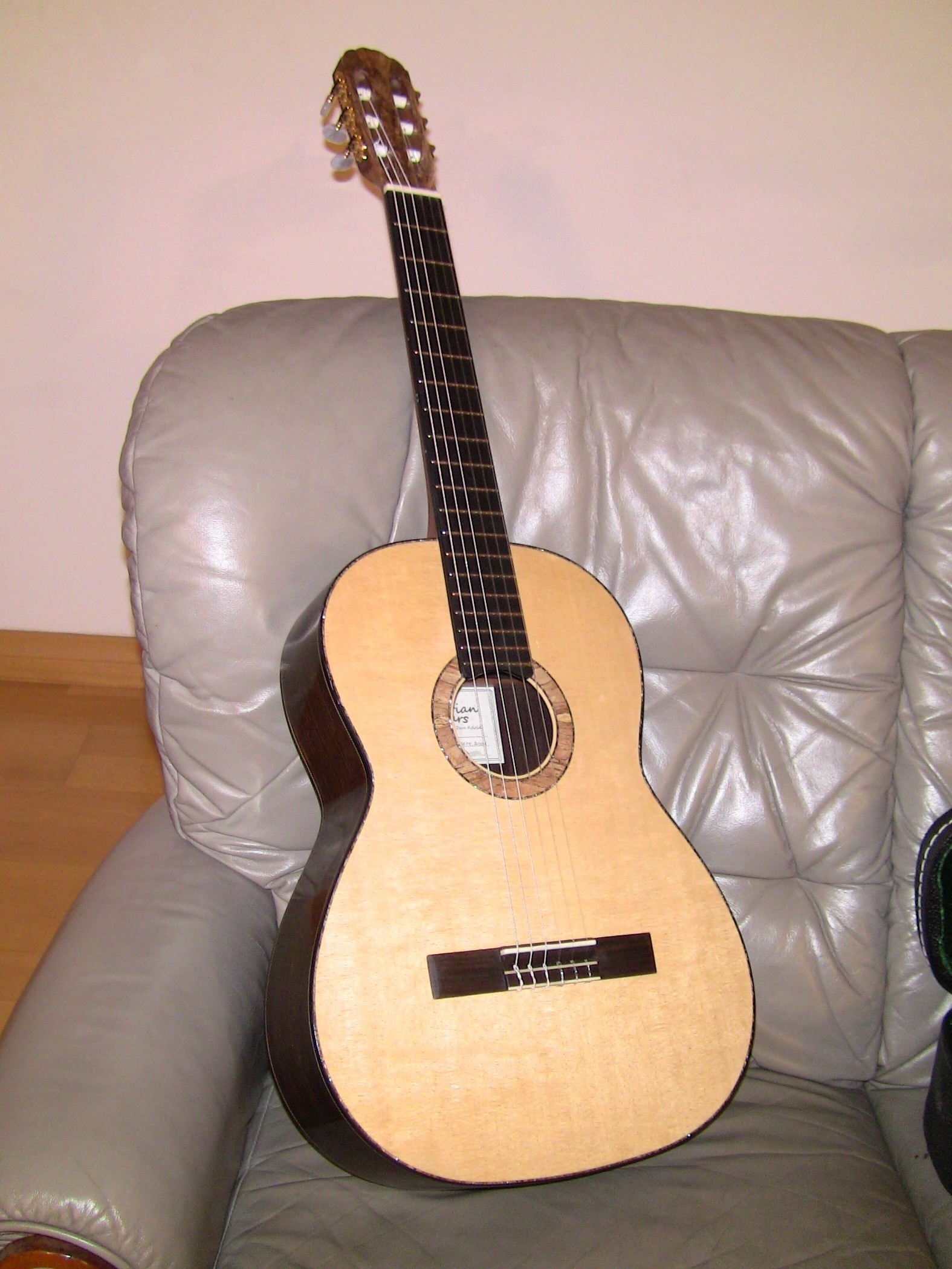

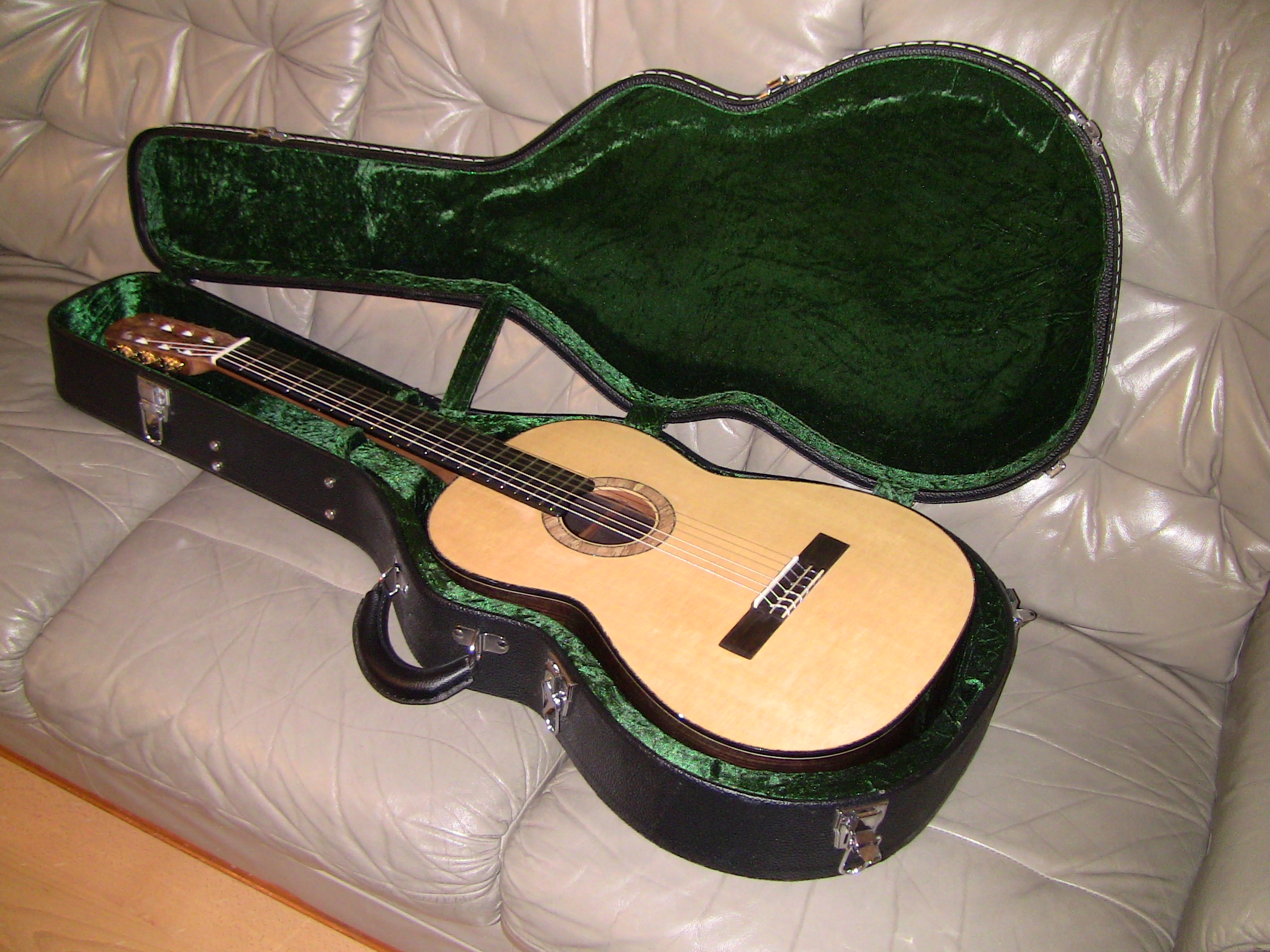

I finally got my first classical guitar built, finished nicely (after an abortive first attempt I had to sand it right back to bare wood and start over [headinwall] ), and all strung up and setup properly, ready to deliver to it's new owner tomorrow! I think she'll be pleased - it sounds really nice to my ears - seems to have good even tone across the whole fretboard, and is plenty loud enough :D

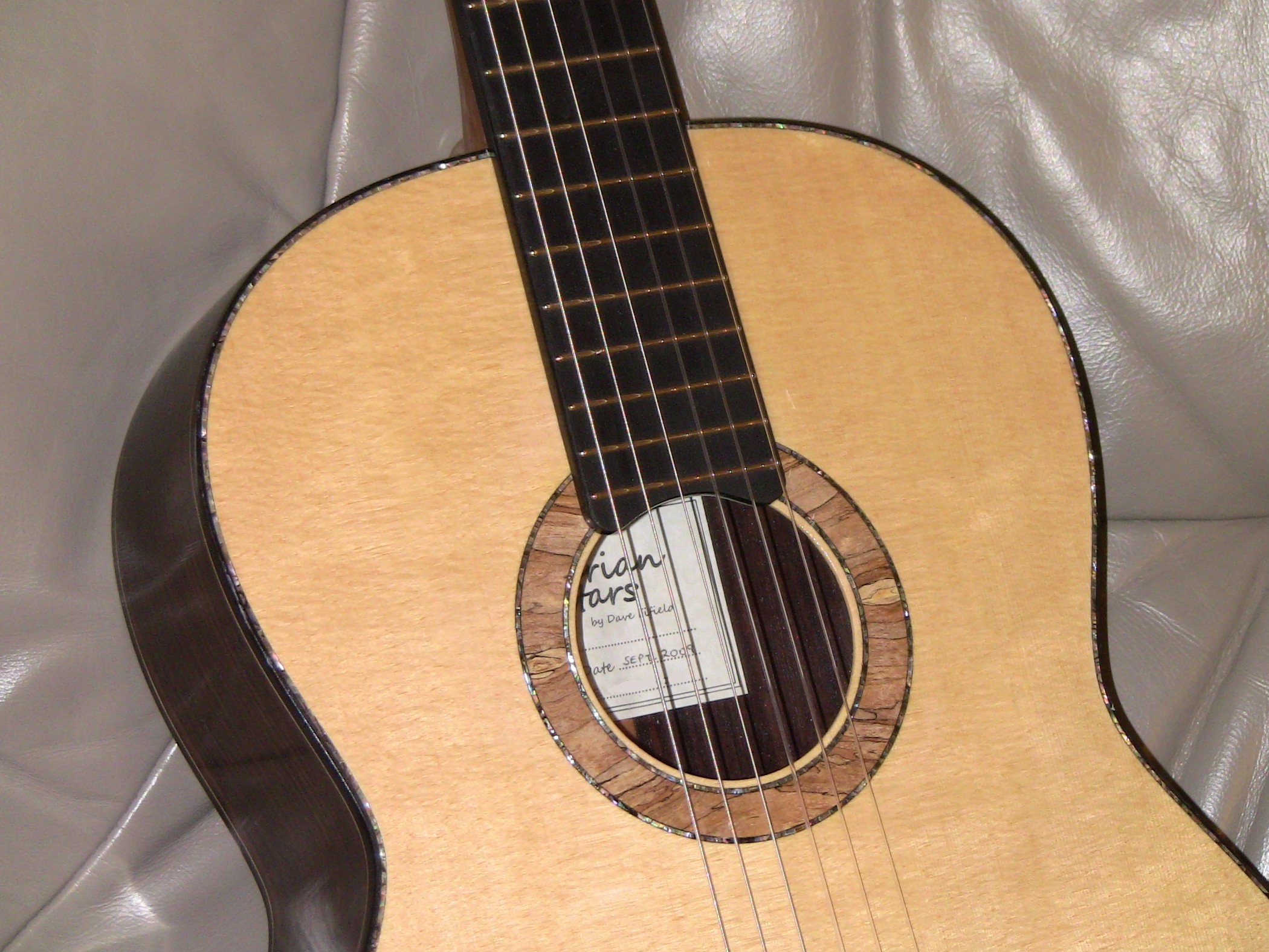

I call it my model HD-1 (Hauser Derivative #1) since it's based on the 1937 Hauser shape with some John Bogdanovich inspired adjustments to the design. It has a mortise and tenon bolt on one-piece mahogany neck (with a carbon fiber rod in it) that's disguised to look like Spanish heel construction, body built in a dish rather than on a solera, EIRW back and sides, spruce top (I forget whether it's Engleman or Lutz now....either way, it's a truly wonderful soundboard), ebony bindings, ebony fingerboard, BRW bridge, spalted maple headplate and rosette, zipflex blue paua purfling back and front and around the rosette, Schaller tuners, D'Addario strings, Z-Poxy fill, Enduro pre-catalized urethane finish.
Click on the pictures to see the high-res versions. Enjoy.
I'll try to get a recording of a real guitarist playing it and put it up in this thread shortly. Thanks for looking.

Beautiful work Dave !!! Very nice and the zipflex sets off the ebony binding quite well. The rosette looks great and the silking on the top is beautiful. Nice wood selection and keep up the great work.

Dave, it's beautiful and exciting. Congratulations! I love the rosette and bearishclaw top.

That rosette is among the most gorgeous I have seen. Great looking guitar.

Love the rosette as well - that is inspiring.
