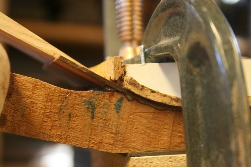

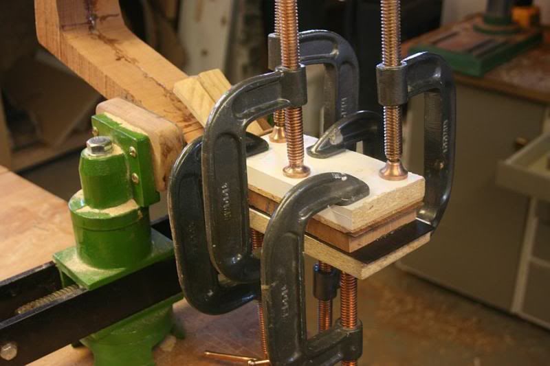

Detail shot of the glue up sandwich. The back veneer has a cork lined caul which matches its curve. For good measure I jam a couple of wedges in there to make sure the back strap gets sufficient clamping pressure. The glue squeeze out is reassuring...
So, there it is, all clamped up

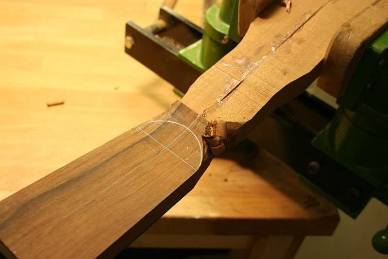

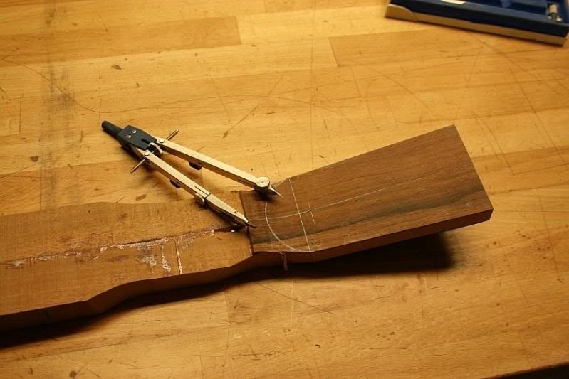

After shaping the headstock outline, it is time to work on the volute. I start by drafting the shape with a compass. No jigs or anything for this, so they turn out a little different each time, which is OK by me.

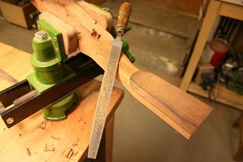

Removing the bulk of the wood with a sharp chisel
Rasping with the Nicholson #49 (or is it the #50?)
Some more rasping...

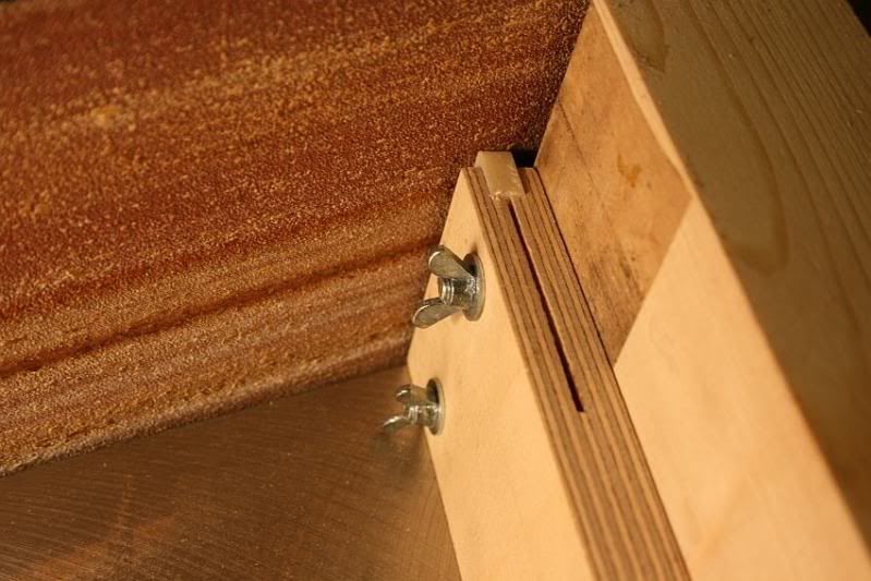

When I remember, I like to put in the nut when I shape the neck. It ensures a perfectly fitting nut, and keeps the fragile edges around the nut slot intact. Here I’m trimming the headstock veneer back with a guide caul.
Shaping the nut bottom to fit the headstock angle. I made this nut holder to save save my fingertips from that merciless belt sander

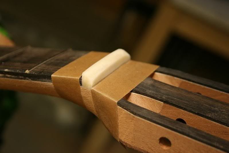

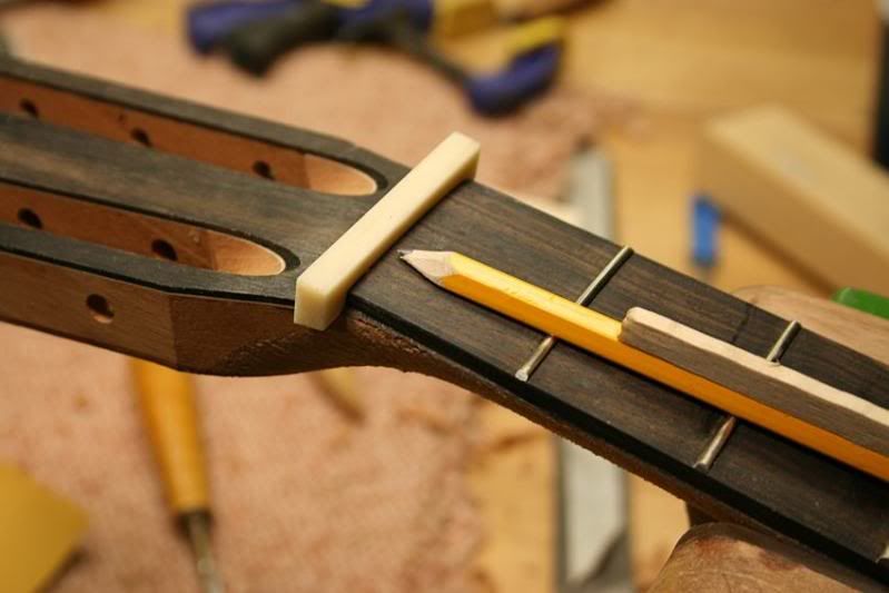

With the nut it place, I trace the fret position and all surrounding edges on it with a half pencil.
I then rough shape the nut around these marks on the belt sander again, before it is temporarily glued in place. The tape is there protect the headstock and fingerbaord edges.

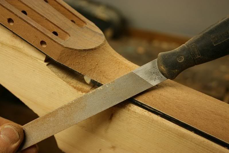

With all the rough shaping of the neck done, I use a file and finally sandpaper to blend in all the surfaces.

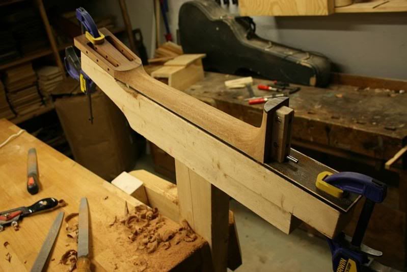

Here’s my neck holding fixture, which I clamp in my bench vise.
The nut and headstock almost done
The whole thing.

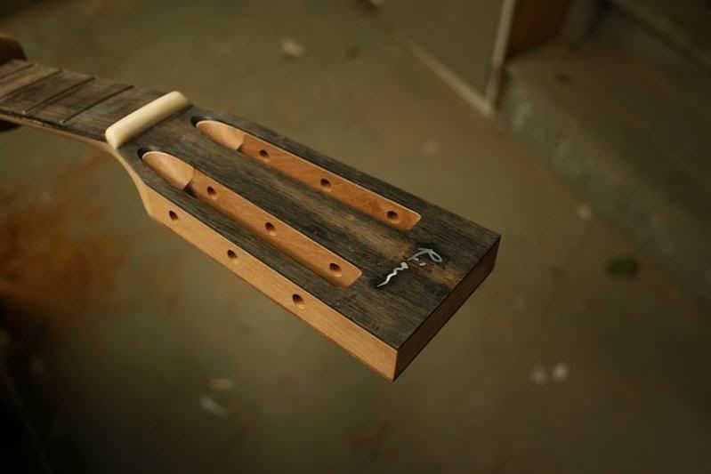

Here’s a picture of a finished, but different headstock, done the same way.

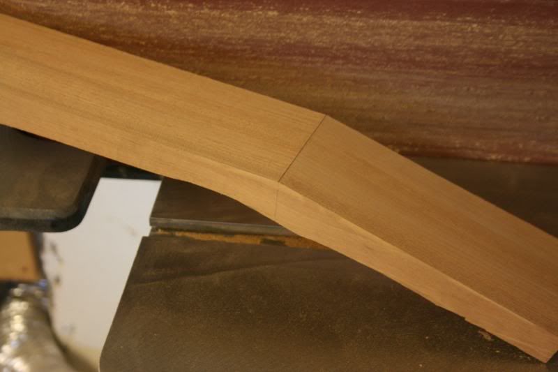

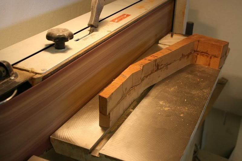

The headstock / neck transition is shaped on the idle drum end of my long belt sander.
Lastly things are smoothed out with a scraper.

Fitting a nut before the final shaping of the neck is always a good idea. It saves the fragile edges of the neck around the nut from tear outs, plus you get a perfectly fitting nut.
Shaping the neck with a large rasp

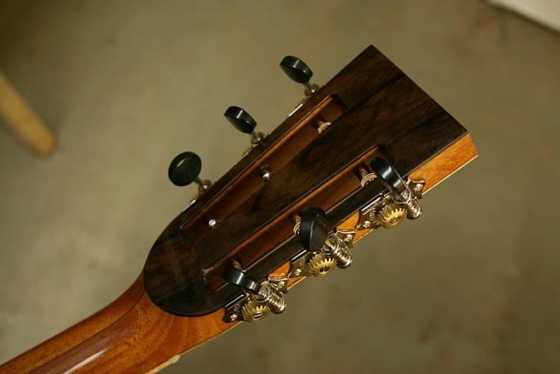

Back of the headstock, almost done, strung up "in the white".

After gluing on the veneers, I thickness the neck by running it under the Safe-T planer. This also levels the back veneer with the neck shaft.
Here I am cutting the headstock outline on the band saw. You can barely see how the backstrap extends down the back of the neck. Wish I had a better picture, but I think you get the idea.
This picture shows the neck being glued to the body, but you can also see how the backstrapping looks at this stage, when this part of the neck still has the rough marks from the band saw, and has yet to be shaped with a rasp.

I've done 'volutes' just the way you describe. Works great. (You can use leather on the clamping caul, as an alternative to cork.)
