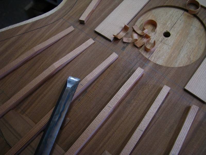

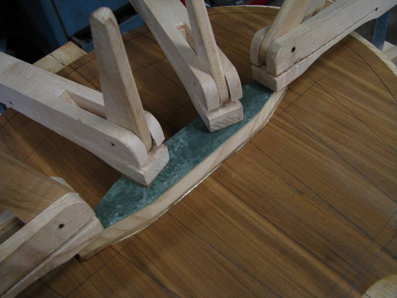

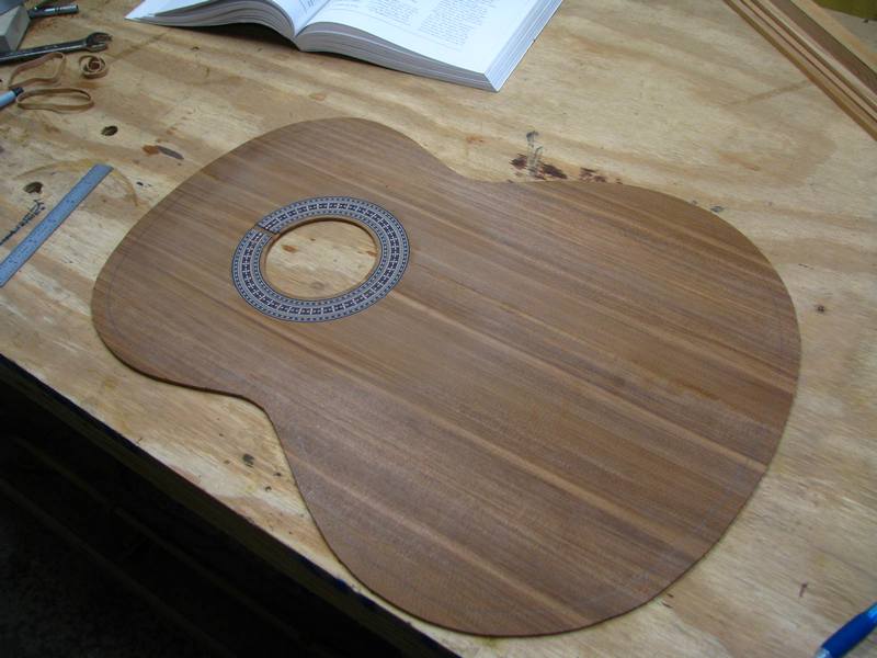

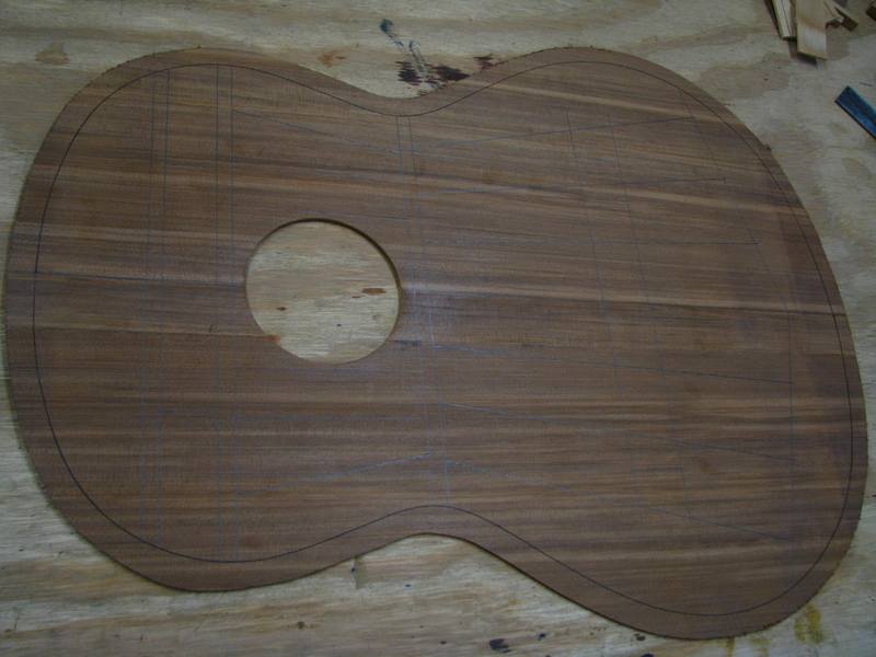

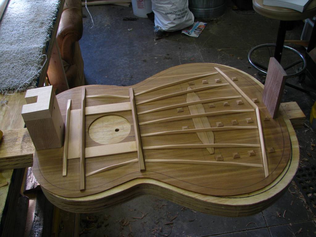

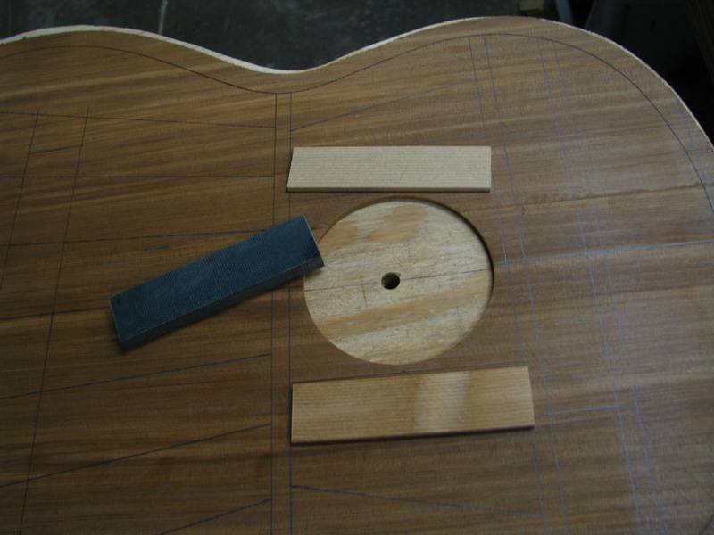

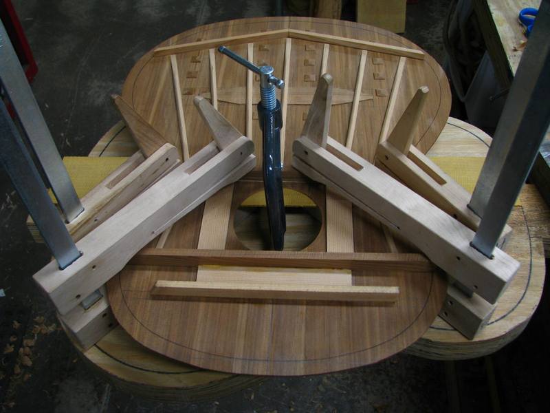

I just started my third guitar project, and thought I'd share some pics. I'm sure most of you have seen this sort of thing before, so if you're tired of looking at pictures of guitars being built, say so and I'll go away. (Just being facetious; if we were tired of guitars, we wouldn't be hanging out on THIS forum, right? :mrgreen: )
Anyway, I didn't think of taking pictures until I had the rosette finished, so I'll have to start off with the top trimmed to shape (1/2" oversized, of course) and I'll describe the way I made the top, since it was a little unconventional.
BTW, I'm building a classical guitar here, in case that's not obvious...
Since this is a hobby, and not a business (yet) I try to keep costs down by using locally available materials, and preferably stuff that grew on my own property.
For the soundboard, I opted to use western red cedar, which I bought at Menards in the form of 4x4 posts (used for decking and stuff). You might have to dig through the pile, but they do have stuff that's clear, straight, and quartersawn. [:Y:]
So, I cut off a section of 4x4 22 inches long (wasting the end, which can have staples in it [headinwall] ), then run it through the 6" jointer to make sure it is straight, then cut off slices about 3/16" thick.
Then I joint the edges again, and glue the pieces together. I had to use 5 pieces to get the width I needed, so I made 2 sections, one with 3 pieces, one with 2 pieces. Then I run the 2 sections through the planer. My planer is supposed to only go down to 1/8" thick, but it actually went a little thinner. [:Y:]
Once the 2 sections were planed to thickness, I glued them together. So the top has 4 seams, but they're virtually invisible.

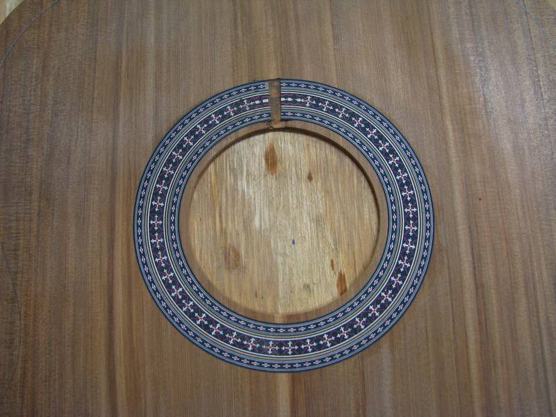

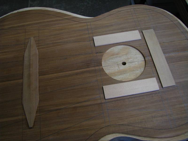

The rosette:

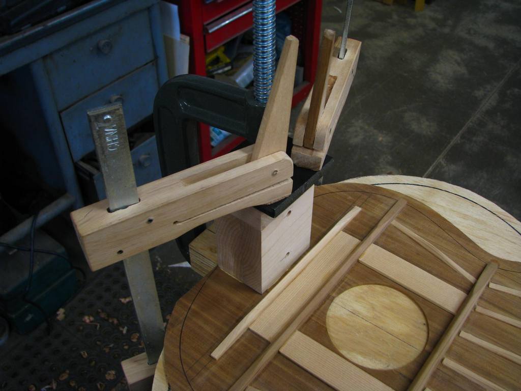

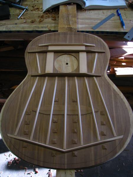

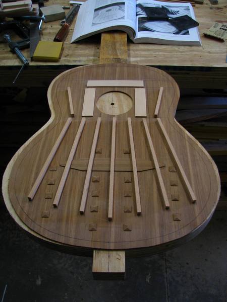

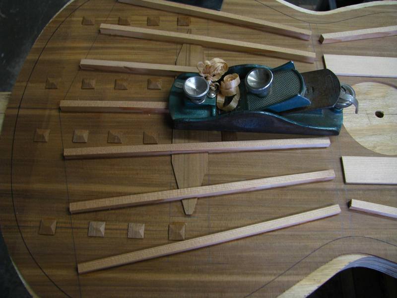

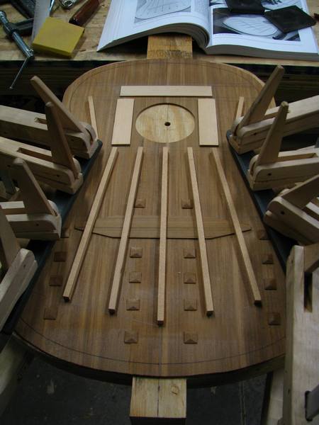

The brace pattern layed out:
Gluing on the braces:

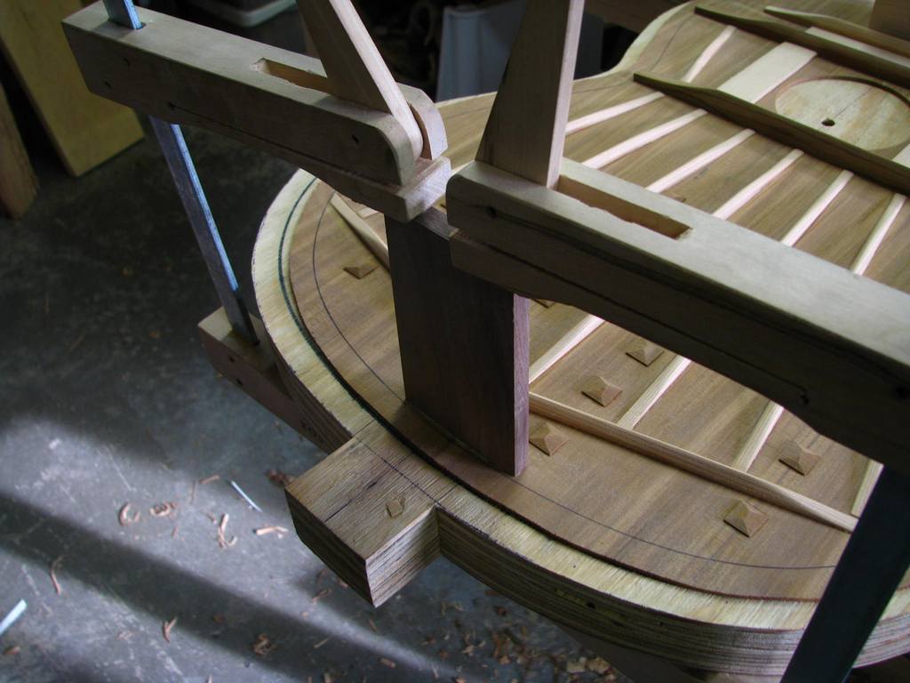

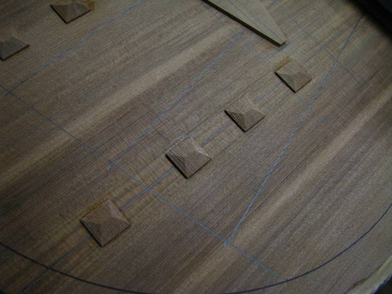

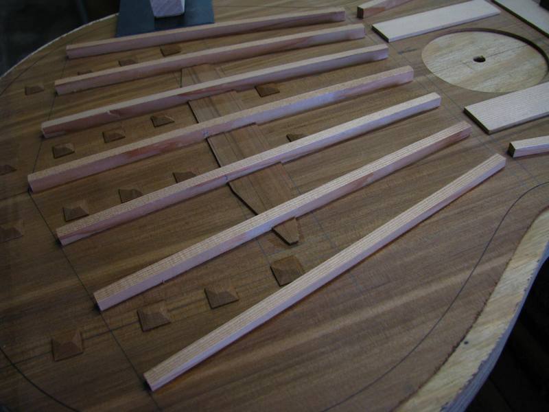

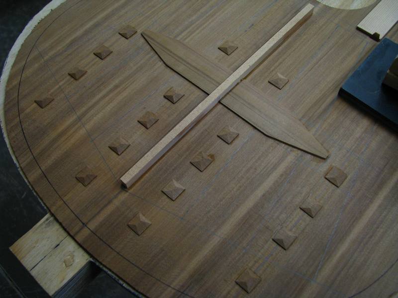

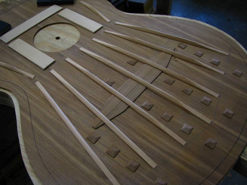

Usually, with a 2 piece top, the middle fan brace is glued right on top of the centerseam. In this case, that didn't work, so I made little crossgrain squares to strengthen the seams:
I carved them into pyramid shapes:
Then finished gluing on the fan braces:

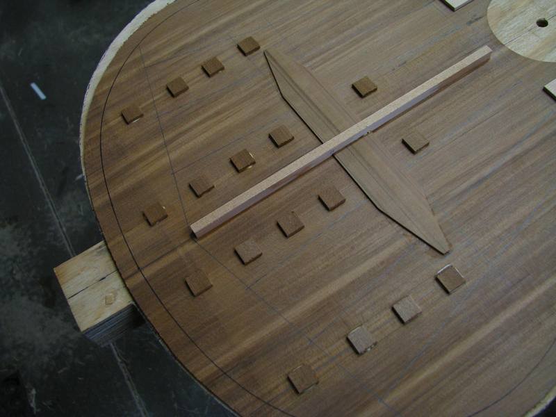

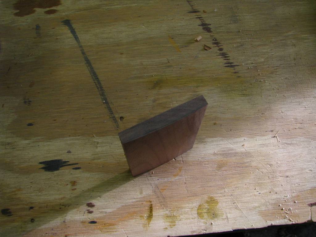

I like the cross grain squares on the joints . was that your idea , or has that been done before ? Also great job at using local lumber . Very Impressive so far
PostPosted: Fri Jan 01, 2010 10:32 am
Joined: Sun Dec 27, 2009 2:59 pm
Posts: 458
Location: Northeast Indiana
First name: Phillip
Last Name: Patton
City: Yoder
Zip/Postal Code: 46798
I got the idea from Cumpiano's book. I think he used them on the centerseam for the steel string soundboard.

Nice so far. Did you buy the rosette or make your own? I like it alot.
Good luck on the rest.
matt
Thanks!
I bought the rosette from Stew-Mac. I'm sure I'll try making them myself at some point, but not now.

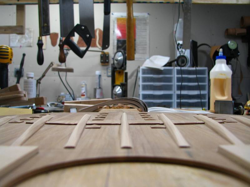

More pics of the bracing:

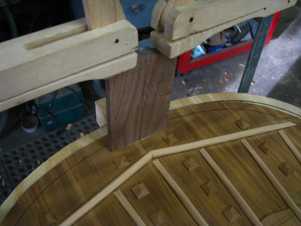

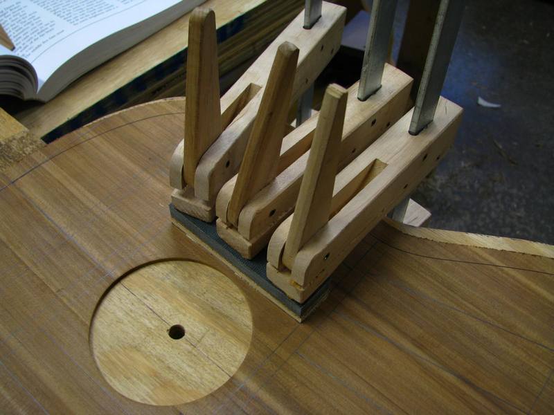

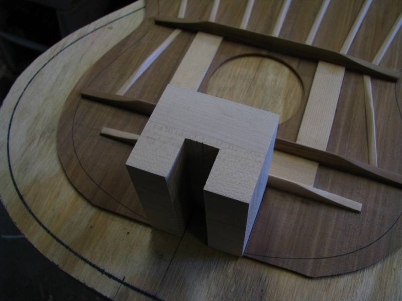

With the head block and tail block glued on, the top is now ready for the sides, which I haven't started yet.
Does anyone have any suggestions as to what I should use for the back and sides? I was planning on using some curly hard maple that grew around here, but it seems like I should use something darker to go with the soundboard. Is staining the maple a viable option? I like stained maple, but in the past I've had issues with stain running when lacquered, and that's a pain... There's some other local woods I could use, like walnut, and oak.

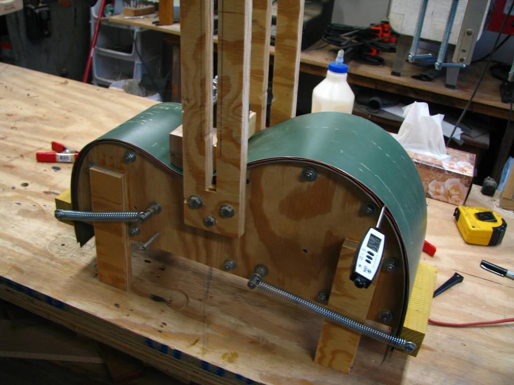

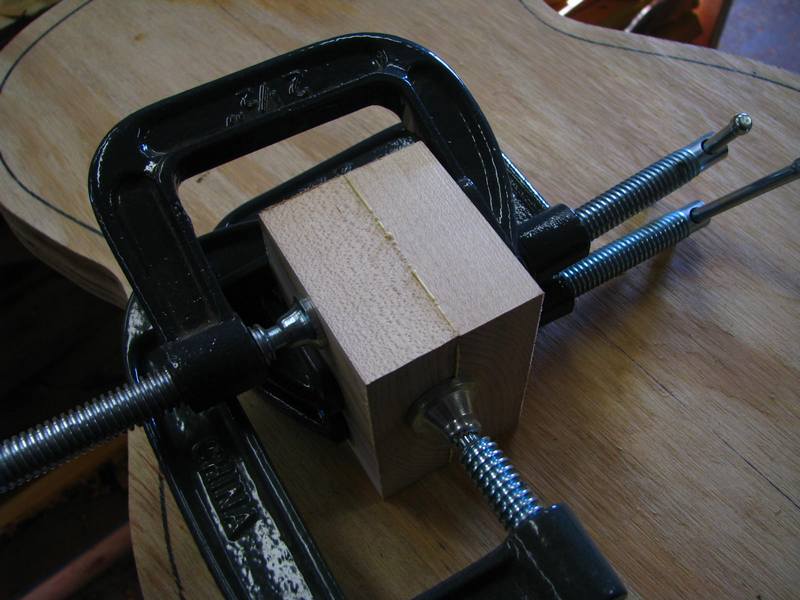

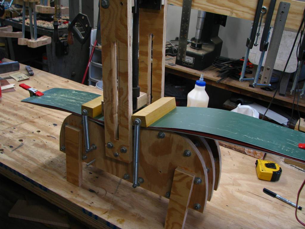

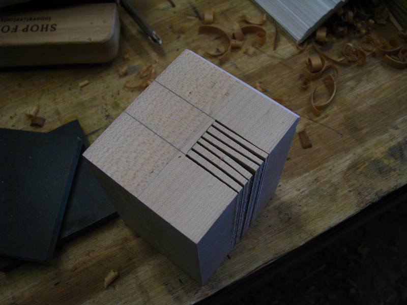

I haven't been working on this lately, having been distracted by stupid stuff, like making money so I can keep the electricity from being turned off. ;)
But, I just had some of my locally grown curly hard maple resawn and thickness sanded, so I'm going to get working on it again.
I picked one of the lesser quality sides to practice bending. If it goes well, I'll do the real thing tomorrow.

Why no tapering at the intersection of the cutoff braces?
Build log
PostPosted: Fri Feb 05, 2010 10:59 am
I was wondering that too! Also, I'd love to know the thickness of the top and the height of the braces. They look pretty sturdy, but I could be way wrong, as I'm used to narrower, taller, braces on my builds, using Spruce.
PostPosted: Fri Feb 05, 2010 11:19 am
Posts: 458
First name: Phillip
Last Name: Patton
City: Yoder
Are you referring to the two braces that form a "v" at the ends of the fan braces? If so, I'm not sure. Since I don't have much experience of my own yet, I'm following the instructions in Cumpiano's book. He says to use a butt joint between the braces there.

I'm not sure what the thickness of the top is. I'll measure it next time I'm in the shop.
It is thinner than the spruce tops on my first two guitars, which is why I'm leaving the braces a little heftier. So far, tap tone sounds good, but then I'm not sure what it's supposed to sound like. :? :)
My purpose in posting my progress (besides having fun) is so you all can tell me what I'm doing wrong, so any input is appreciated.

PostPosted: Fri Feb 05, 2010 12:21 pm
Location: Bucharest, Romania
Country: Romania
Yes, that's it. I don't have Cumpiano, but on all "famous plans" they are tapered exactly the same as they are tapered at their other end, down to nothing or app. 1mm. Best is no to butt then right on the joint (not your case here, but when doing a regular 2 piece) but to cross one of them over it.
Well, if it's important, it's not too late to feather them. What's difference would it make? I suppose the top would be a little "looser" without the butt joint?

PostPosted: Fri Feb 05, 2010 3:34 pm
Country: Romania
Yes, it would become a wee little looser. I would imagine the change would be small and would not alter the character of the guitar, but it would at least "look right". Now, if your top+bracing are already loose to the lowest acceptable level, then further work on those brace can affect the sound in a negative way. You should be the judge of that. I am definitely not going to consider myself responsible if the guitar turn out a dud oops_sign
Or maybe if you leave it as is and it sounds fantastic, you can call it the Patton bracing :D
The fan braces look plenty stiff to me (mine are just half in volume for example with a spruce top) but you said the cedar plate is thin....
Build log
PostPosted: Fri Feb 05, 2010 7:06 pm
I, like Alex, don't want to talk you into making a dud, but just for comparison purposes, here is the top that I just took out of the solera. Remember, it is Spruce, and pretty stiff, but it is 2.4 mm in the area around the bridge and into the upper bout, but tapers to 1.7 - 1.8 at the perimeter of the lower bout starting just above the waist. The fan braces are 3 mm wide, and vary from about 6.5 mm in the center to 4 mm on the outside. The closing braces, such as they are, are about 3.5 x 3.5 or so. Not saying this is right, but this top will be plenty stiff for a classical top, and is probably a little stiffer than my last one. I would assume that your top should be at least 10 to 20% thicker, depending on the stiffness of the Cedar. My body may also be a little smaller than yours. I'm only about 14" wide at the wide spot of the lower bout. I would think tapering those closing braces might open up the bass a little on your guitar. Much of the bass response comes from that area between the bridge and the tail-block. However, if you are building to a plan, you should probably stick to the plan. This is just food for thought!
