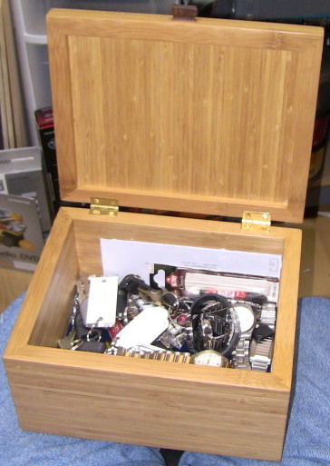

I saw a cutting board that might be big enough for a ukulele top if you can re-saw it.

Southern Lumber near me sells planks of glued up bamboo that are about 8" wide by 3/4" thick by 5' tall. They aren't too expensive. I've used the stuff for jewelry boxes before. It's pretty hard on the tools, and splinters easily, but it looks great under finish. I may grab another plank next time I'm over there. If anyone wants me to grab some and ship it to them, PM me. Here's a photo of a box I made using the stuff:
A full plank would resaw pretty easily into a good-looking top and/or back/sides IMO.

You can easily purchase bamboo stair treads and risers. Just google "bamboo stair parts" You can purchase either vertical or flat grain - and in natural or caramelized colors. Resaw the stair tread like you would any other board
