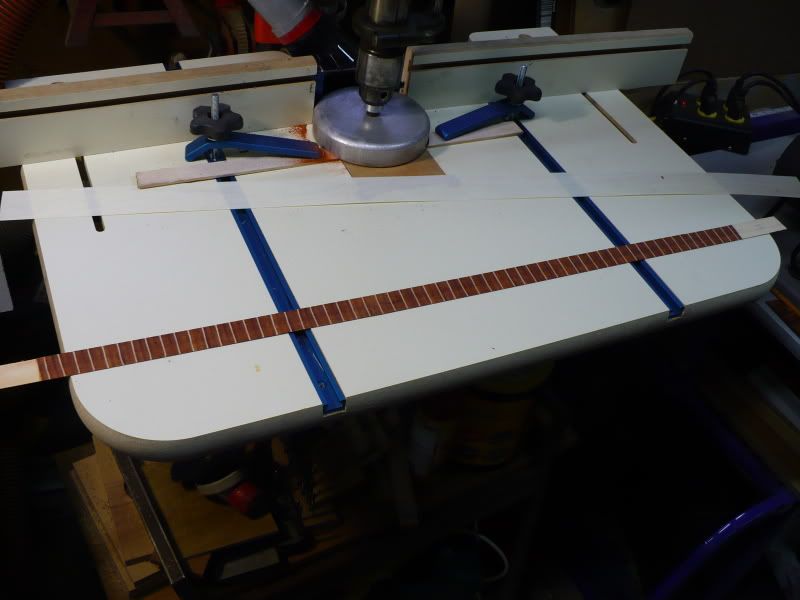

Filippo, that's a beautiful setup! I just bought a bunch of T-Track and various hold downs to re-do my band saw table, make a mini sliding table saw (rather than the relatively crude sled I've been using), and now that I see your drill press set up, I'll virtually copy it. I had planned on something simpler, but I can immediately see the benefits of your setup.
I notice that you did not buy the special intersecting track pieces (or cut them yourself) - and I realize that sliding a miter fence is not something typical that would be done on a drill press, but have you ever had an instance where you wish you had the open intersections?
Thanks for the photos - worth 10,000 words.
