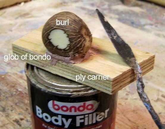

This thread is for them that just don't get bondo.
Every so often I'll add a pic or two of what bondo is all about.
So here be the first....
Is small, odd shaped, and you need slices of off it, or gotta drill it or whatever you gotta do to it that may be too close for finger comfort...well you use BONDO!
see pics.
Get it yet?

whats burl and what is it used for?

That was a Tagua(sp?) nut,a palm tree nut known as vegetable ivory. Woodcraft Supply sells them. They aren't as hard as ivory,and don't have growth rings like ivory. They are still pretty hard,though.
Ummm...well
A burl (British bur or burr) is a tree growth in which the grain has grown in a deformed manner. It is commonly found in the form of a rounded outgrowth on a tree trunk or branch that is filled with small knots from dormant buds.
People pay big bucks for the honour of converting it to sawdust...in the process they might end up with a bowl or some veneer.
In the pics you are actualy seen a nut as George pointed out...but be it a nut or a hunk of burl, no matter...its small and the bondo holds it while cutting.
any other questions?
