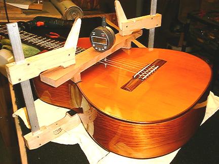

PostPosted: Fri Oct 02, 2009 1:26 am
Joined: Wed Sep 30, 2009 4:55 pm
Posts: 29
First name: David
Last Name: Hurd
City: Hilo
State: HI
Zip/Postal Code: 96720
I have to say that this "new" StewMac setup looks remarkably like a portion of the gear that I suggested to them 3-4 years ago for doing top compliance measurements...
aloha,
Dave Hurd
http://www.ukuleles.com
David C. Hurd
Alice laughed: "There's no use trying," she said; "one can't believe impossible things." "I daresay you haven't had much practice," said the Queen. Through the Looking Glass by L. Carroll
"Since my house has burned down, I have a much better view of the moon"
PostPosted: Fri Oct 02, 2009 3:22 am
Joined: Thu Jan 29, 2009 9:09 pm
Posts: 275
Location: Ireland
First name: tomas
Last Name: gilgunn
City: sligo
Country: ireland
Thanks for showing the pic Dave
new their must be someone with a home made jig like this
looks like you can use it for loads of things that i didnt think of
anyone know where would you get the likes of that guage from
thanks again
