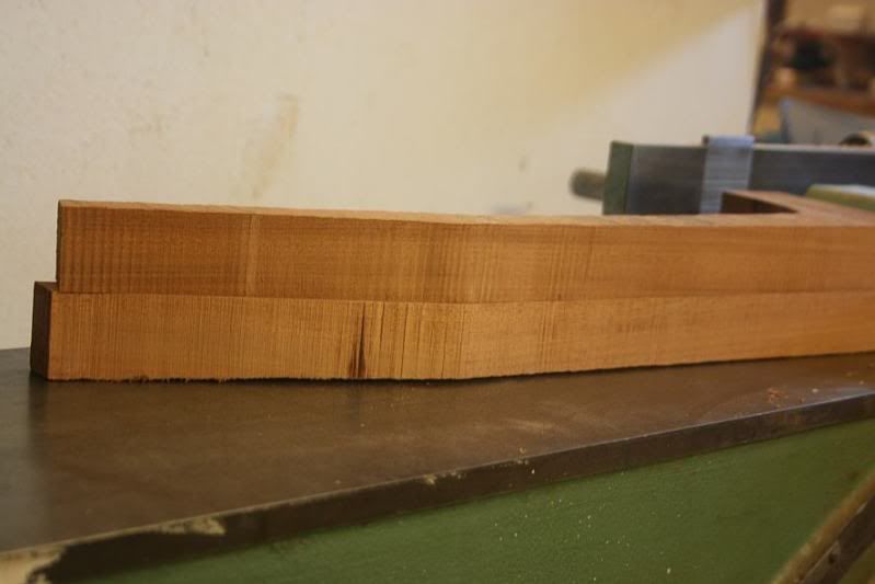

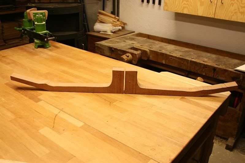

I wrote up how I make my two piece laminated necks a while back in a "build thread on another forum", let's see if I can cut and paste it in here (sorry if the pictures take up a bit of space, but they are linked in so they won't show up compressed like pictures that are uploaded to the OLF)

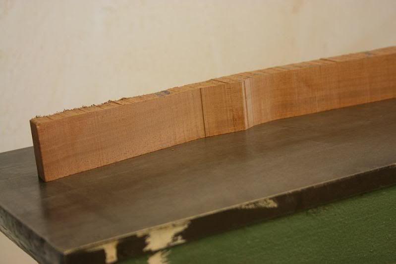

I buy large boards of mahogany at the local lumberyard, which I cut several blanks from. Or should I say, used to buy, the good stuff is all gone now and they won't be restocking they tell me. I'm glad I hoarded while I could! Here are some of the mahogany boards that I make necks from.

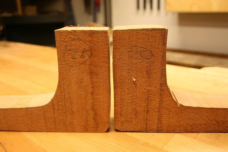

The board that these blanks were cut from was approximately 40 mm thick and prefectly flat sawn, so when cut like this they will make a fine quarter sawn neck. To match the grain in the neighbouring pieces, I lay my neck cutting template on the board in a mirrored pattern, just like they are oriented in the picture. The grain, when the pieces are glued up, will then be ))((, and the theory is that the equal but opposing grain will help stabilize any movement in the wood.
The neck is now “quartersawn” and as the pieces are “slip matched” (?), the grain in the two parts is quite similar; looks nice, and makes sense structurally.

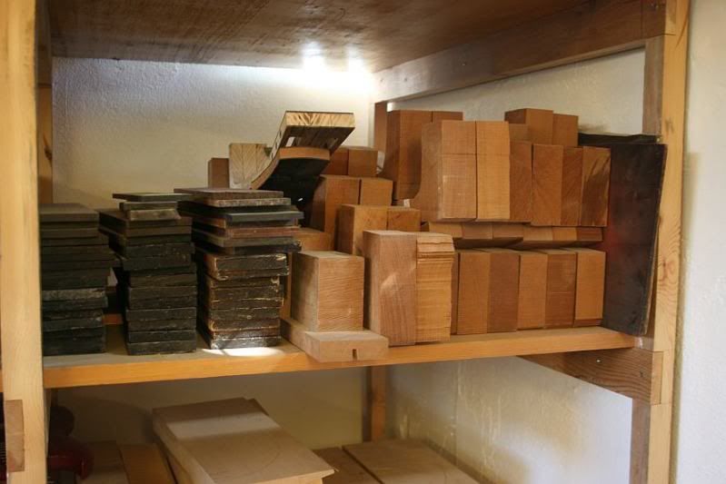

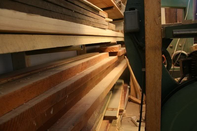

I code them before they are cut from the boards, and tape up the matched pairs and store them on the neck shelf until I need them.
I label each blank and tape them up in pairs before they are stored on the shelf, some of them for years.

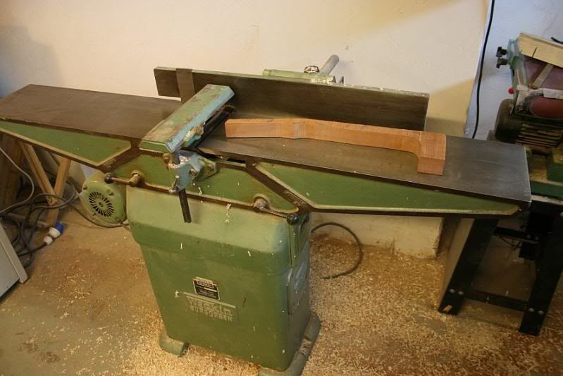

So, the first thing that happens to the neck blanks after being taken out of storage, is a trip over to mr. Wadkin Bursgreen

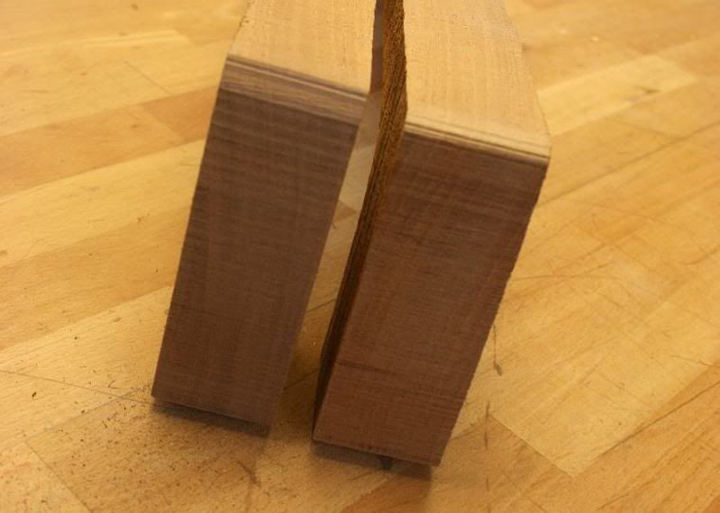

So, I get a nice and straight gluing surface real quick. This jointer bed is also a convenient shop reference for straightness.
And the other one...

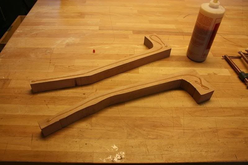

I use fish glue to glue up neck laminates. The fingerboard will be glued with epoxy, which releases at a much lower temperature than the fish glue, which is convenient should it become necessary to remove it for repairs some time in the future. It also has wonderful initial tack, so no slipping around as I put the clamps on.

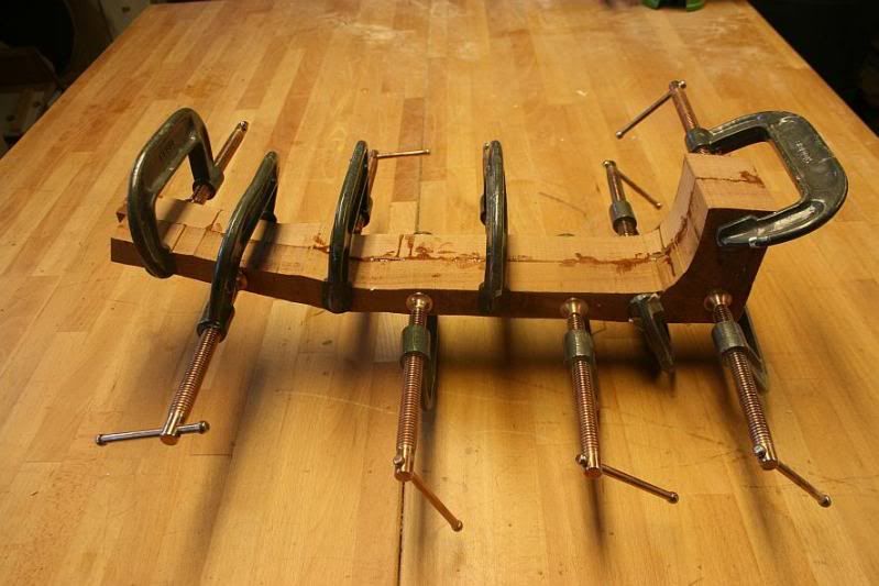

And here it is, all clamped up.
