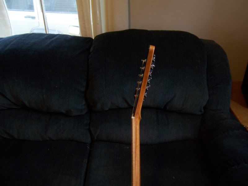

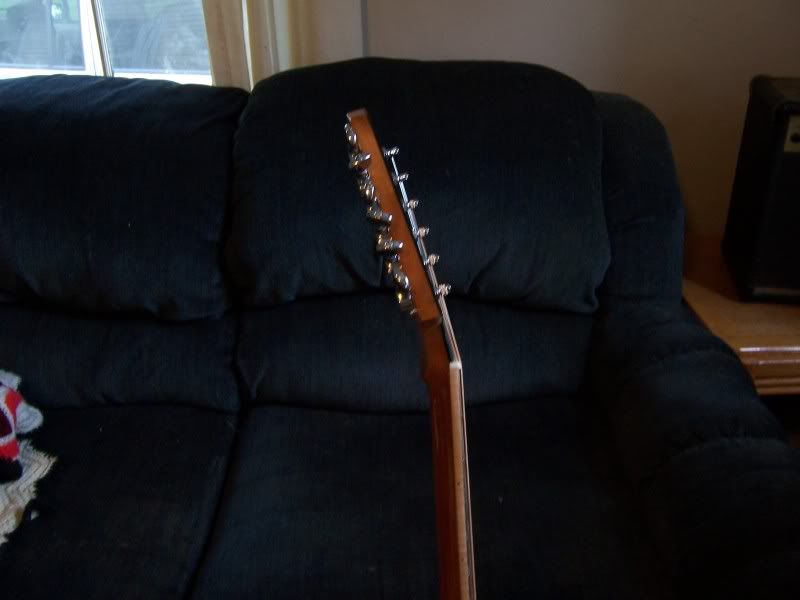

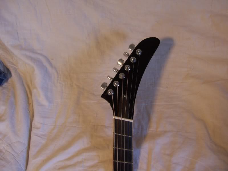

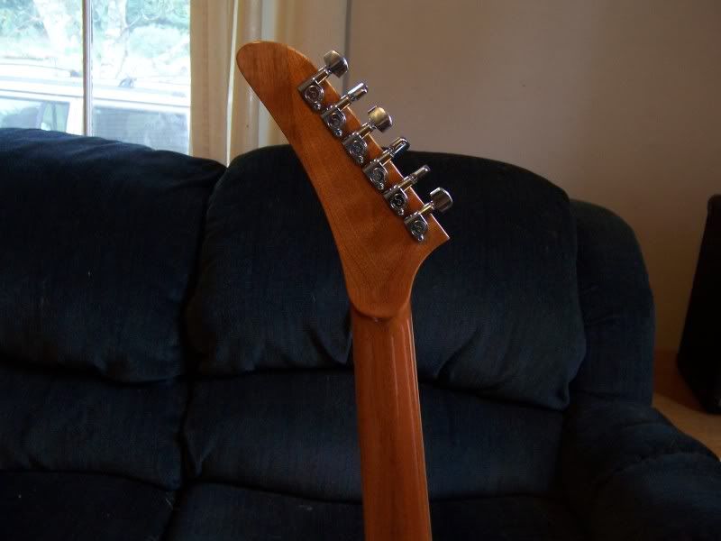

PostPosted: Fri Sep 11, 2009 5:30 pm
Joined: Thu Jan 29, 2009 7:38 am
Posts: 30
I used the 15 degree angle. I'm running light gauge strings on it and it has not exploded or turned into a pretzel yet. I'm sure it would handle mediums just fine. This is an acoustic. Danny Ferrington did a couple of these a while ago. You can see pics in his book.
I kept the string spacing rather Gibsonish. Half of the strings are pulling the nut one way and the other half are pulling the nut the other way. Just so that the string pull is not yanking the nut off of the neck one way or the other and you have to anchor it down with a couple of pins to keep it in place. But you can do that if you need to.
I glued on some wings to get the width. I'm sure that is totally illegal in some circles. I didn't do anything special with the valute.
This probably won't help you out to much with what you are doing but, it is what we did.
Glen
