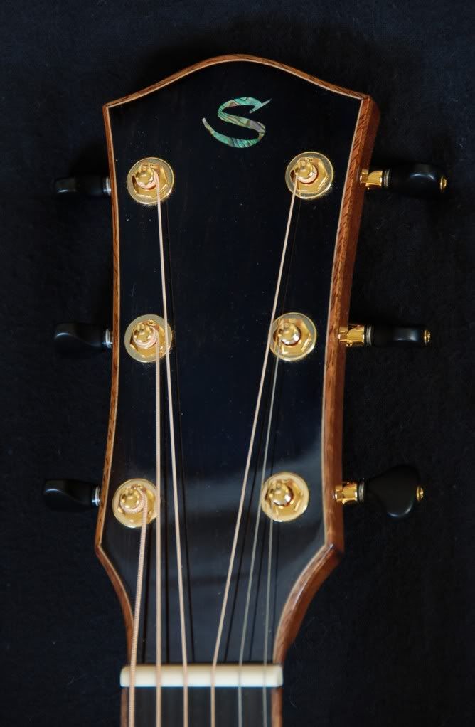

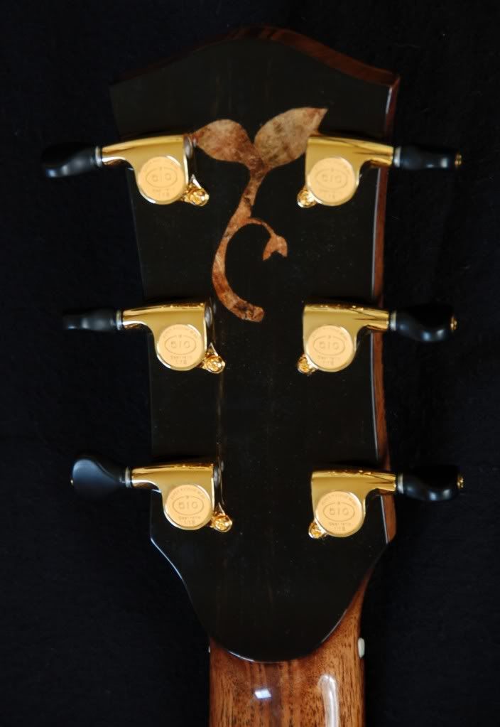

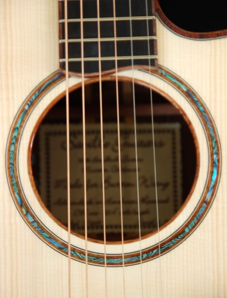

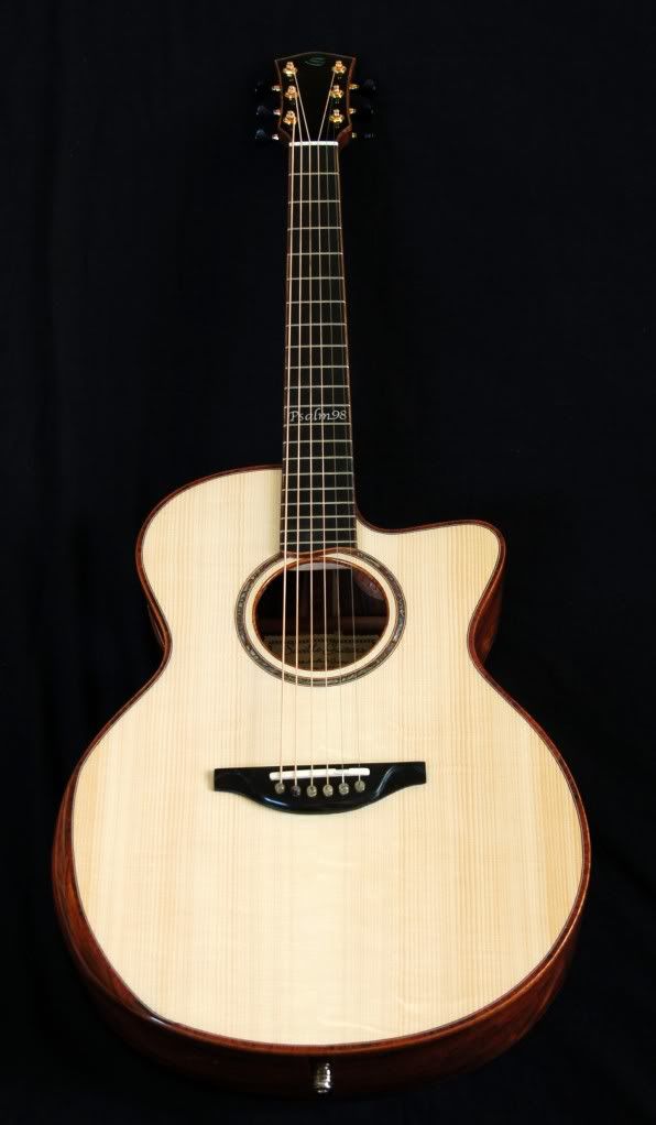

Another bitter sweet time has come. It is time to send this one off to the client.
Some specs -
OM 25.4 scale
Adi Top
Honduran rosewood back and sides
Koa bindings.
Laskin inspired radiused armrest.
A couple of goofy YouTubes......

Steve -
Very very nice. Elegant - and the sound is very rich as well.
Did you have any trouble with the knot on the waist? Asking because I've got some similar Rosewood and am wondering what (if any) treatment I'll have to give it before bending.
Thanks.
PostPosted: Wed Aug 26, 2009 9:54 am
That's AWESOME! [clap] [clap] [clap] [clap] [clap]
PostPosted: Wed Aug 26, 2009 10:26 am
Posts: 1969
Corky Long wrote:
.......Did you have any trouble with the knot on the waist? Asking because I've got some similar Rosewood and am wondering what (if any) treatment I'll have to give it before bending.....
The knot bent fine. I don't worry about having a knot because I build with double sides. I wouldn't use it if I didn't.

Looks great. The appointments all tie in together very well.
Finish?
Pat
PostPosted: Wed Aug 26, 2009 3:30 pm
Joined: Sun Jun 21, 2009 6:34 pm
Posts: 1058
Whoa! A looker for sure, sounds great too. Is that a tusq nut by any chance?
PostPosted: Wed Aug 26, 2009 3:45 pm
Posts: 1969
Edward Taylor wrote:
.....Is that a tusq nut by any chance?
No - It is bone.
Pat Foster wrote:
......Finish?
Pat
Cat urethane
