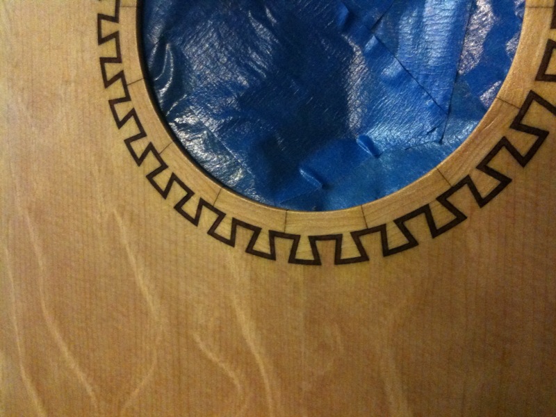

I use them to make an all-side-grain middle bit for the soundhole...
Cheers,
Dave F.
Cambrian Guitars
PostPosted: Thu Aug 13, 2009 6:44 am
Tasteful and cleverly executed Dave. [:Y:]
