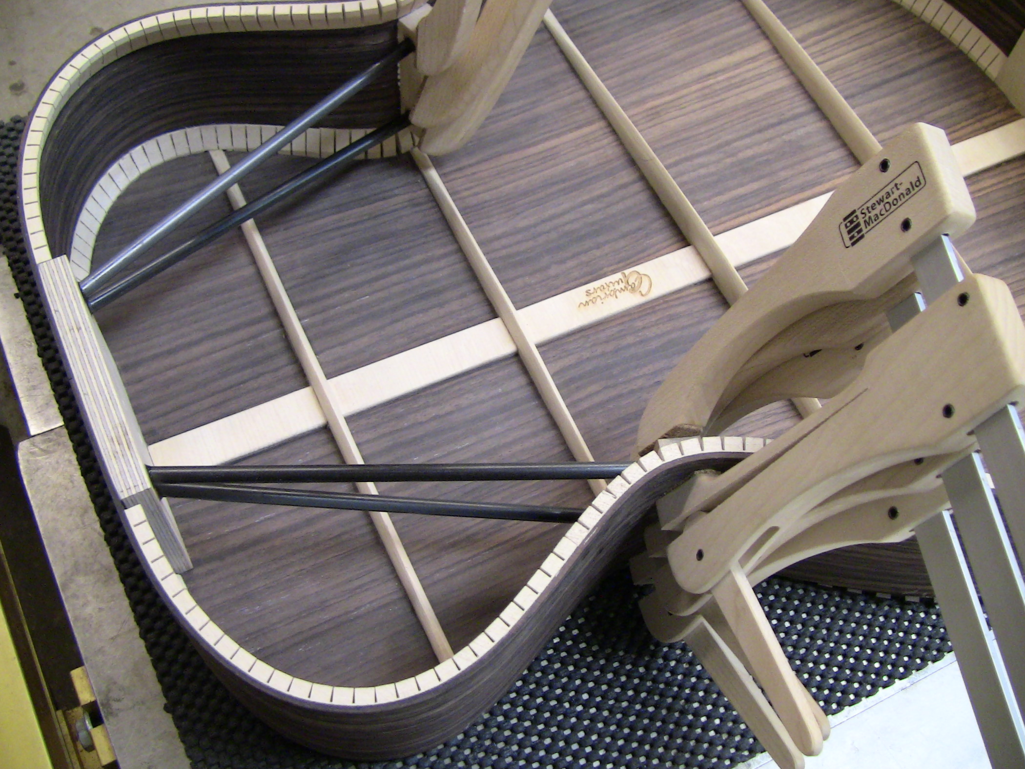

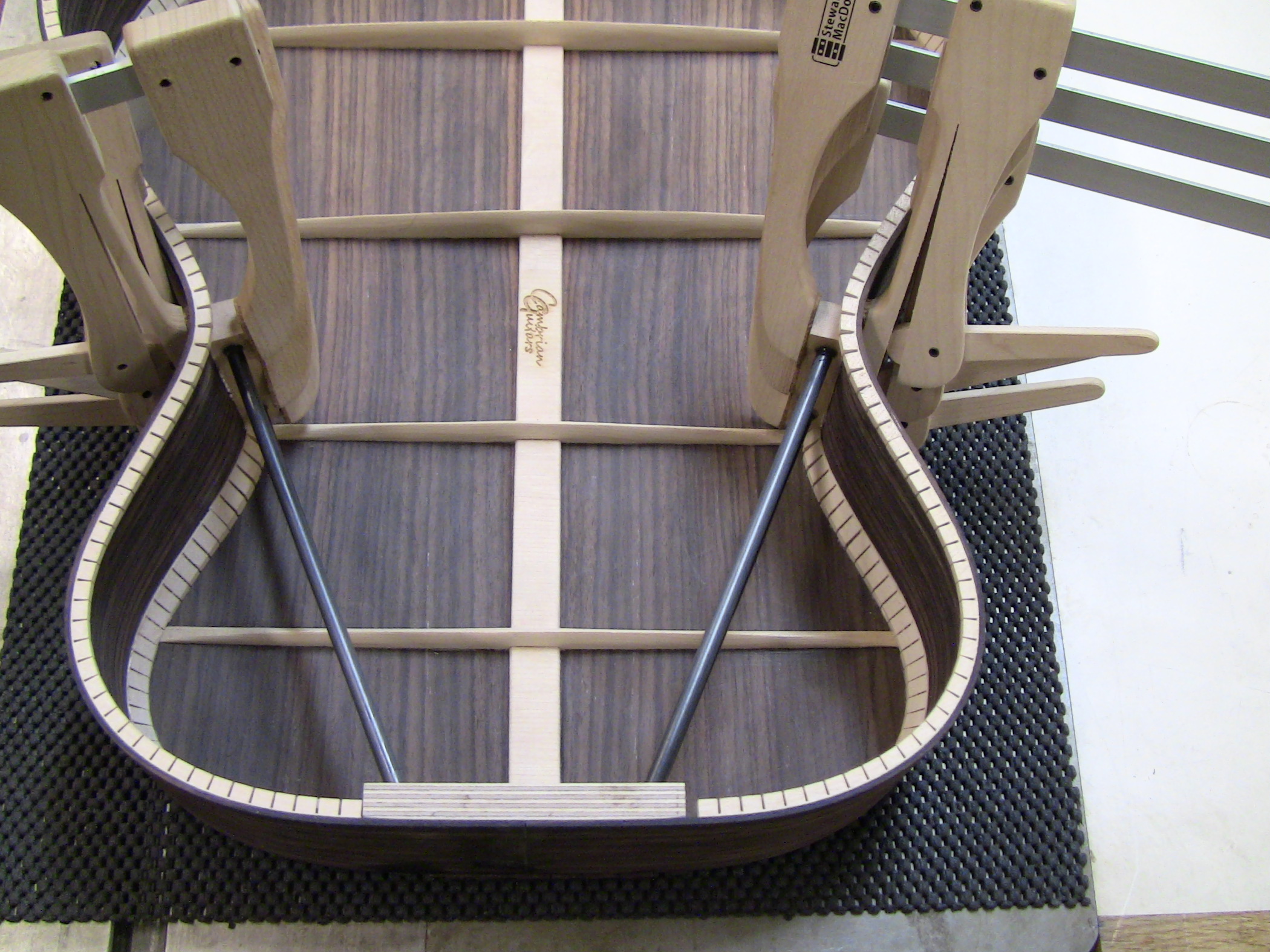

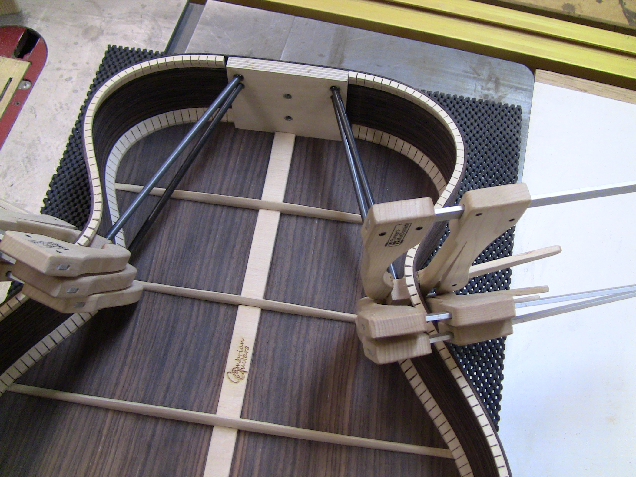

I've been stealthily working on a version of this idea for almost the past year! I'm almost ready to show my final prototype - I should have a nice playable MJ guitar built with it by the Guitar Festival in August - I'll bring it along with me for show/tell although I don't have a booth. Like others before me, I use carbon fiber tubes to transfer the string tension from the neck plate into the sides of the guitar at the waist and provide anti-twist properties to the neck plate. My neck plate is thin/small compared to traditional neck blocks. There is no external heel at all. Also, since my neck/fretboard floats over the soundboard, the upper bout now adds significantly to the sound of the guitar. The neck is "bolt-in" using two 1/4"-20 allen cap screws. The neck angle can fairly easily be changed to suit any player's desires. The design uses much less wood than a traditional mortice/tennon or dovetail neck joint, hence is much lighter. It's also easier/faster to make and less expensive on materials. My early prototypes sounded pretty good. Here's a few photos of the CF tubes and neck block during glue up. I'll post some more photos and perhaps a sound clip in a week or two. 8-)
You can click on the photos to see/download the hi-res versions of them.

Nice start to a guitar there Dave. I've used the small neck block with buttress rods in previous builds. I've been happy with the results. The two holes in your neck block have "bolts into the heel" written all over them. I look forward to seeing more pics when you can post them.

Mike - I took a look at Steve Klein's website but I can't see much evidence that he uses a heel-less neck - am I looking in the right place? In a couple of the photos, I could maybe convince myself that there's some neck shape change (to rectangular) just before it enters the body, but none of the pictures that I could find are clear on this. The couple of pictures showing the inside bracing show a fairly substantial neck block inside the instrument - nothing like I'm doing. I'm still fairly sure that my design (which you haven't seen yet) is "new".......we'll see..... :geek:
Steven - if you look closely at the two holes, you'll see they actually have 1/4"-20 threaded T-nuts installed in them. There are no holes in the outer shell of the guitar 8-) Eat Drink
