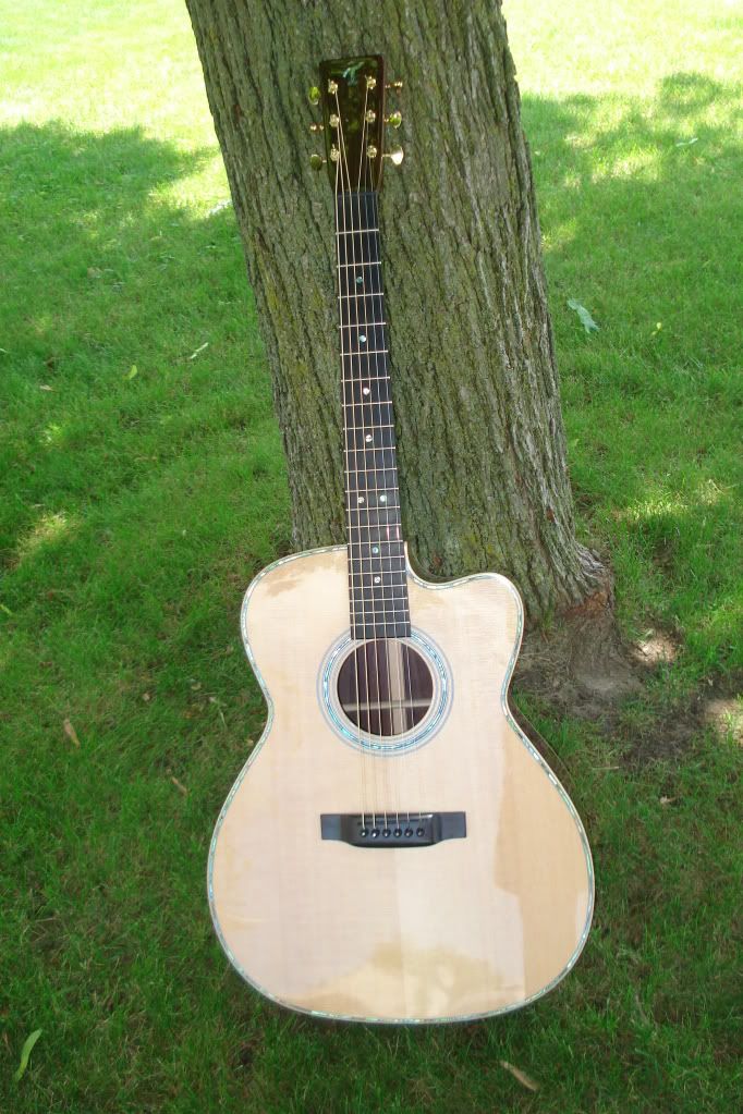

I strung up the wedge a week ago and finally got around to taking and posting photos. It is EIR back and sides, sitka top with paua abalone trim, and curly maple binding. Finished with Nitro over Z-poxy and shellac sealer. I displayed it along with several others at the local Folk Club concert last Friday and it was well received by everyone that played it and several came back for seconds.

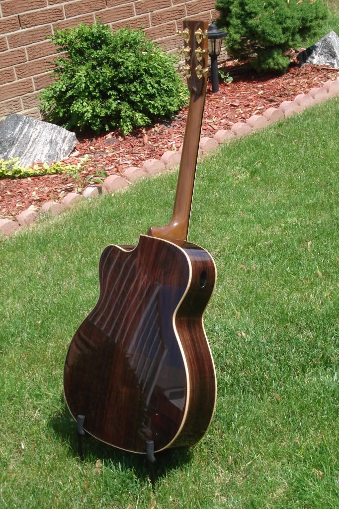

That is my porch railing reflecting on the back

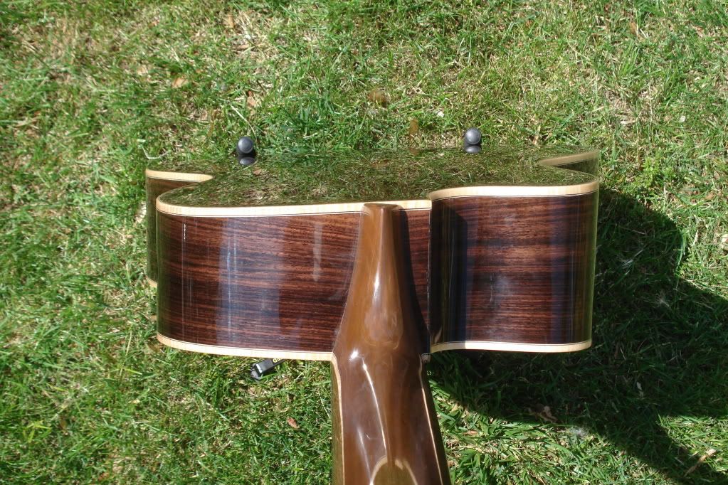

This isn't the greatest picture but shows the body wedge shape

Fred, this guitar looks tight, clean and beautiful. I really love the shape of the cutaway. Was this off of a plan or your own? Are you finding that your work is easier to keep tighter after 5 builds? Anyway, congratulations [clap] [clap] [clap] Wish I could hear what it sounds like. What's up for #6?

The outline of the box is based on the Martin Jumbo, and the cutaway is what I thought the Martin cutaway looked like, as I didn't have a drawing of it. My #3 guitar is the same except is not a wedge. Each guitar seems to get easier to get right and the hours get shorter as I get better tools and jigs. I will post a video on the photobucket when I get a chance to make one, though it would be better if I can get someone who plays better to play it, my playing skills are not the greatest.

Wow Fred, nice work. I'm half way through a OLF Small jumbo with a Manzer wedge. I'm using plastic bindings so I don't have to worry about the weird twists and turns on the back. Did you have trouble bending your binding to shape?

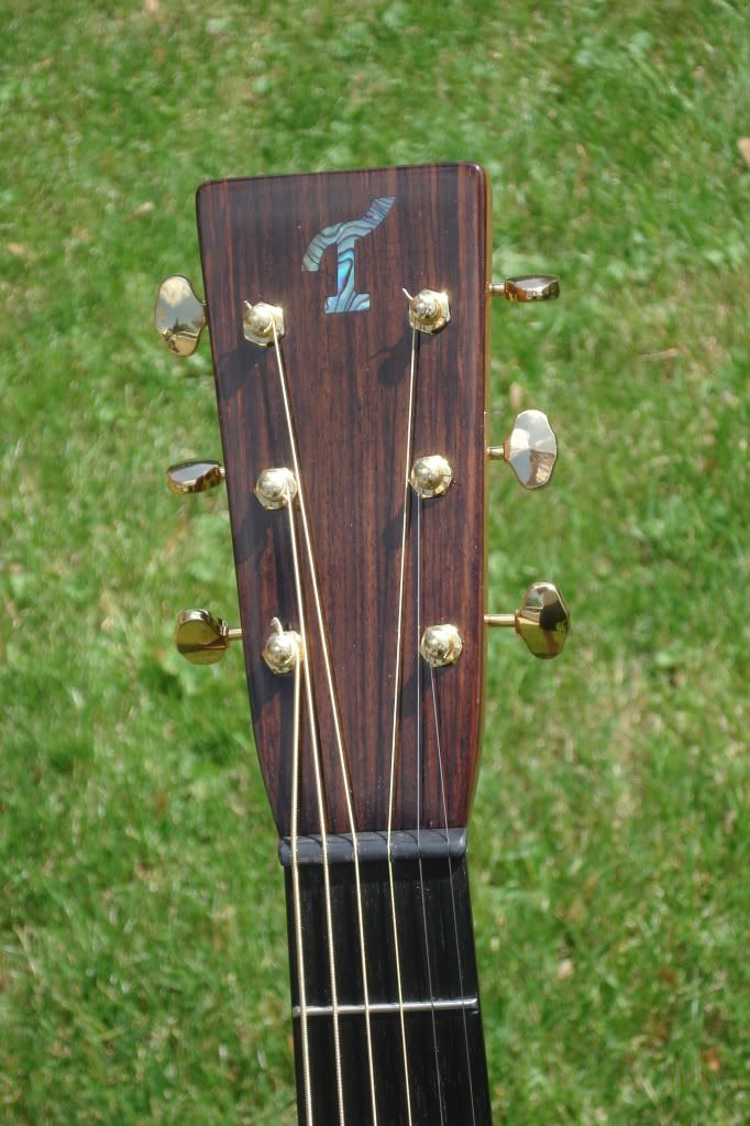

Have you thought about changing your headstock shape? There's nothing wrong with this one at all but your guitars are so good maybe a more original/individual headstock which is particular to you would be quite fitting.

Quote:
What is the nut made of?
It and the saddle are the Tusq brand string saver material, I played a very expensive guitar by Sheldon Schwartz that one of the guys at Michigan fingerstyle has and it had this material so I figured I would try it. I have 3 guitars with this material and it makes the many alternate tunings I use easier on strings and the sound is not affected at least to my ear and everyone who has played the guitars comments on the great tone. I had Bone on the Cocobolo 000 and switched to Tusq a couple weeks ago as I had already broken 2 G strings on it.
I just bent the maple to the outline and it twisted into shape without any trouble when I glued it on. The back shape is not that extreme though I had to modify my Stewmac True channel binding jig to get the guitar to sit square when I routed the top binding. The only real issue with the back was when clamping the neck dovetail I had to make a clamping spacer so the clamp wouldn't slide around.
The great thing with the wedge is the comfort in playing, my bad right shoulder is quite happy with it.

Great-looking guitar! What did you use as a pattern for your sides?
I made templates by propping the mold on my radius dish at the angles required for the back contour. I then measured down to the dish every inch and layed out the measurements on a piece of arborite. I had to add a little to each reading to get the actual side height needed as I only worried about the angles setting it up. The neck heel and but are the same as the Martin Jumbo and the lower bout measurement is 1" thinner on the base side. By using the templates to profile the sides before bending I had to do minimal dish sanding after the rim was glued up.
It only took an hour to get the sige shape platted out, once I figured out how I could do it. The wege feels so comfortable to play I am thinking of doing a wedge dreadnought next.

Fred, beautiful. I've been going to smaller bodied guitars for comfort. Do you really think Tusq is better than bone? I've been going the other way and I note that Taylor provides bone only for its high end instruments and uses Tusq for the rest????

[/quote]Do you really think Tusq is better than bone[/code]
I don't think it is better than bone, except for the fact that it is easier on strings when you are using lots of alternate tunings. That said I haven't noticed any real difference on the guitars that had bone then were switched to the Tusq black string savers.
