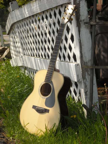

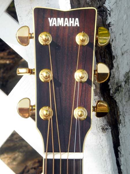

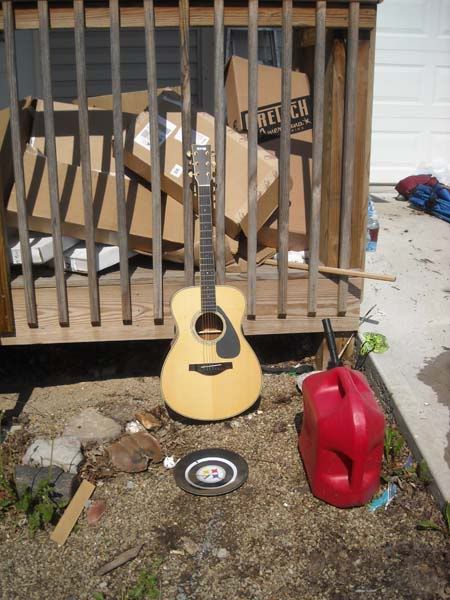

Lets turn Photo 1 into Photo 2
PHOTO 2
Camera; my kids Nikon L18 $100 camera; has some manual overrides and a zoom lens.
Outdoors Lighting; Bright sun 10am
I got a little artsy with a Poly finished Yamaha. Never set a French Polished guitar in the grass! Pick your spot for either simplicity or a compliment to the intent. Put a Jazz guitar on a brick wall at a railway station. Dream the photo. It can be like playing your first bar chord. PIA that is so satisfying.
I started with an average shot. Harsh light. Noon is the worst, we‘ll cover that in lesson 2 . Bright, direct sun is bad; Wide angle optics distort

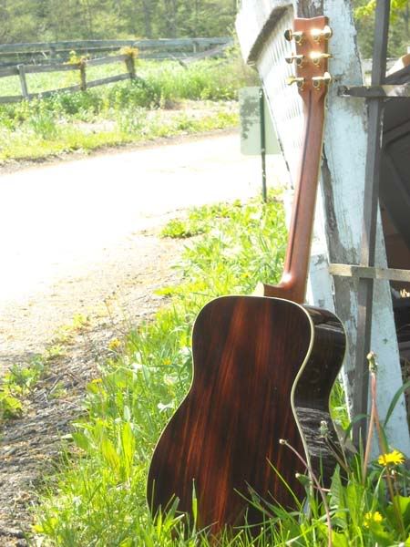

Backs are harder to shoot than fronts.
Image So what is working against these photos? Almost everything. The full front is distorted from being to close/using wide angle. The back, well, it’s a nice picture of …a field.
At least the light is low in the sky. Morning and dusk are your best friend. Note Mornings are blue in color tone., evenings yellow. Give me dusk on an overcast day as my favorite time to shoot. But you work with what you have. Today we have 10am EST spring.
Composition; Look at your whole scene. Did you see the garbage pale in photo2? If you did you get one "A ". Hey, a branch out of focus in the scene is art. A branch from a tree, right behind the guitar, is an antler. Dead on shots are generally a drag. It shows no depth, little of the character. Clients will ask for dead on, not on an angle. Not because they don’t want to see what is on the sides. It ’s just they subconsciously want a distortion free picture. Which I hope to teach you to create.

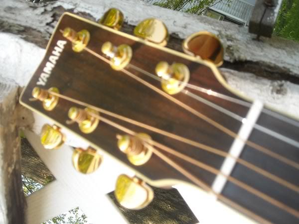

Angle is everything; Wide angle distorts. Wide angle close really distorts.
Try to remain parallel to your subject
BTW
You can do just as much damage to the image aiming up

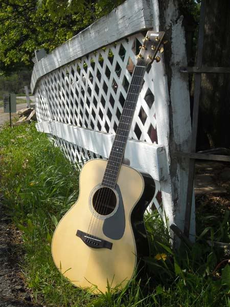

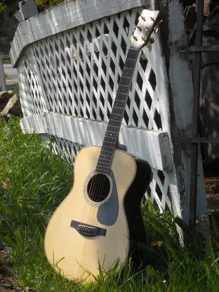

Lets get started. Get as far away from your subject as you can. Use your optical telephoto.
NEVER use the camera as it turns on. Your camera was not built for product photography. It was built for round faces 15 feet away. With a few easy tricks we can make the camera do a great job. So, BACK UP. Get away from your subject. Now use your OPTICAL zoom to maximum to fill your frame. Part cut off? Back up more. Want to fill the frame more then move closer. Leave the zoom on max. Did I mention to not use the digital zoom. Digital zoom does not produce clear results. NEVER use the digital zoom. Also, if you have a tripod use it.
Here we have a nicer picture. Note the fence.
Look at the same photo shot on wide angle much closer to the guitar, can you see the distortions;

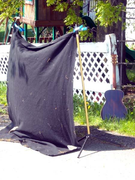

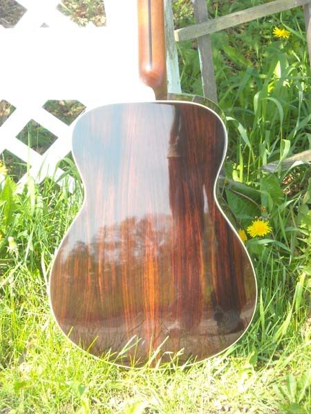

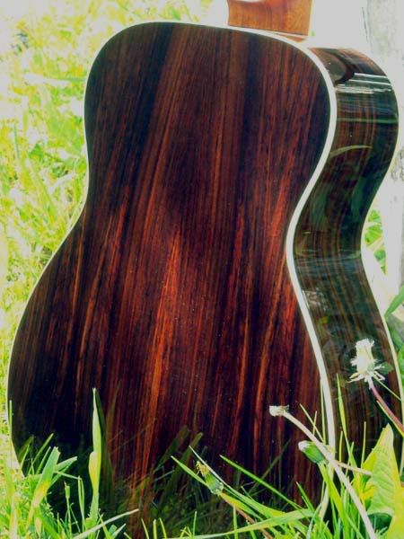

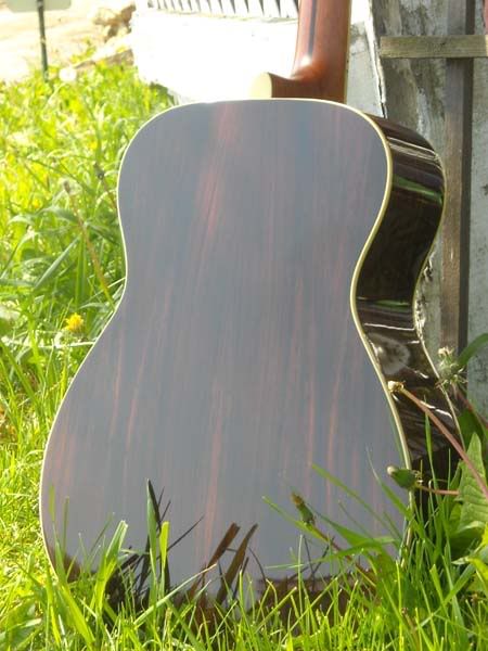

Next lets GET RID OF THE GLARE. Since the dark of the back shows the uneven light better lets turn it around.
Worst best solution. Aim the guitar into the cloudless sky.
Best; get some wide felt and block the direct sun.
Did you see the cans again? We'll do much more on picking spots to shoot pictures.
You can also use white sheets to diffuse the sun. That works fantastic with sunbursts and Mahogany/dark tops. Black gloss tops are a WHOLE other lesson. Note; pink sheets, blue sheets, paisley …… NO

A question. You show 2 pics of the guitar leaning against the fence and state to look at the fence. One pic is taken from further away (zoomed in) and the other is taken nearer with the camera paned out (not sure the proper term). The fence looks more distorted in the second picture than in the first.....and If I read correctly, the second pic is the one taken closer to the subject. What am I missing?
Hi Darryl, What you are missing is the fence is screwed and ready to fall over lol. I see your confusion, I looked and the image 2 looks like a sturdier fence because of the distortion! Look at the rock pile in the background. See how it looks much furthwer away in photo 2 than photo1. Look at the shoulders of the guitar how different they look. On an unfamiliar guitar you may not notice, one you spent a 100 hours building will just look well, a little wrong.
The telephoto compacts the image, a wide angle expands.

OK, that makes sense. Thanks for the response.
I have another question if it's not too much trouble. When photographing the back you said to block the direct sunlight. A subsequent picture show the black cloth drapped to form the block; however, I see that the shadow from the black cloth does not cover the guitar back. How is the direct sunlight being blocked if the subject is not within the shadow of the cloth? I sure appreciate this post.....and as you can see from my questions, I've a lot to learn.
Darryl... the black cloth is not blocking any light, it's what is being reflected in the guitar's back. The reflected black cloth "disappears" leaving the wood fully lit, with no glare.
Great post! John.
Ya beat me. Like I said in the OP "Ramblings" Ya do something 5000 times you forget how and what your doing and saying, ya just do it. As it was I reread rewrote for over an hour trying to convay properly. All that said; yep, I will go back to the op and make it more clear as I worded it down right wrong. So, thanks again Darryl. You will make me a better teacher.
Hmm I guess you can't edit after replies? Makes sense. I would have changed i to say "Block the reflection."
I will do a part on diffused light through a sheet.
