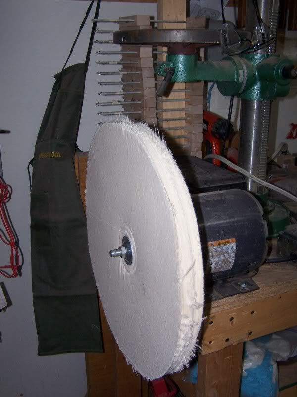

Pat, heres what I did,
I ordered a buffer only to get an email that it was back ordered !! So I built one,
I used a 3/4 hp swamp cooler motor with an arbor attachment from harbor freight.
It's a two speed motor, 1100 / 1750 rpm, I wired it up just like the cooler would be for two speed control, I purchased two 17" buffing pad from Grizzly and stacked them together for a wider buffing surface. I have it mounted on the edge of one of my benches,
The thing works perfectly !!

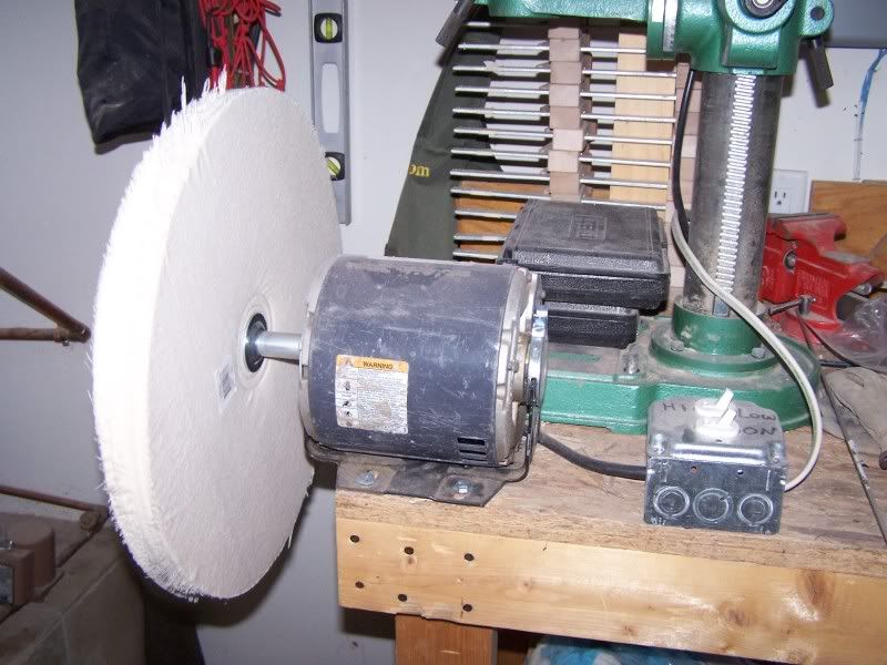

My home made buffer
On the right bolted to the bench is the switch box, High / Low On / Off
Works great !!

Pat,
A swamp cooler is an evaportive cooler, they are very common where I live. I'm sure you can find something like this, however I bet it will set you back a few $$$. If you purchase a motor specifically for a cooler they seem to be more affordable, here in Abq wal-mart has them for $70, the two speeds and the associated rpm's were perfect !!
These motors come in two hp ratings, 1/2 & 3/4, I didn't think the 1/2 would be enough so I used the 3/4 hp.
If my memory serves me correctly both hp rated motors have a 1/2 shaft, The arbor attachment can be purchased on ebay, here's one
http://cgi.ebay.com/Convertible-Motor-A ... .m14.l1262
You should be able to order a cooler motor from Lowes or Home Depot from there web site.
Lowes & Home Depot will start to stock these motors right now, summer is just around the corner.
The on / off switch is just a metal junction box from Lowes with a two speed cooler switch, the guy at lowes will get you set up.
Make sure once you have the arbor attachment in hand you check the diameter of the threaded shaft that the buffing wheel will mount on and get the correct size hole in your buffing wheel.
I already had the motor, I had to buy the arbor, motor mount, switch & box & buffing wheel....$40 total, add $70 or so for the motor.
