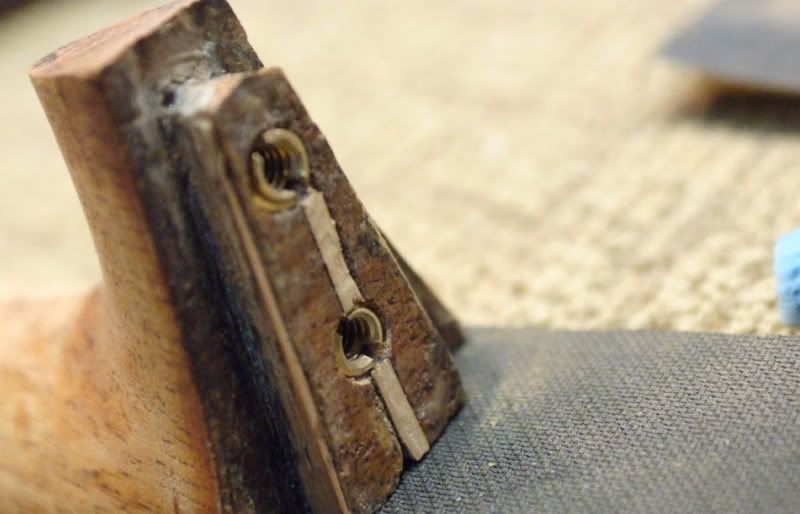

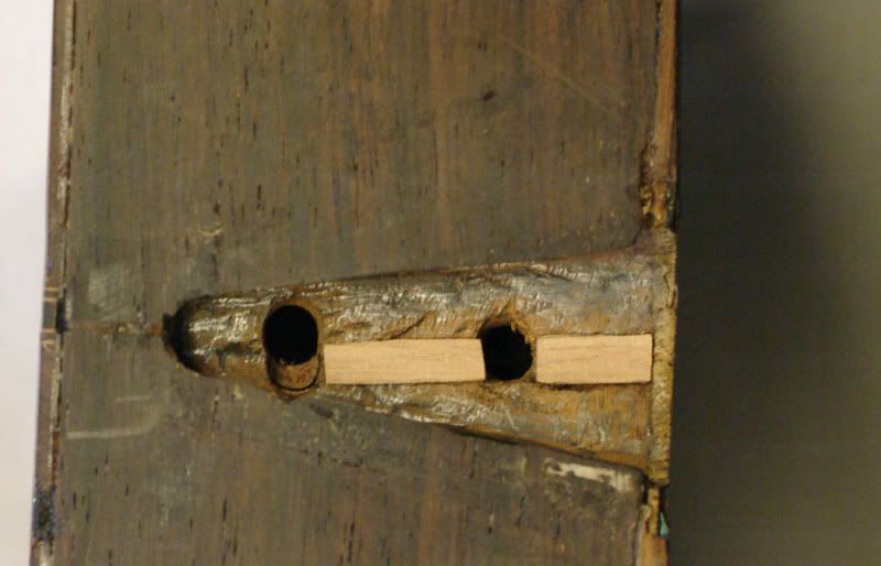

Hi Jorden,
Thanks for your reply. It had a Dovetail that had been beat pretty bad in a previous restoration attempt. Likely before we were born.
So I restored the fit with Mahogany inserts and at the same time made a bolt on.
I did fill in the drill wounds by the way.
The fit is nice and tight. I think straight! without bolting :)

Not sure if it is just for show... but you need washers with
those hex head bolts. You don't want the hex heads to eat into the
neck block while tightening.
Another option is the socket head furniture bolts -- they have a large, round bearing surface
that won't dig in.
Something else... for a "Restoration" -- maybe plan for a little cover or label or something to hide the
bolts. The bright, shiny hex bolts kinda stand out a bit...

Thanks. It has been a great learning experience. Here is the neck with the wound repair
It is stunning Brazilian Rosewood :)
