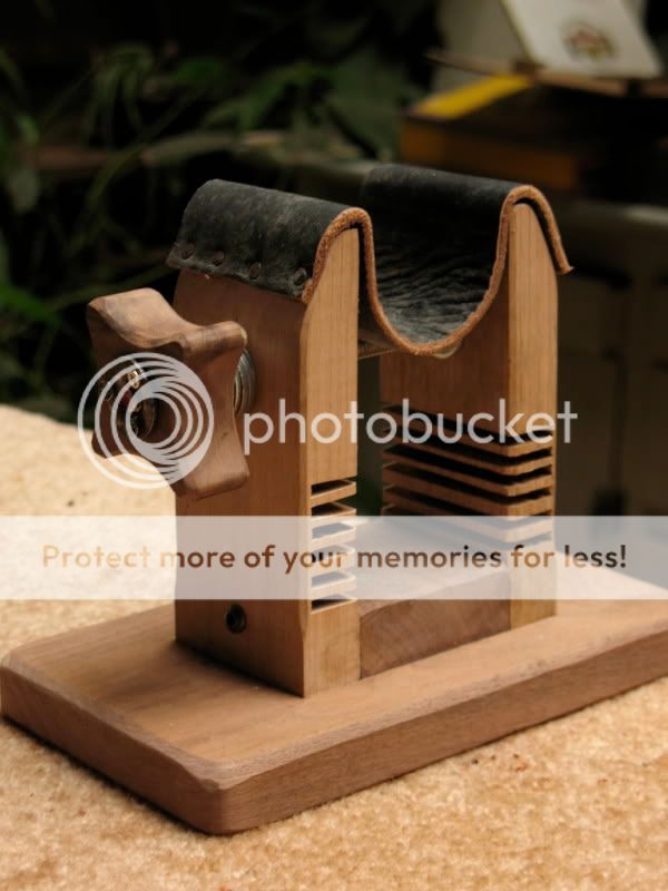

Thought I'd show my copy.
Maple jaws, walnut for the rest, and leather sling. I added a couple of more kerfs for a greater range. Nice addition to the shop.
Thanks Rod,
Joe
