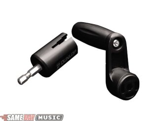

Dunlop Turbo Tune String Winder, handle has a pin puller too. Use a cordless screwdriver and you are uptown, I'm told. Got this today. $7

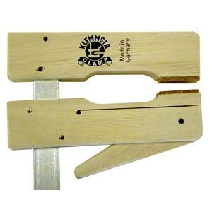

The German Klemmsia Cam Clamp. Another one of the best techniques of gluing wood ever found.

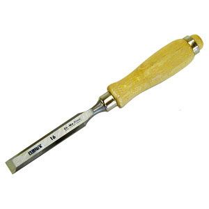

Highland Woodworking’s Narex Chisels Earns Best Value Chisel in Fine Woodworking’s Evaluation, I found this article looking for a pic of one of my chisels. $8 for the 16mm, you can get a set of 4 at $27, read this review I found: http://www.prlog.org/10097575-highland-woodworkings-narex-chisels-earns-best-value-chisel-in-fine-woodworkings-evaluation.html I just know I enjoy it and it works well, and holds an edge. I was demonstrating stropping with rouge to a bunch of 5th Graders recently and cut myself on a back stroke. Blood always enlivens any demonstration.
