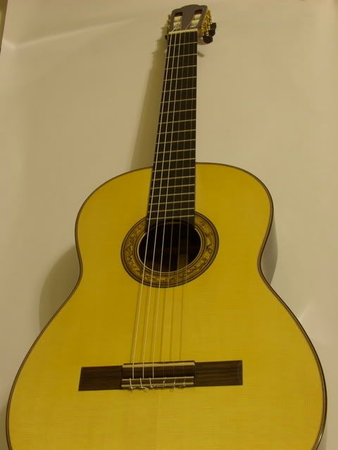

Hi. As much as I hate it (it sounds kind of creepy) I guess you could call me a lurker. I've been a member here for a while but haven't really posted anything. I finally finished my third and thought i'd post a few pics. This was also my first bridge removal-tons of fun. When gluing the the first bridge I was a bit too concerned with clean-up and forgot to tighten one of the screws on my caul that applies pressure to the wing of the bridge. I didn't notice until I had things all nice and tidy but by that time the glue's open time had passed. I could squeeze a piece of paper about 1.5mm under one corner of the bridge so, needless to say, it had to be removed. I used the heat lamp method that I'd seen posted here in the past (sorry, I can't recall by who). Apart from a couple of minor dents that steamed right out and some minor damage to my french polish that I had to fix, it went quite well. Overall, I'm fairly pleased with the way it came out and it sounds great.
As for the guitar:
Scale: 650mm
B/S: EIRW
Top: Engelmann
Purfling: maple, bloodwood, black veneer
Binding: EIRW
Rosette: 8pc bookmatched spalted maple
Finish: FP
I hope I posted the images correctly (not sure).
-William

Very NICE! Love the rosette!

Hi William - Your guitar (and pictures) look great!!! You should be very, very proud! [:Y:] [clap] [clap] [clap] [clap] [clap] [clap]

Wow, very impressive! I'm working on my 3rd guitar too, but it is my 6th instrument to complete. Should have it done in a few months. I really like your rosette, and it looks as good as any one's 10th or 50th guitar. Kudos!

I REALLY like your purfling detail on the heel. Beautiful work.

Very nice William,
Like Mr. Boone said, beautiful work on the purfling.
Must be a thing with the nylon string crowd, Alexandru just posted a beauty of a 3rd guitar also.

Looks awesome, and definitely cleaner work than on my third! pfft
What size and bracing did you use? Hauser?
It's a smallish classical. The plantilla I came up with prior to my first build. I more or less laid a D. Friederich plantilla on top of a Romanillos plantilla and split the difference. The lower bout is also cranked slightly ala Bogdonavich (I think Romanillos might do this, too but i'm not sure). The measurements are:
Lower Bout: 361 mm Upper Bout: 274 mm Length: 484 mm Depth @ heel: 86 mm Depth @ end block: 88 mm Deepest point is around the waist(maybe just south) @ about 95 mm.
The bracing pattern is also my own take on a traditional fan braced guitar. It is a symmetrical design but the treble side braces are a bit more massive. It appears fairly close to a Romanillos but I don't use an open lower harmonic bar. In fact, I use a hardwood (spanish cedar) lower harmonic similar to Greg Byers. I'm quite happy with the results.

Heath Blair wrote:
excellent looking guitar bro. i dig your taste in appointments. as mentioned, im especially fond of the heel cap purfling. nicely done.
The purfling and binding around the heel turned out nice but will not be a feature on any of my instruments in the near future, at least not on a rounded heel. I've always been fond of the bound heel but there's a reason you mostly see those on instruments whose heel comes to a point: you can miter those. Bending wood, even very thin wood, into such a tight radius doesn't work very well as I now know all-to-well. It took me about five tries to get it right and took way longer than I anticipated.
