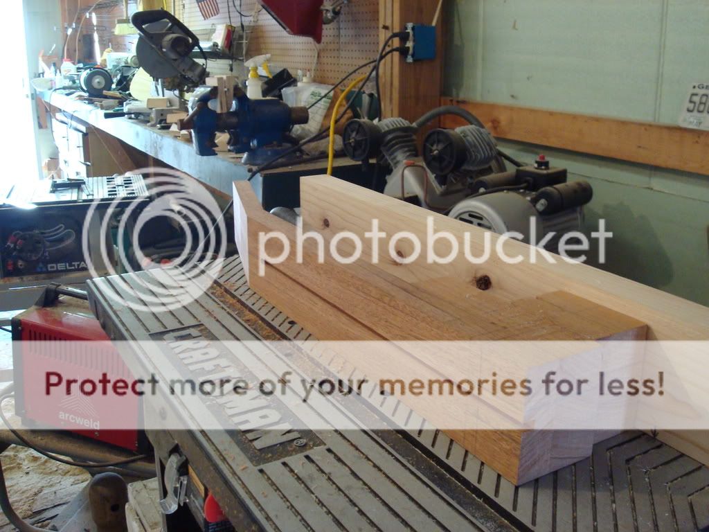

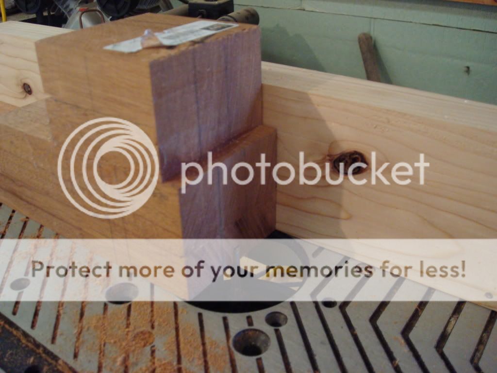

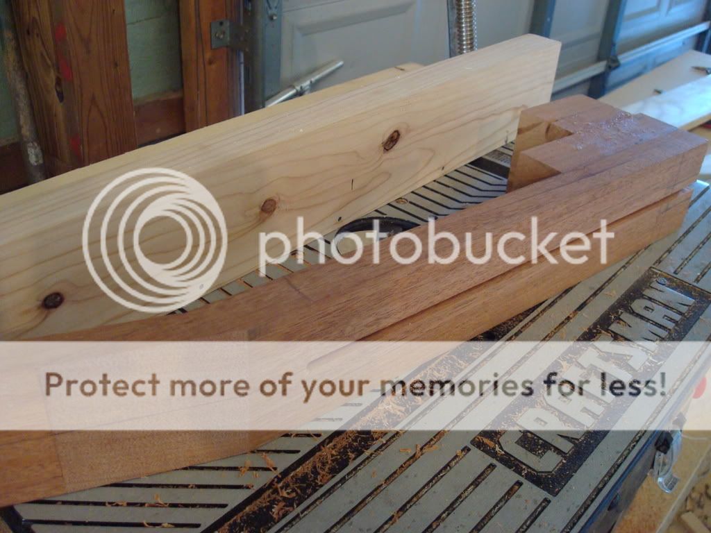

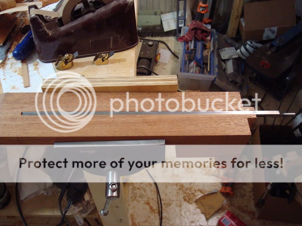

Howdy David,
I just have a router mounted in a router table. Using a 1/4" carbide bit I set the depth and distance from the fence using a scrap piece of wood. For the fence, I used a 2 X 4 and ran it through the jointer to square it up making it level, plumb, square and straight, clamp it where you need it to be on the router table. I then make a pencil mark on the neck and one on the fence where I want to stop routing. Pretty simple really.
Here's a couple pictures:

Chuck, looks good. Any reason you leave the channel short and so much of the rod sticking out? For the truss rod to work properly, both ends need to register off the bottom of the channel and can't hang out there in mid air. Maybe this is just for demonstration purposes.
I use a router table with fence and a 1/4" up cut bit. I make one shallow pass (like 0.010") to kiss the surface to eliminate tear out. Than I go full depth of cut. I also clamp a feather board on the router table to keep the neck blank solid along the fence. I cut the channel through both ends of the neck as I adjust my truss rods at the headstock.
